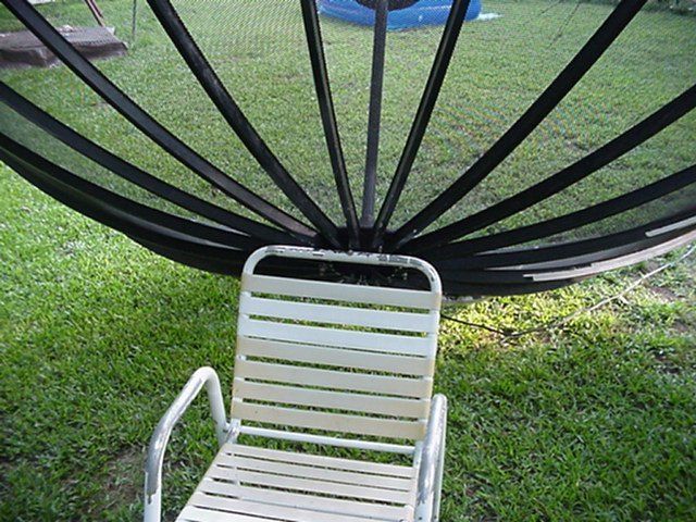

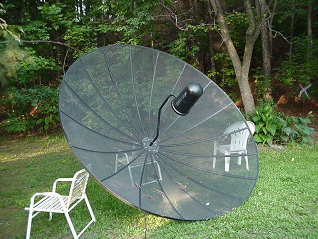

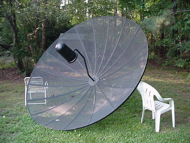

Here is what I did today with lawn chairs.Whatever works.

Hahaha... Nice temporary setup.. What are your plans for that dish..
No that's permanent.And when I want to move to IA5 I send my four year old Son out to push it to the left.He enjoys the adventure.:D
