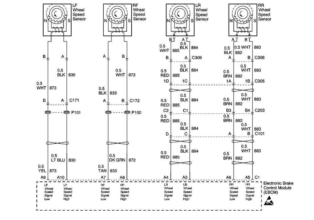

As you can see (I already knew this from twisting wrenches for a living) the VSS pickups are inductive. Not so great for a magnet creeping by but OK if it zips past the sensor.
A better choice would be a crankshaft sensor. It is a Hall sensor.
A reed switch is going to trip if the magnetic field is strong enough and is the right polarity (depending on the type).
A reluctor will generate a voltage as a magnet passes by the field piece. That's why it needs a magnet zipping by it.
To generate a clean, high enough voltage to trip the device at the other end the trigger has to have sufficient velocity. I'm not so sure your motor controller would be too happy for long getting a voltage pulse if it expects a switch closure.
A hall sensor on the other hand acts like a snap action switch IF it is of the Schmitt trigger type versus proximity type.
