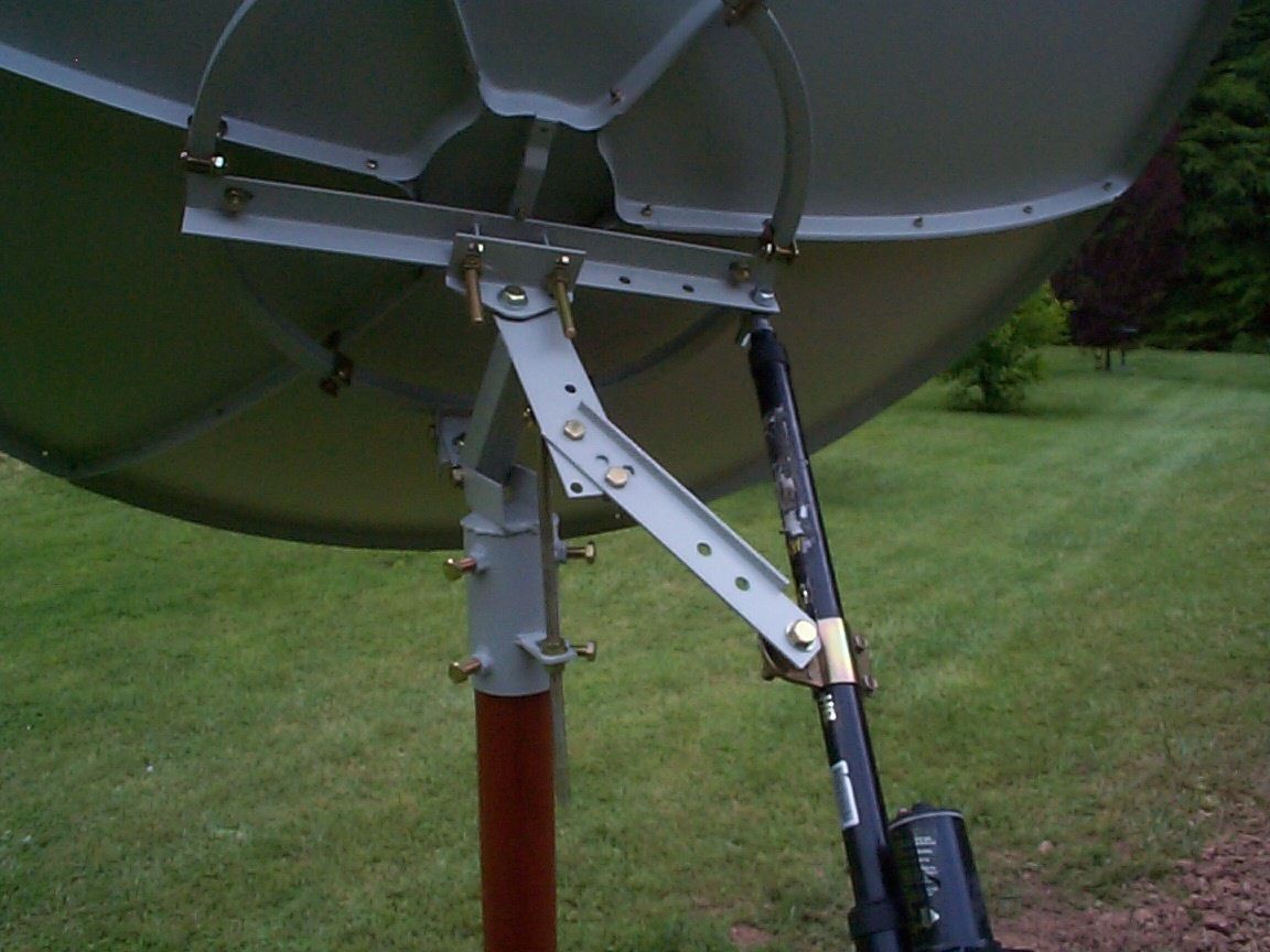

This is what the polar mount looks like for this dish:
No thats not my pretty lawn, its a picture I found on the web for reference when I assembled mine. I can take more pictures of my own dish if needed.

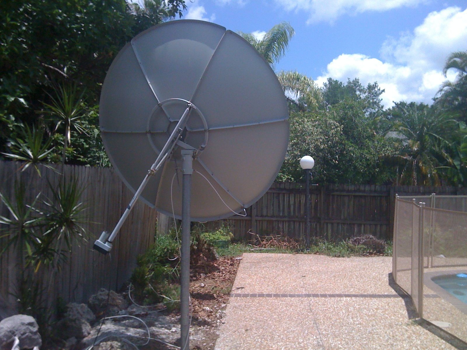

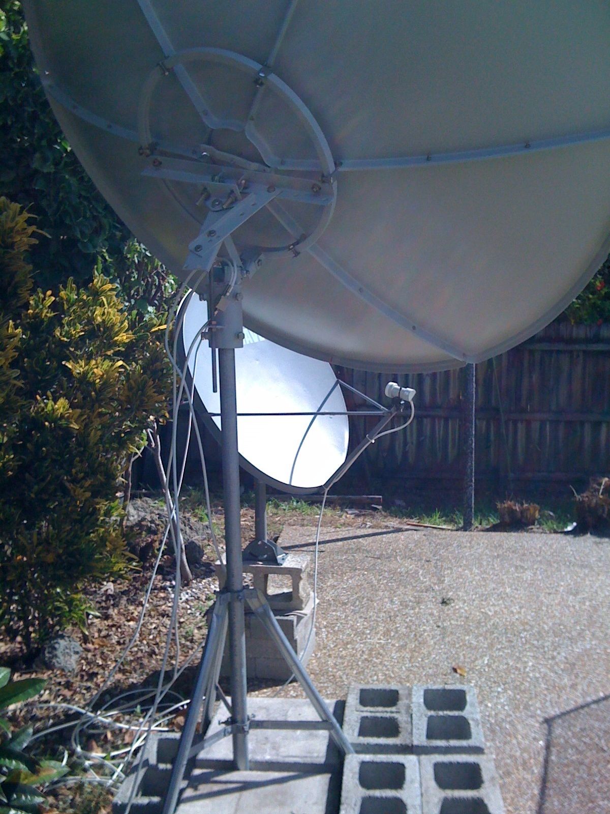

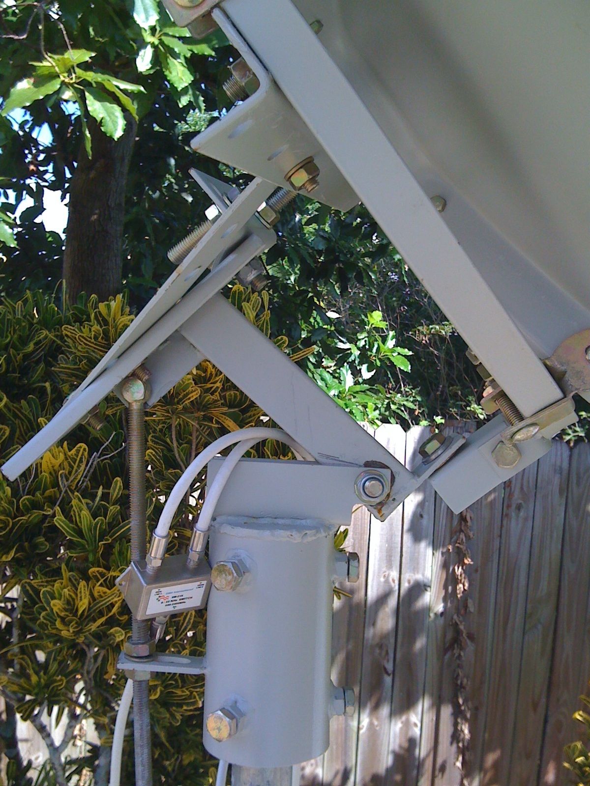

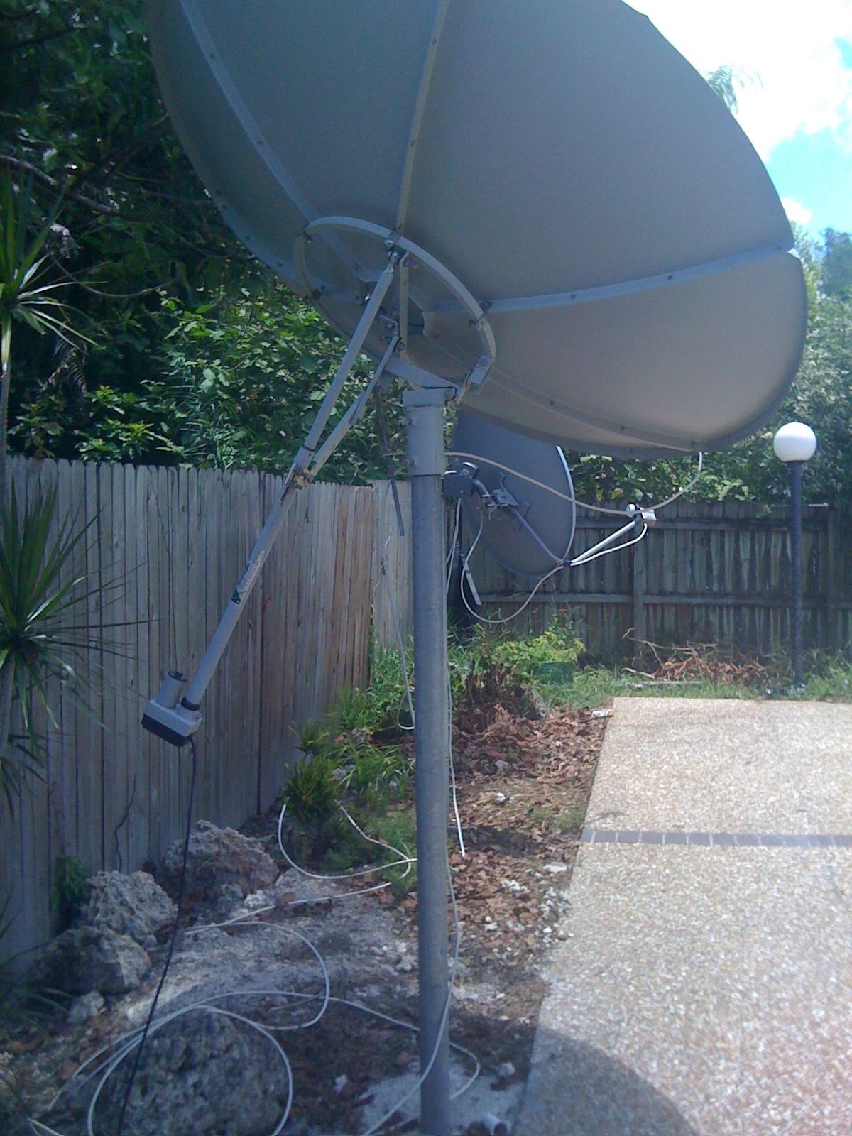

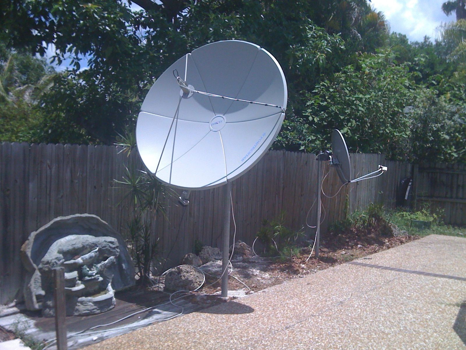

I had a previous 6 footer back in 2011 when I bought a Fortec from Sadoun for $360. Attached is pics from my previous 6 foot dish. My cable run was 150 ft. Attached is old pics of my previous setup until I moved due to a divorce, to show the polar mount. I prefer a 6 footer here in Florida. If the weather gets bad it is very easy to detach from the pole. I did not hestitate to buy another one again. From time to time polar mounts are available on Ebay for approx $35. I m hoping to get lucky.
I still have the 8 footer mesh I bought two months back from Tek2000 still in the box. A 6 footer weights only 50 lbs versus an 8 footer at 100+ lbs.
I received most sats including the circular polarized sats by using the insert in my NS741 C/Ku lnb. I get roughly 90 % of the sats from 15-135W. Im using an Amiko 3 has a very sensitive receiver and good for blind scanning. I need to pull my Azbox Premium Plus from the closet to check 4:2:2 signals. In the past higher FEC like 7/8 was difficult on a 6 footer. However since most broadcasters that was using this error correction switched to DVB-S2 or Mpeg4, I receive them well.
