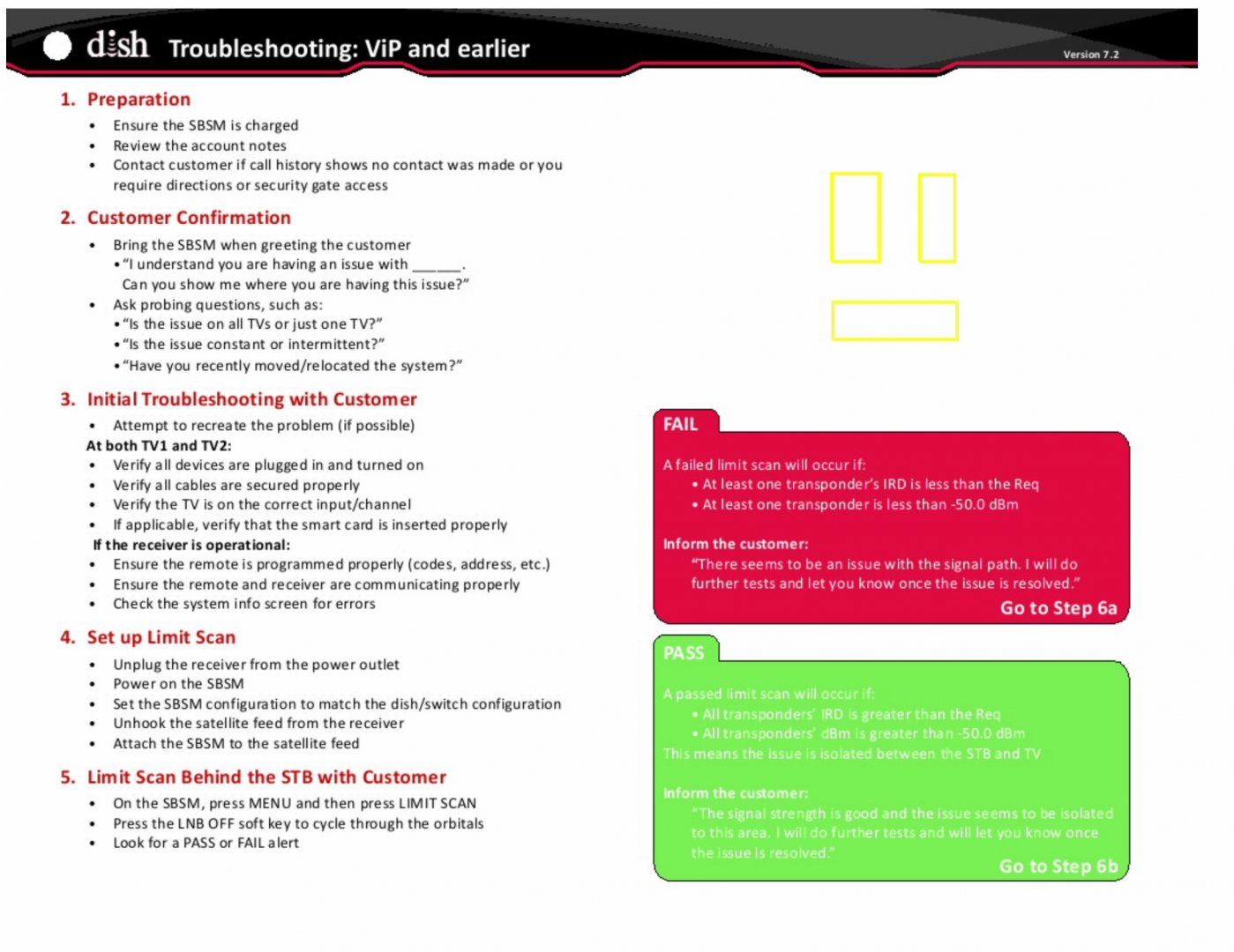

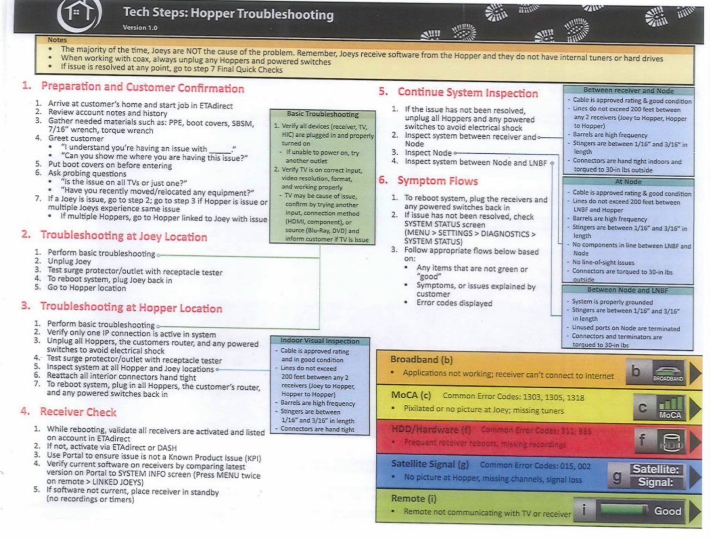

Most of those service calls are not getting billed and no, most techs do NOT do that because most techs depend on passing x number of metrics that determine their pay grade - which directly affects their pay checks. At my company, missing a metric is a 3 month pay cut. Are there lazy techs that don't care about good service or improving their job skills?? Of course, but those guys don't normally last long in this business anyway. Level 1 is terrible thing to see on your paycheck. The days of showing up in a station wagon with a case beer in the back are over, Claude.
Attached are the job aids that everyone should be trained on.
