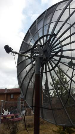

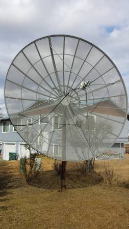

What brand is your dish?
Thank you for the links!
As for the brand of the Dish? I really do not know?? I will add some pics, and maybe someone could identify it?
View attachment 106488 View attachment 106489
I took these before i uninstalled it!
You're welcome! I don't know what type of dish that is,but it looks in real nice shape, that was worth getting! Someone on here will know what it is, I bet.
I think that's a "Perfect 10" dish. I also am using one, and they are good dishes. I also uploaded the full manual for it, and it's in the FTA Manuals download section here. It's a full size 11x17 inch, and will be invaluable to properly putting that back up. If you tore the dish down to individual sections, be aware that you MUST follow the instructions in the manual to make it properly go back together. Don't guess, because that won't work, lol. Believe me, I found that out the hard way with mine.

Did you measure it? It looks larger than a 10 footer. My 10' Perfect 10 has only 16 panels. Yours has 24 panels.
Great for surface accuracy.
I am wondering if this is a 12 foot dish myself? I will get out a tape measure and measure one of the sections tomorrow!
