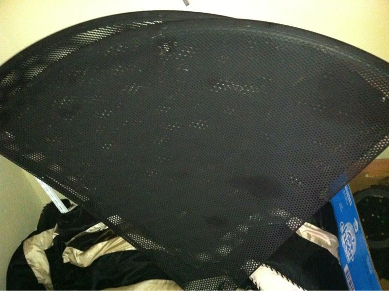

Fat Air- What is a warped dish?...My dish is not warped but what does that mean as far as a satellite dish goes. Do aluminum mesh dishes get warped or is it only a certain kind?
Warped means damaged. You can string test the dish once its assembled, just take some good string, like surveyor twine and stretch across the dish face, one vertical and one horizontal and pull taut. If the strings touch in the middle then you have a pretty good dish surface. If they don't , you can possibly adjust the dish-petals by loosening and re-tightening. Did you get the pipe to mount the dish on?

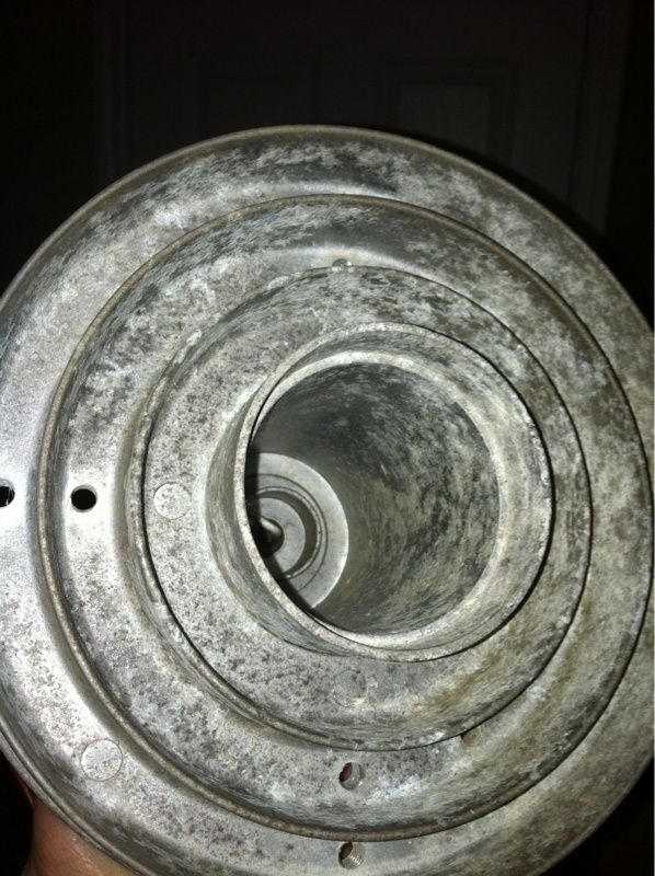

I have the feedhorn assembly, but now i Need an lnb. What lnb is good fro both c/ku signals?..I dont want to go crazy on price but I want something decent, also does the lnb connect to the feedhorn?..probably a stupid question
I haven't looked back at your pics just yet but have you looked at the feedhorn to see if its there? The lnb, if its the older, lnb-type will be bolted to the feedhorn. If you have the newer lnbf version, it is feedhorn/lnb all in one piece, it could be single or dual-output (dual is nice). And it could be both c and ku, if its lnbf .
If there's three little wires(Red/Black/White)coming out of a little blue box on the feed horn, it's servo operated for polarity. Not many FTA receivers can operate them. Old Pansat models and their new HDX9500 are the only models I know of that will run them. Those or an old analog receiver will operate the servo

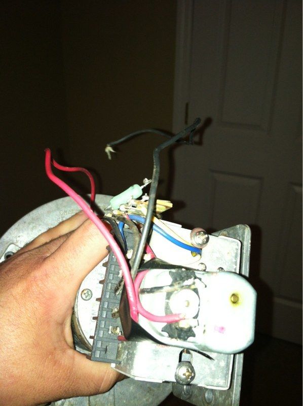

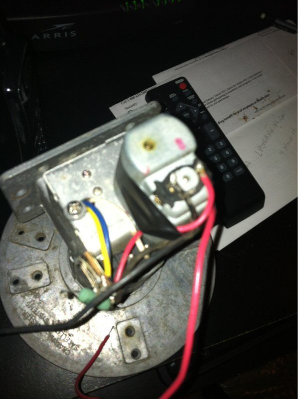

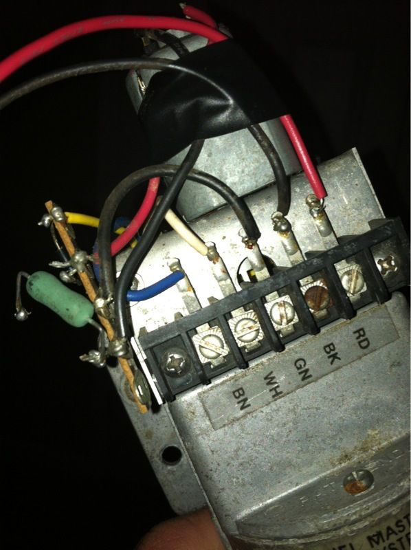

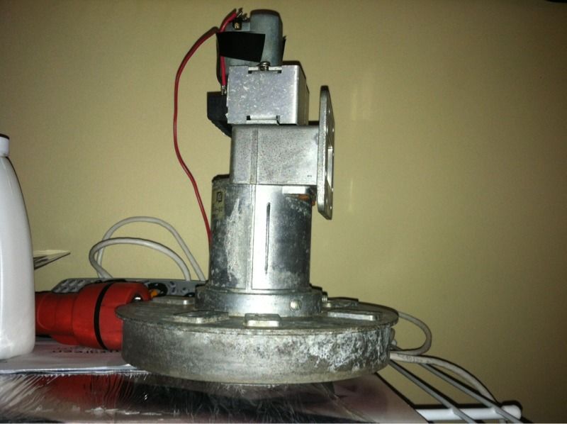

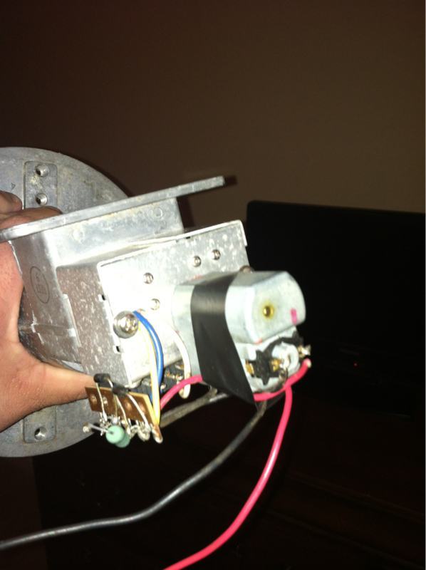

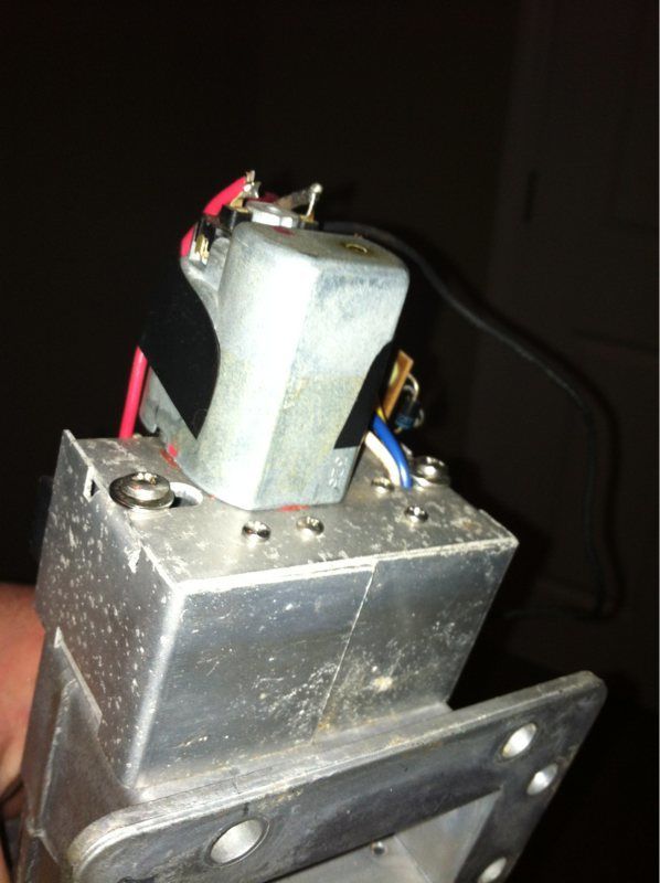

I have some pics of it let me know my options can I keep it for cband only or should I buy a new lnb?..thanks

OMG. I've only seen two of those before. Called a polorizer. Can't remember exactly the voltage, but think it was 12vdc. red + black - = one polarity. red-, and black + = the opposite polarity.
There's nothing available today to run it, so I would purchase a new LNBF.
The dish is unknown to me. How big are the holes? If in an area of 1 sq inch there's more metal surface than hole, it may work well for Ku along with C band.
Yeah fat air the dish can do both bands it says that in the instruction manual. What kind of lnbf do you suggest?
That would be a fun C-band only feed to play with if you like tinkering with control circuitry. If you just want Plug and Play with a C/Ku LNBF, the WS International 741 CKU LNBF is a reasonable choice.
The only suggestions I can make are "for Dual band (C and Ku) LNBF's are either a BSC621 or the 741 CKU LNBF. For C band only a BSC241(I have this on my BUD), the ESX241 or SatelliteAV's C1 or the dual output C2" If you ask for a recommendation, I think it's "up in the air" as each will have positive and negative recommendations. I personally think most are pretty equal, in the end.
