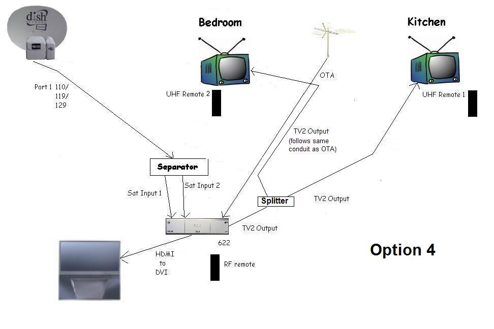

I didn't think I needed a dpp44. I should be getting a Dish 1000 (it is on the work order, ceo@echostar.com confirmed that). I plan to run one coax from the Dish 1000 to the separator that I got with the 622, then connect that to Sat 1 and Sat 2 inputs. I plan to split the TV2 output to feed 2 other TV's (it's OK that they would see the same output). Does that require a DPP44?
Thanks everyone for the information. I had started a separate thread here where we discussed my setup in depth and no one pointed out a dpp44 was needed. If someone could take a look at the attached picture and let me know where the dpp44 fits in, I would appreciate it. There were 4 different options I was considering and chose this one.

Why are you folks saying he needs a DPP44? He doesn't, please ignore them, they are wrong.
Wrong.
The Dish Pro Plus Twin LNB, which is used in a dish 1000 supports the use of seperators.
