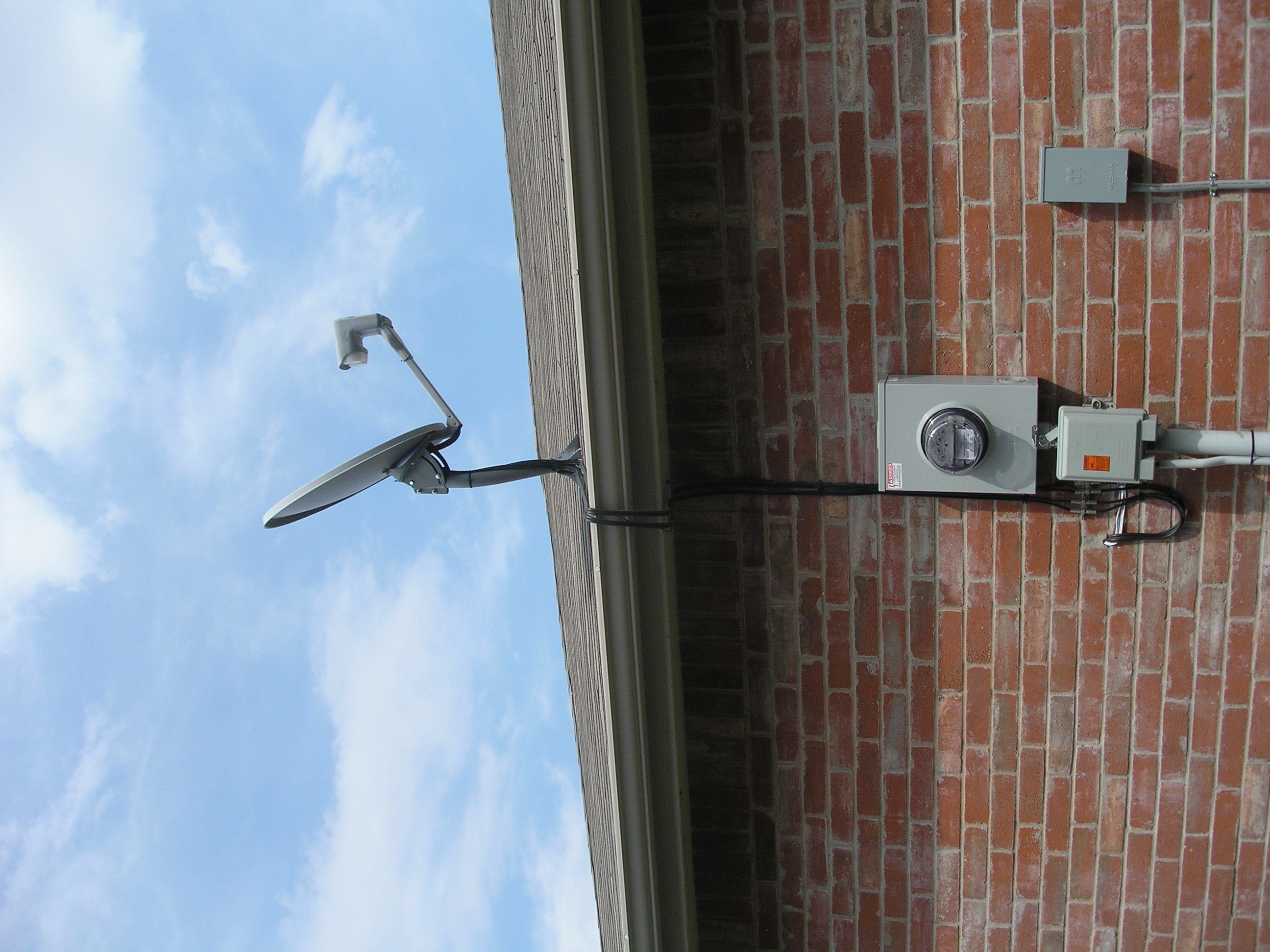

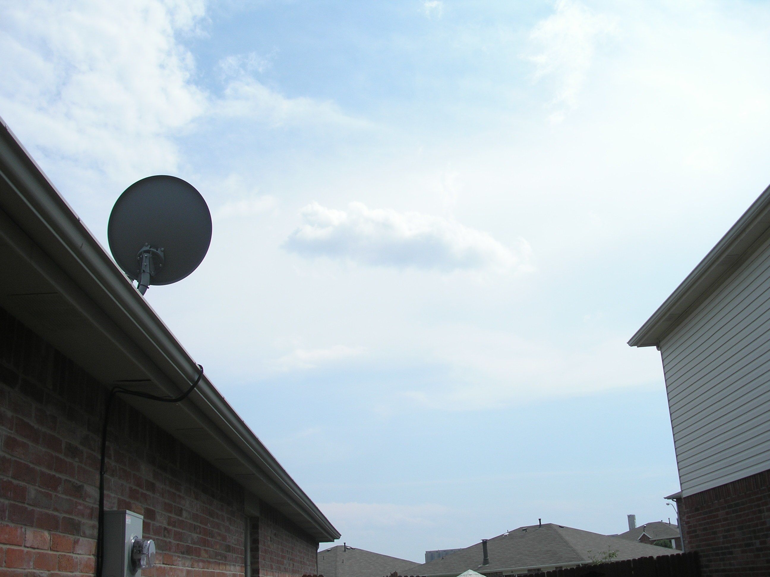

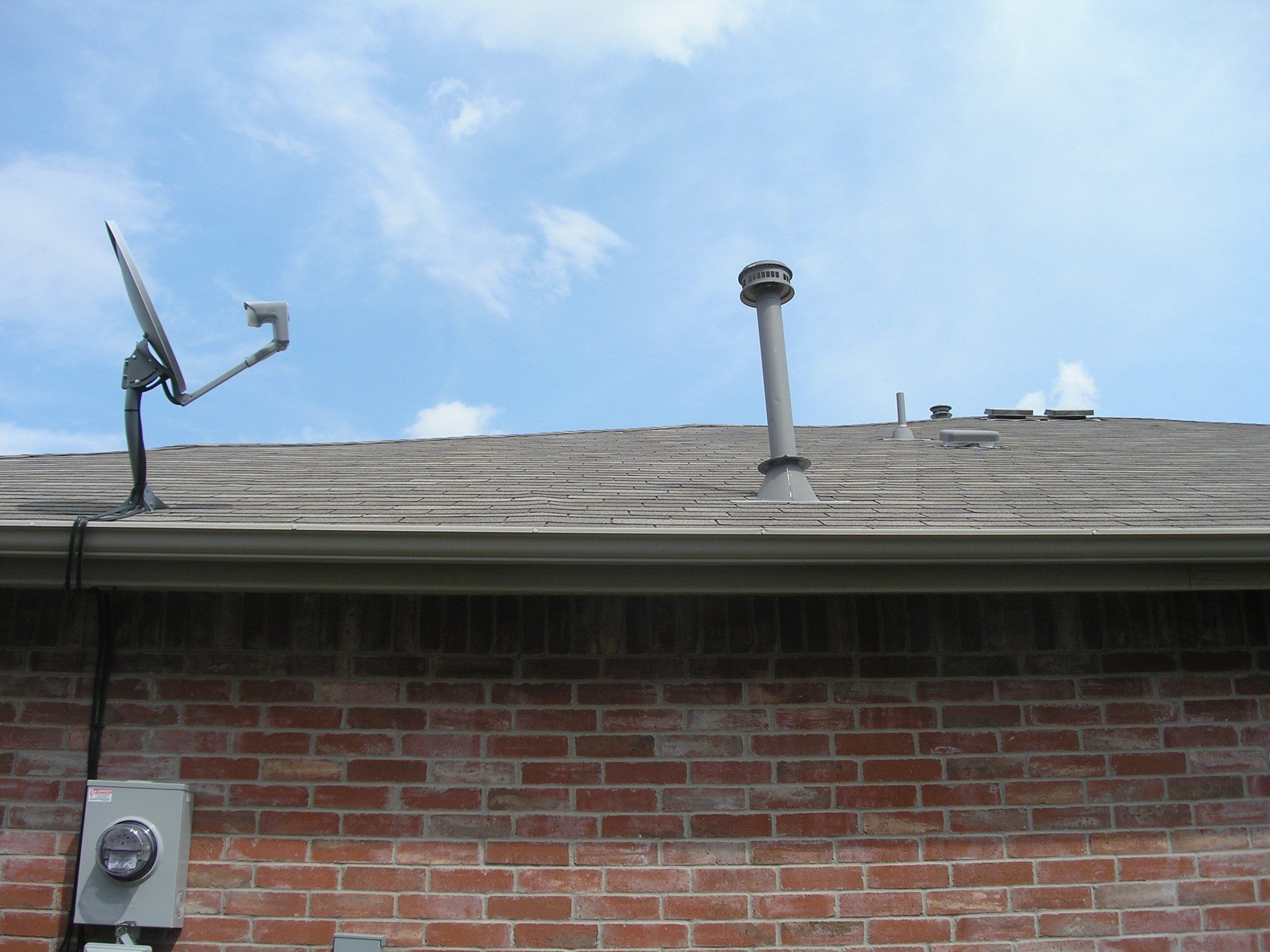

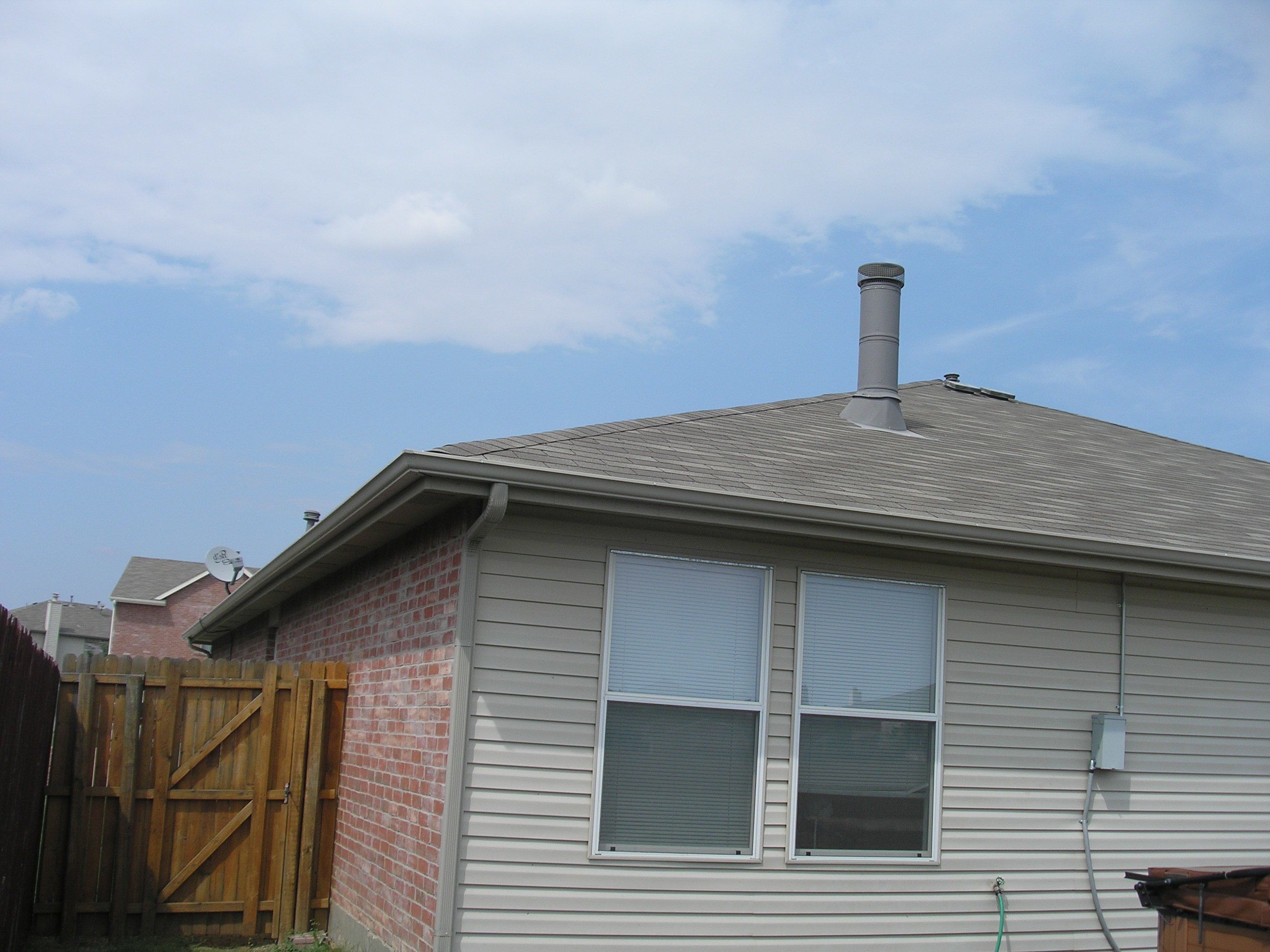

With the diseq switch you mentioned will that be needed if the cables are used to go into more than one room previously? Also I read the true south is need with clear view, I went and took a few pictures of the dish on roof and was curious if this will need replaced to get all of the possible channels in the sky?
Just trying to get everything needed with one order.

a few things I noticed,
1. the ground block is mounted vertical which could cause some moisture to run in.
2. no loops on both input or output, at least 5 inch loops and doubled to help with replacement of a connector without adding a piece and having yet another splice and connector to deal with. lightening can burn out the splice and never touch the ground block, also another place for moisture to get in
3. you mounted in the roof, in the long run water will work it's way in there redgardless of tar or whatever. me personally, I question the practice.
speaking of tips for the day, Ice there is a few there to use as well.
note I'm not picking on you but just giving some tips that can help with your install and give you less problems with your system in the long run.
Just replacing the "old dishnetwork dish" will not be enough, you will need to repalce the mount as well. Also, double check the wiring to be certain it is RG-6. It probably is but if not then better to replace it while you are up there in the clouds instead of later.
Good luck.
Where are you going to mount the dish? Somewhere on the ground or do you want to do a roof mount also? Roof mounts send chills up my back as most of them are never done right.....mounting it on the roof should be your last resort.
something else, please ground it, it doesn't look grounded. :eek: that makes me cringe seeing that. If grounding is causing an issue I can see removing it until the issue is found. $1000 and up tv is not the best thing to repair or replace let alone $300 and up for a HD satellite receiver and/or pvr.
