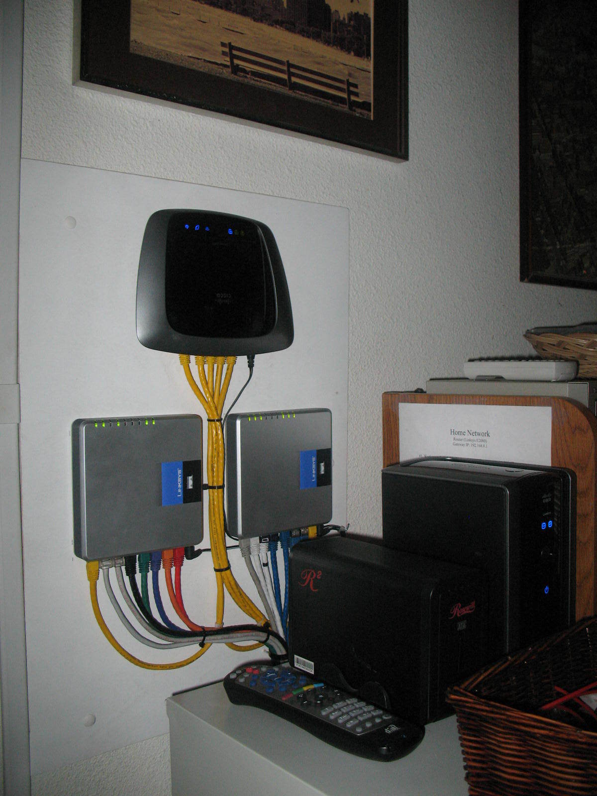

The IP required gigabit connecton to achieve the 101 speed. I am cabled with cat6 and employ gigabit LAN devices but I'm not sure the E2000 router would do gigabit WAN

Thanks for showing your "wiring plant".
You need to replace the two small switches with one big switch if you move a lot of traffic on your LAN. As it stands you are limiting your LAN traffic when you're going through the router.
You can pick up 16 and 24 port wire speed switches by tp-link and trendnet at reasonable prices.

My real want was the 15mb up. But the download is great as we do a lot of video streaming in the house. The router offers gigabit speed on the LAN and it really does :) . The two Gigabit switches don't slow anything down. I do have all the gaming connections on one switch though. But my kids often put up another switch in their rooms for all their friends needs. But only the computers and the NAS units have 10/100/1000 NICs. The speed across the LAN is almost the same as two HDDS in my computer. I'll have to see how it works if I upgrade the connection. Right now I'm at 30/5
