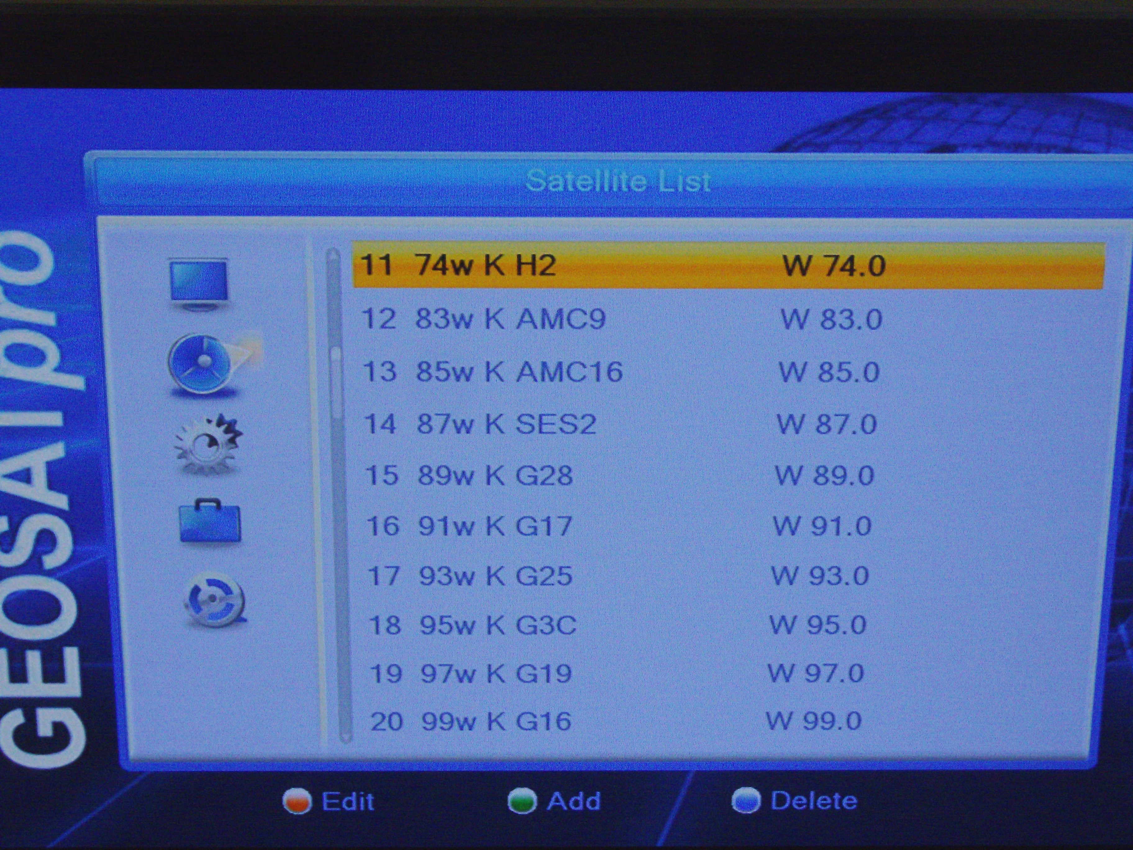

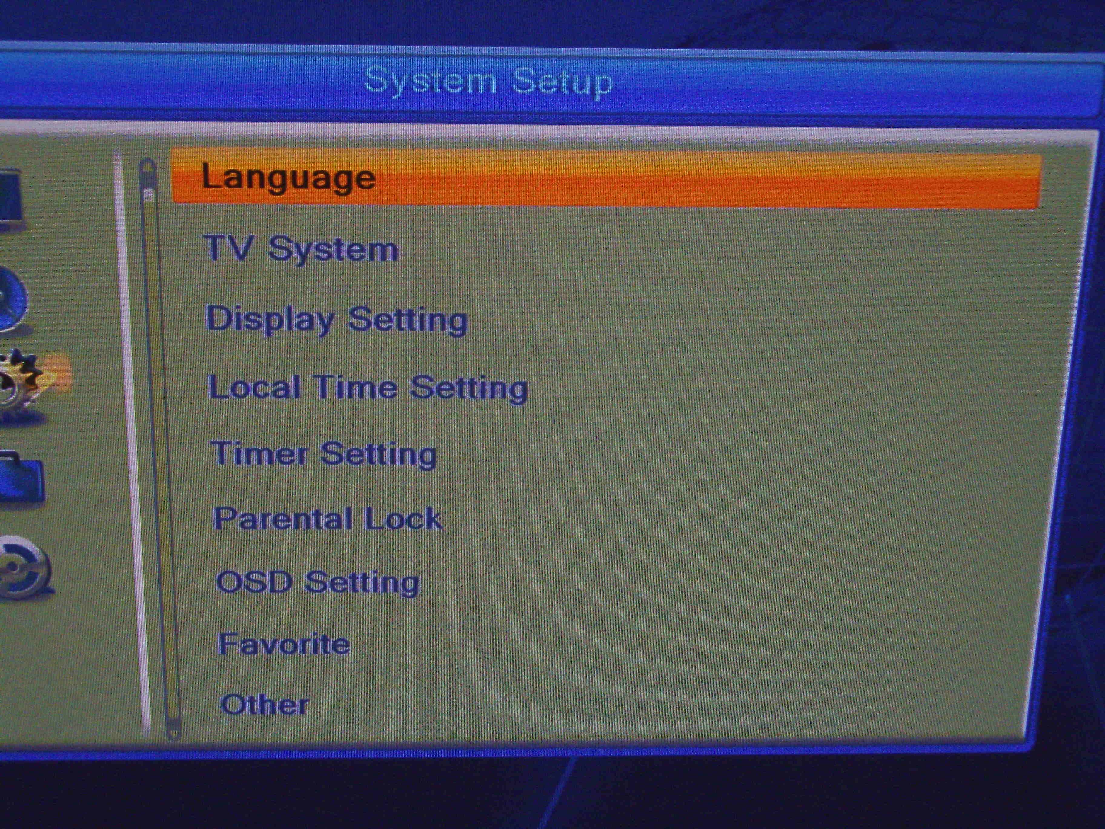

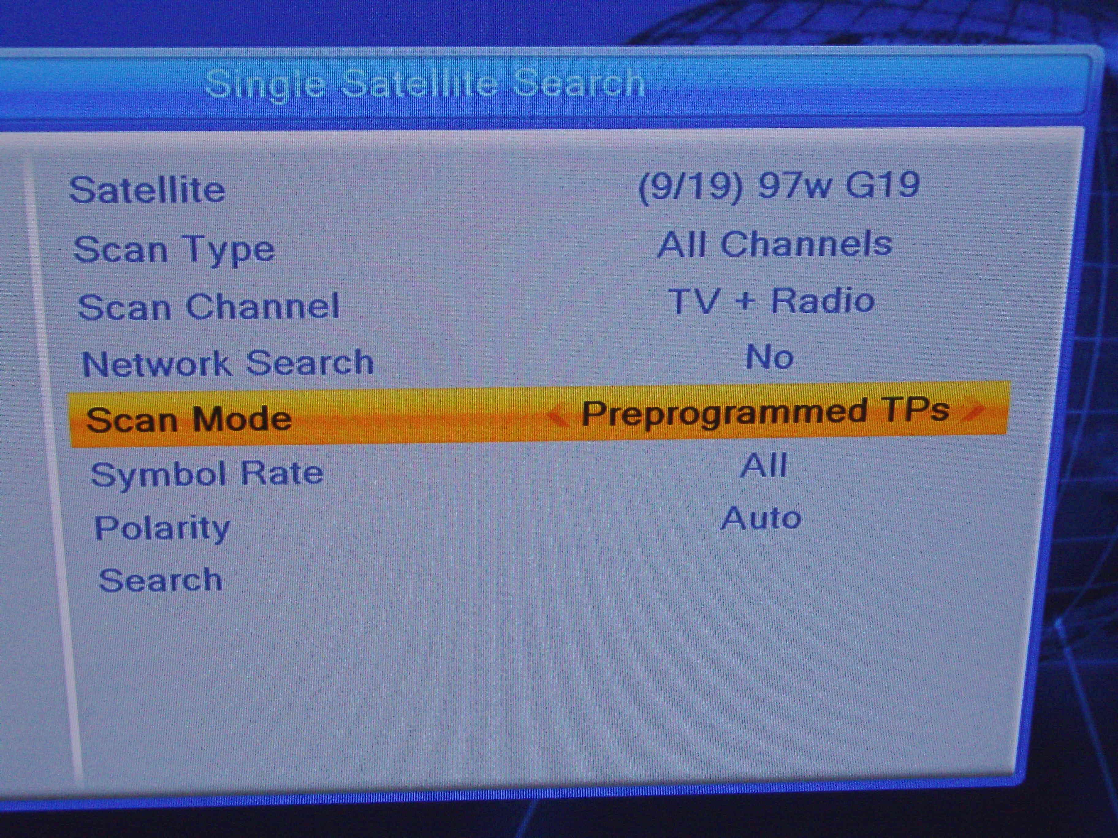

Upon powering it up you have to set up what satellites you want programmed in. The menu structure is very well thought out and simple to operate. I went into Satellite List (which when you start is one of the few options). The satellite list is thorough with KU first then C-Band. It starts at 30W and goes to 127W on the KU side. I like the fact the names are the orbital spot first then the name. I did go and rename most of the sats (I removed the “K” part….I know I’m working with KU). I did notice Satmex 5 (116.8) on the KU side is not listed. But since the footprint doesn’t reach me it’s a moot point. I may add it later.

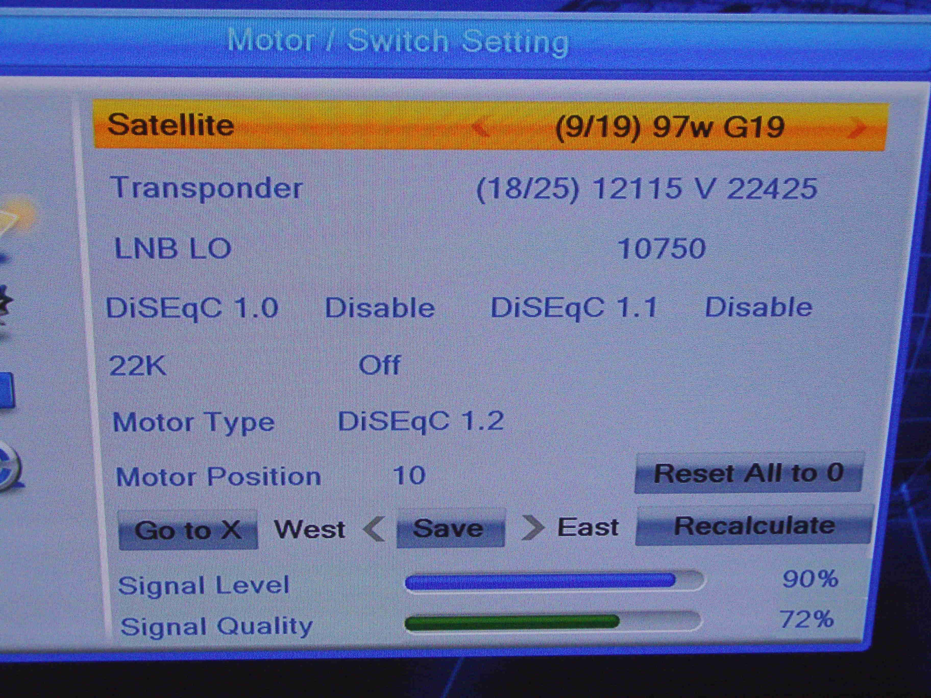

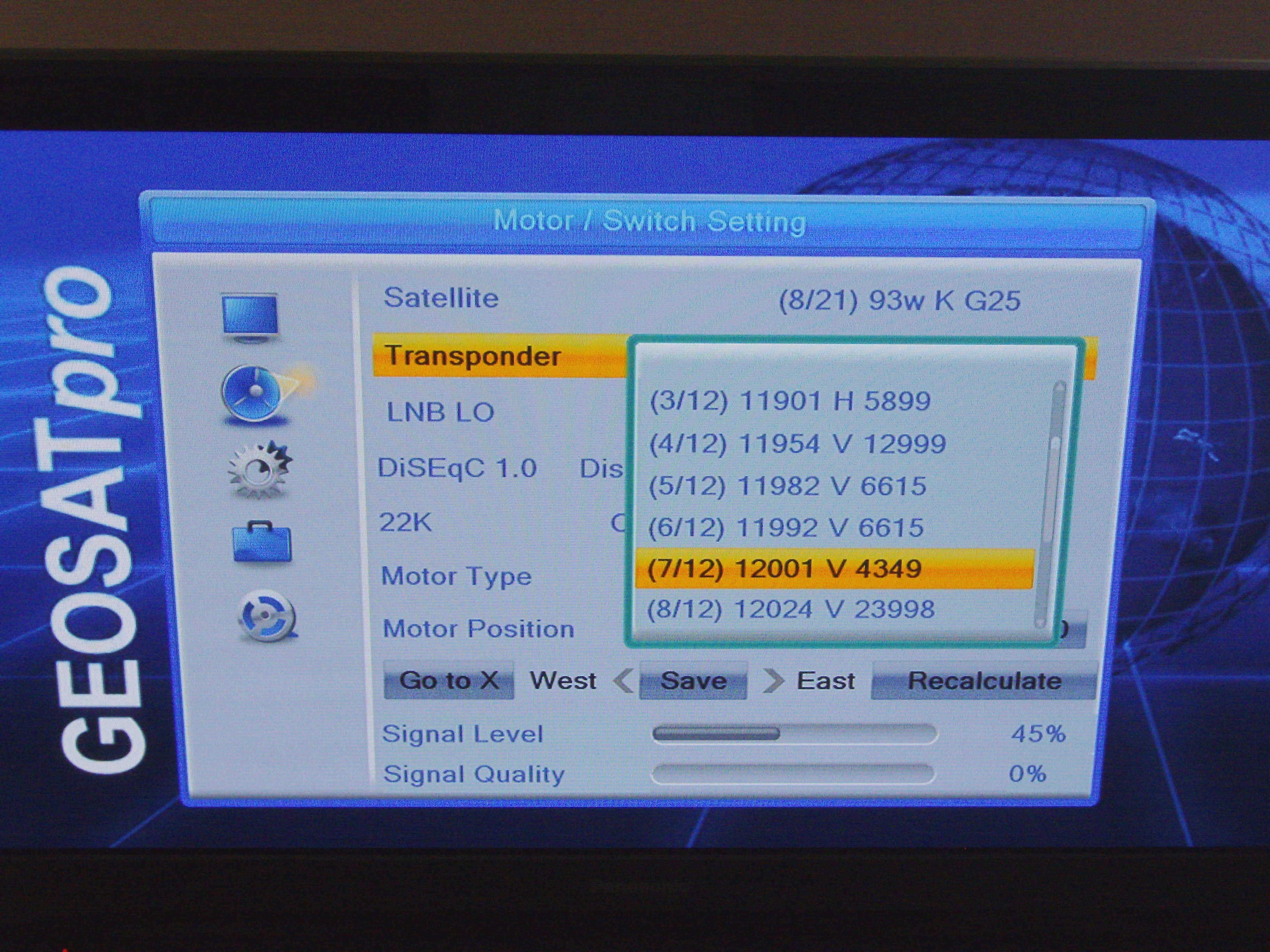

Setting up for a motorized is very simple. I went into the antenna setup and the motor/switch setup. The neat thing is once you have it set up you really don’t need to go back in there. I went in and set up my true south of 93W. Everything is there so you don’t have to go into submenus for some options. You can set up Diseqc 1.0, 22k switch, Diseqc 1.1 and a motor. I did set up USALS originally and they were all spot on. But the “don’t like change” in me changed them to Diseqc 1.2. Setup is a little different as for Diseqc 1.2 there is a “motor position” that you select a # between 1 & 99 to save each satellite. So as example my true south is #1, then 61W is #2, 72W is #3 and so on. I went through and have all my satellites set up. The default LNB Frequency is 10750 but you can scroll through numerous different LNB Frequency options. While it has the normal frequencies like 5150, 5750, 9750, 10600, 10750 and 11250 it also has options for stacked LNB’s (13850), and even the C/Ku LNB’s (5150/10750). It has pretty much any LNB Frequency known (and some not known).
The transponder list on some satellites is a little outdated. I had to go online and find a active transponder for my true south (93W) as none of the existing transponders were active. I do like that you can delete all transponders with one click (you can delete transponders one by one if you like). So once I was locked on a satellite I deleted all the transponders and blind scanned fresh. You have the option of blind scan-normal, blind scan-detail and transponder scan. Most of the time blindscan-normal works but in a couple of examples BS-detail might be needed. You can also select one polarity or even the frequency range. Manual PID entry is also an option.

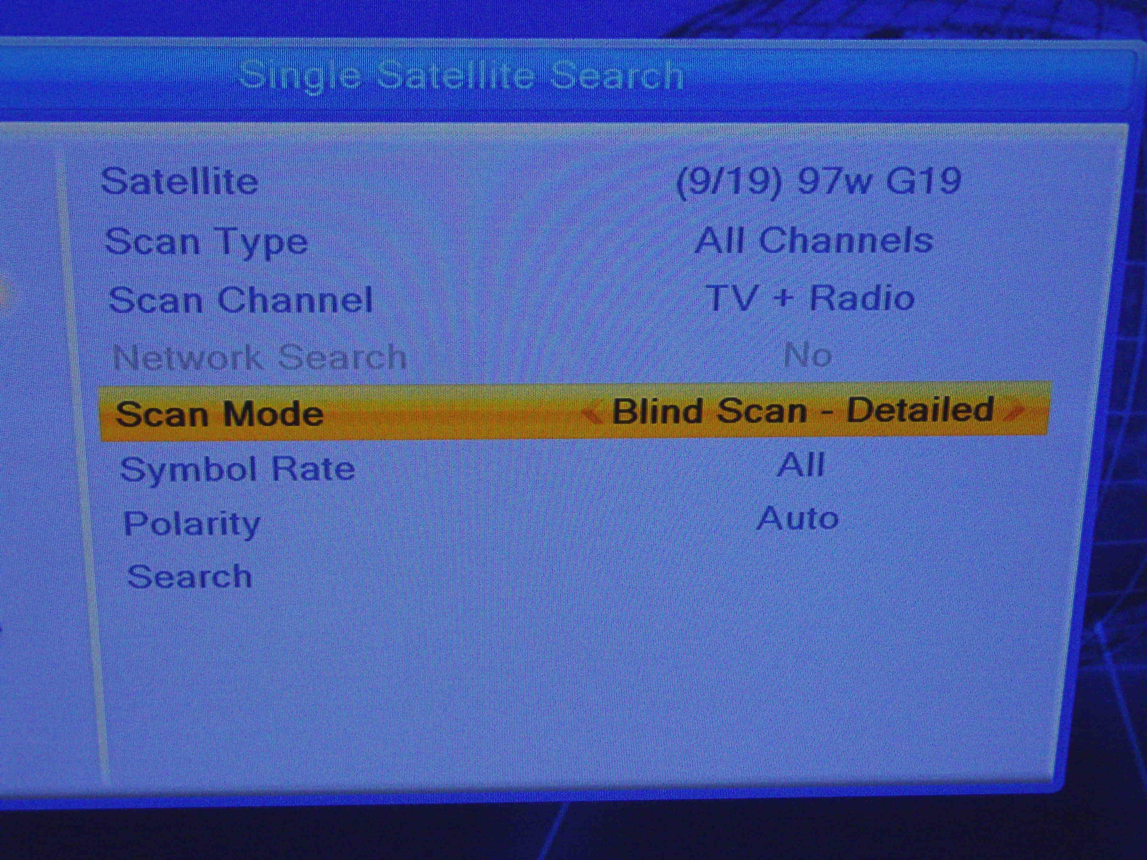

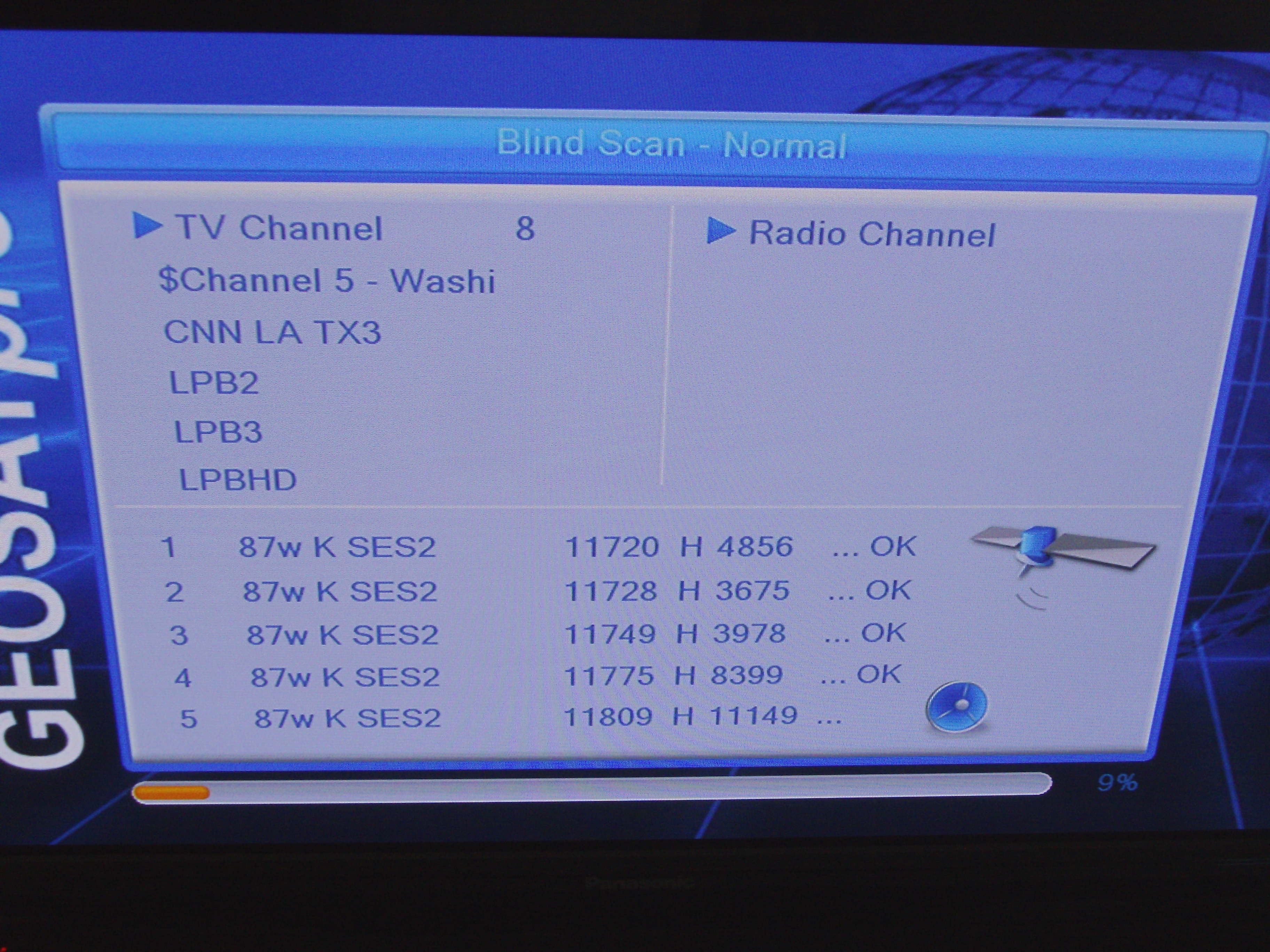

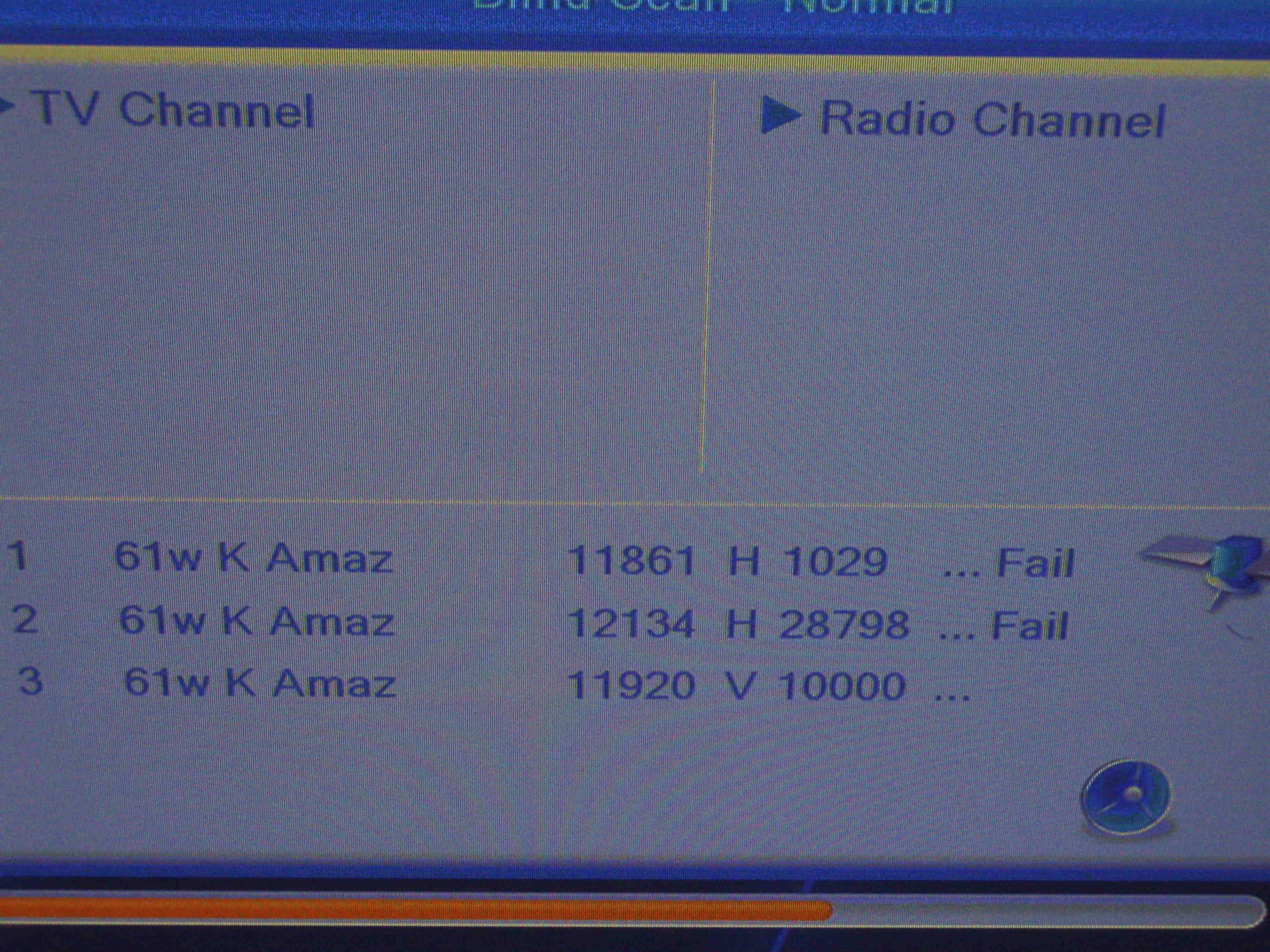

I did some testing between 3 receivers on blind scanning. A Coolsat 5000, the MicroHD and my Manhattan. I first tried 91W which had some news feeds on it
Coolsat 5000 found 9 transponders and 5 channels
Manhattan found 11 transponders and 4 channels
MicroHD found 11 transponders and 7 channels

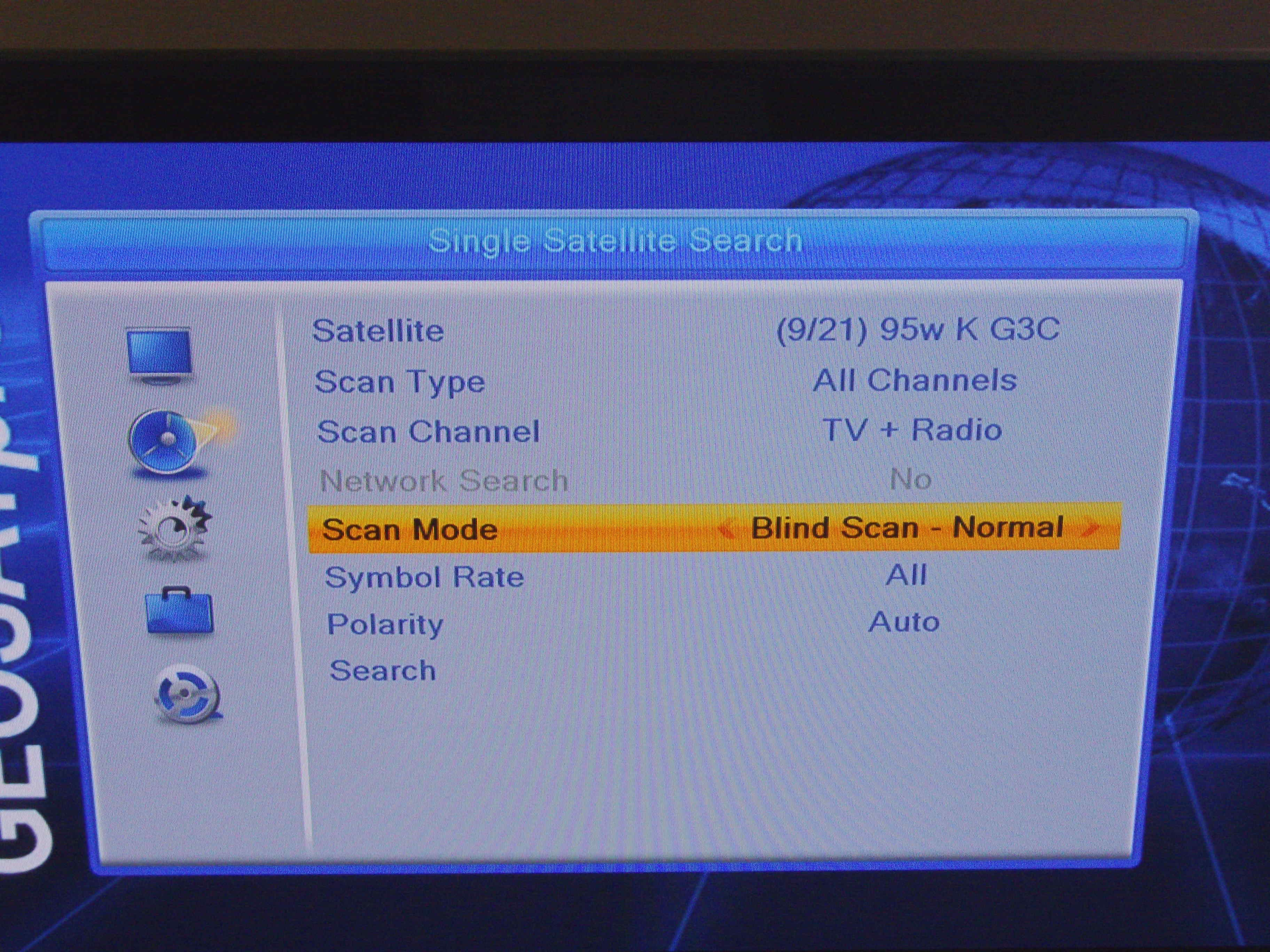

The thing to note is the MicroHD when you select “blind scan” defaults to 11700-12200 when scanning. The Manhattan scans from 11700-12900 so it found 3 transponders from Bell TV’s satellite
I then went to 72W
Coolsat 3 transponders and 5 channels (missed KFTL at 1666 symbol rate)
Manhattan did hit KFTL but missed the NBC mux (12052 V 6890)
MicroHD found 4 transponders and 6 channels (a feed, KFTL and the NBC mux)
When I went to 83W I had some weird results
Coolsat found 8 transponders and 6 channels (but missed the RTV mux completely)
Manhattan found the RTV mux but missed most of the NBC feeds that were up
MicroHD logged the RTV mux easily but missed a couple of the NBC feeds.

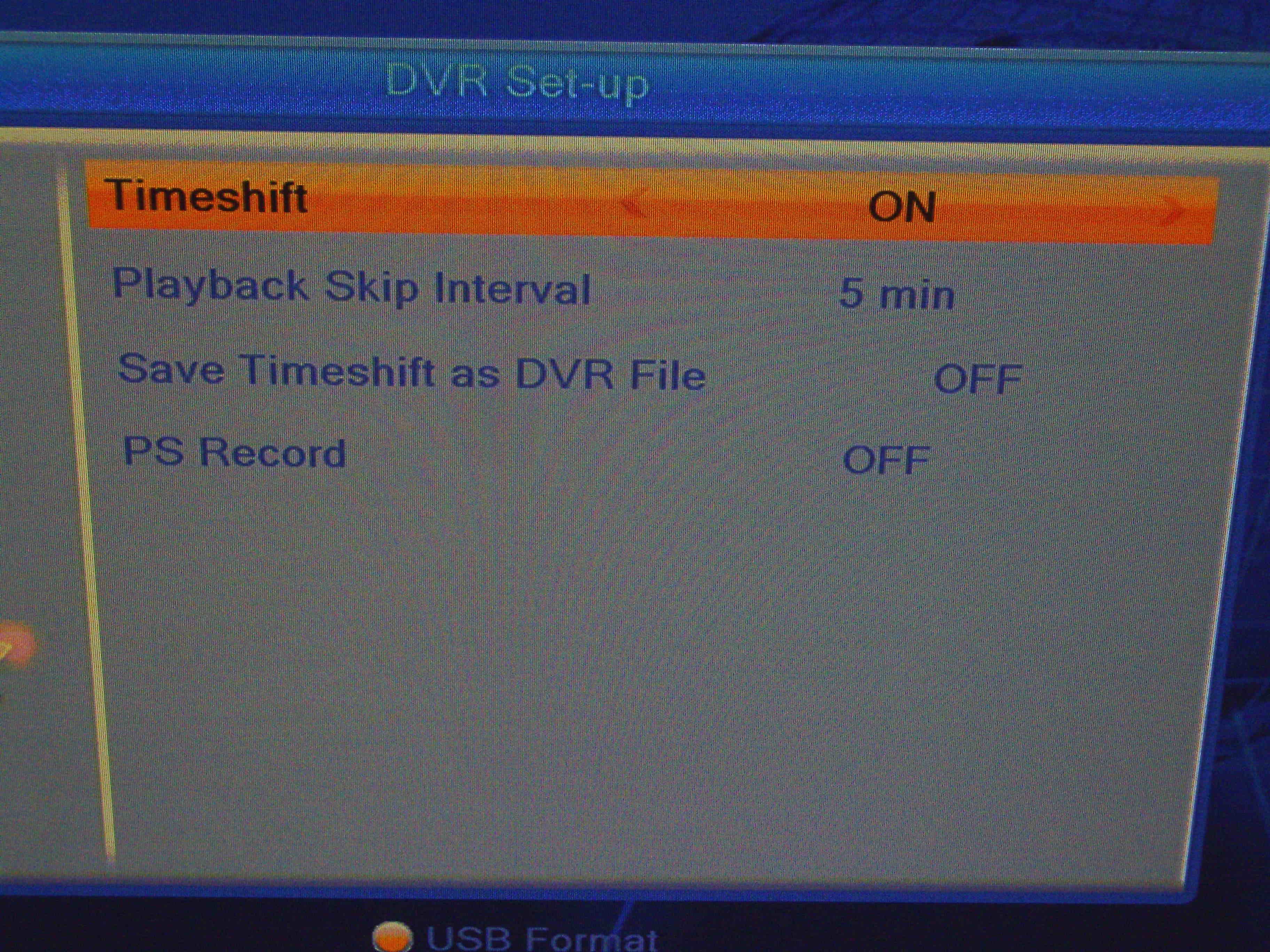

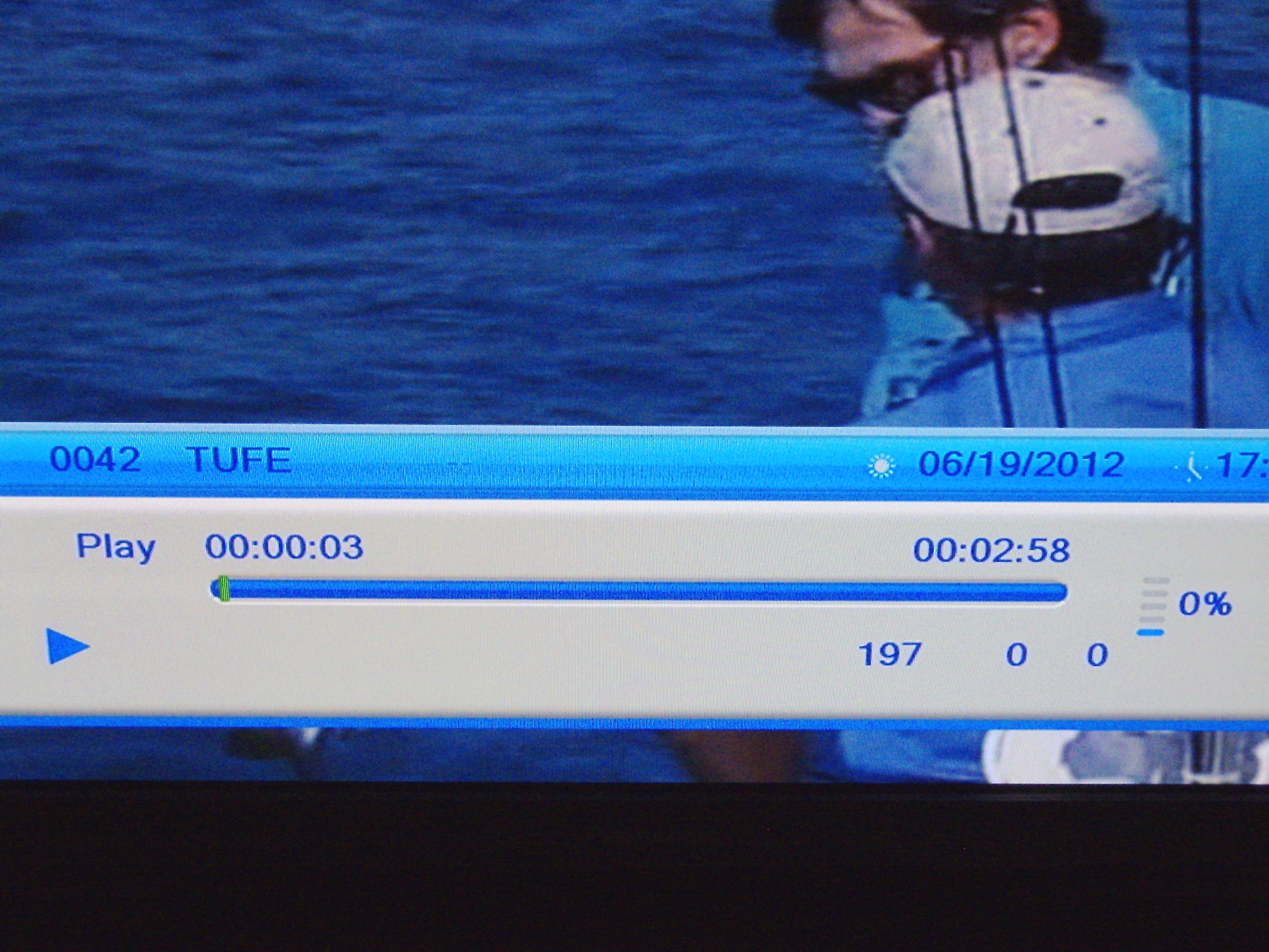

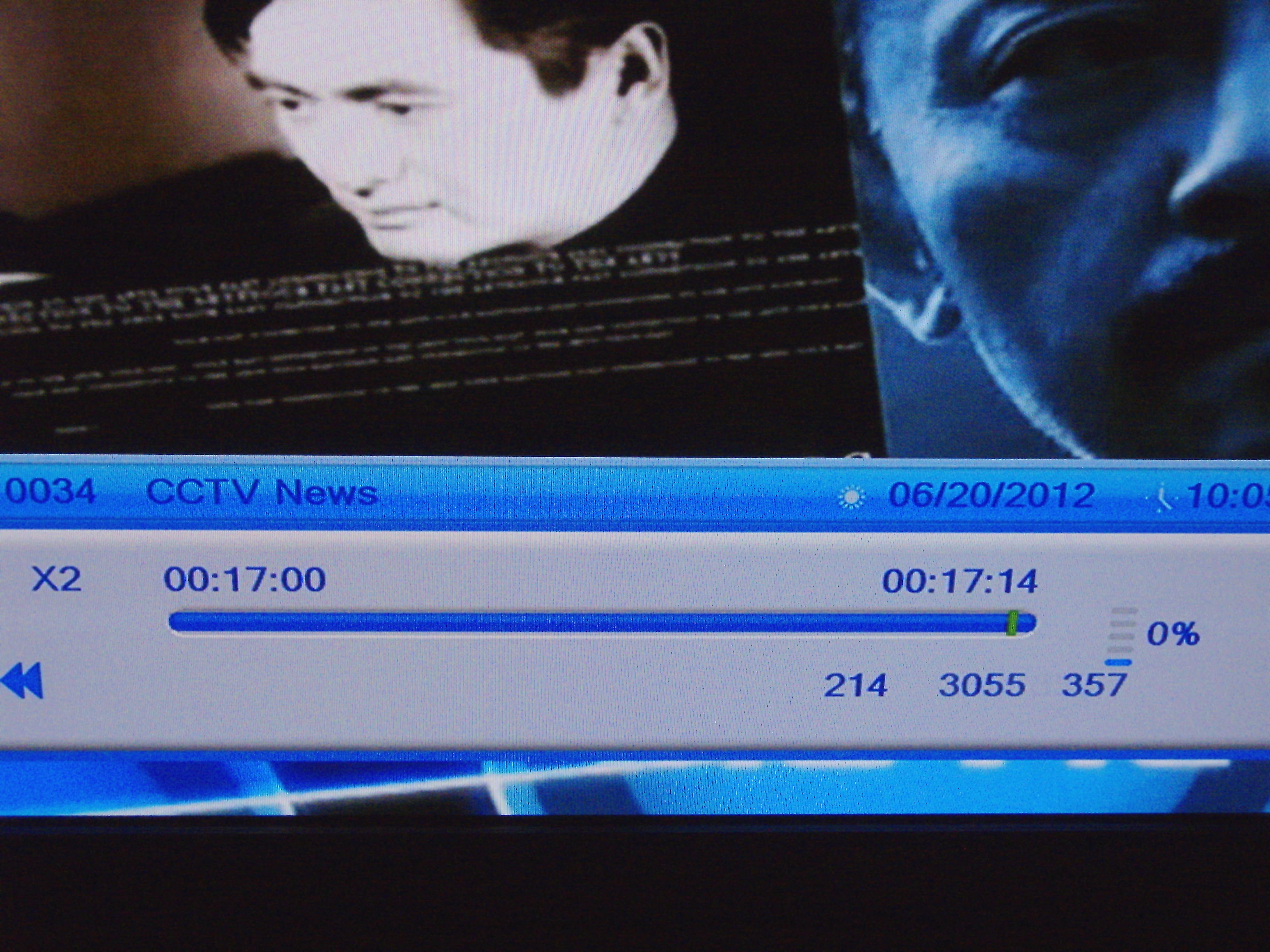

The receiver does have a buffer (timeshift) which works really well. You can go backwards or forward at 2,4,8,16 or 24 times speed. In the menu settings you can have it so when you hit record it either starts when you hit record or it dumps the whole buffer in the file. The one thing I ran into is the record length. Normally when you hit record it would pre-set for 2 hours. You could hit record again and change this to whatever you wanted. Also the buffer counts towards that recording time. So if you had 38 minutes of buffered programming and hit record it shows 38:01. But when I hit record it defaults to 14 hours and you cant change it.

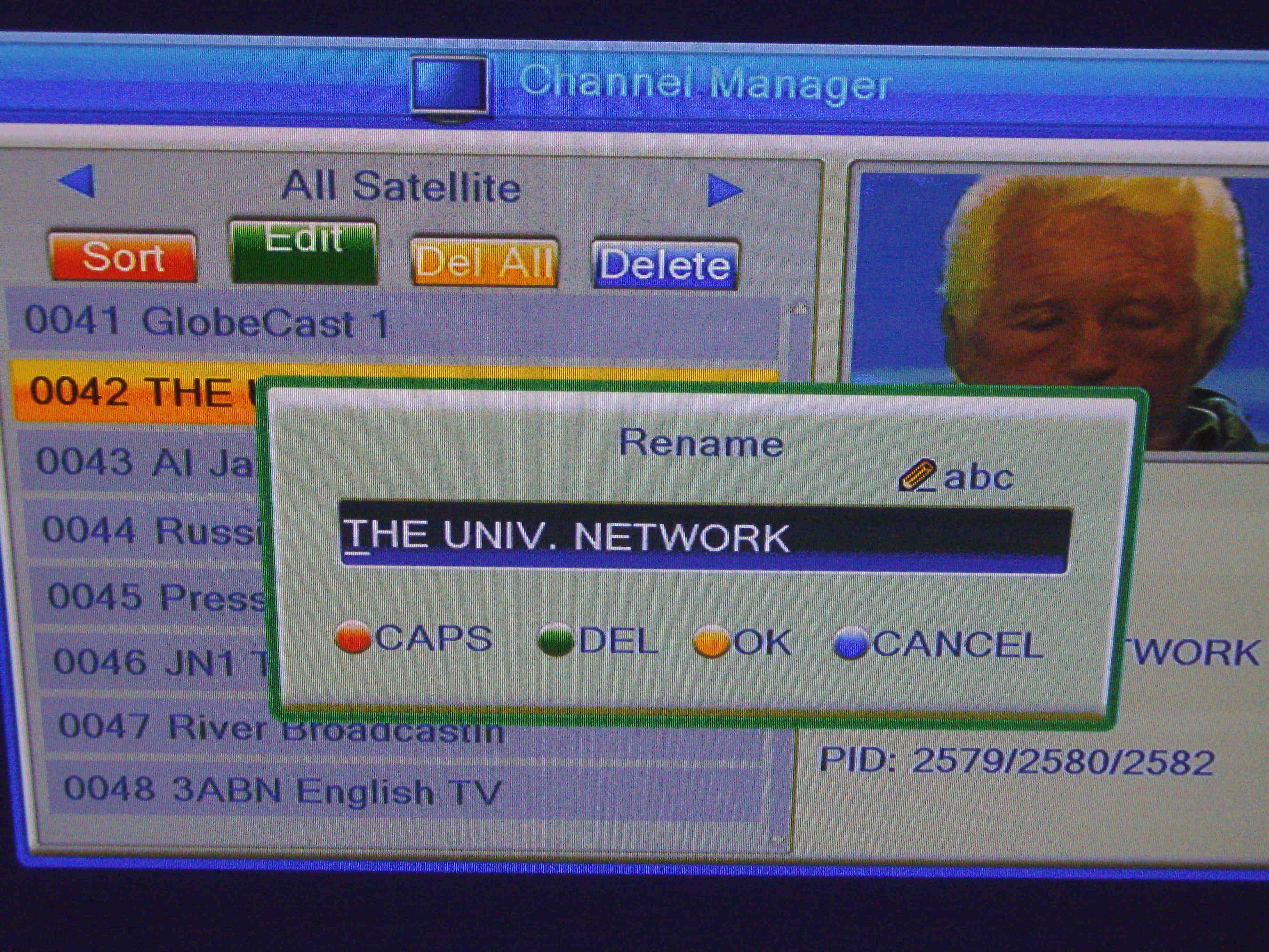

Channel editing is very easy to do. Go into the TV channel (or radio if you need to work on those) and use the color buttons to edit a channel name, move them around or remove. One thing I wish the MicroHD had was a way to remove all channels from a transponder. My GeosatPro 200 has that option. I can remove channels one by one, per transponder or per satellite. Also I noticed that if you rename a channel and do a blind scan at another time it overwrites the edited name. As we all know very few of the PBS channels actually have a name attached. Most are “TV3”, “TV4” etc. So I renamed TV3 & TV4 as PBS HD EAST and PBS HD WEST. Well when I redid a blind scan later when it found 12140 V 30000 (where they are located) it renamed them back to TV3 & TV4.

-sat list is up to date with names
-easy to add/delete/rename satellites
-can use 22k, Diseqc 1.0, 1.1 & 1.2 (or USALS) at same time
-has pretty much every combination of a LNB LO Frequency known to man (and some probably not known)

-numerous scanning options. Can blind scan normal, blind scan detail, TP scan, sat scan (of existing transponders)
-Can specify frequency range (default is 11700-12200 for KU Band 10750 LNB LO frequency) and polarity
-PID scan
-blind scan finds symbol rates down to 1000
-picks up DVB, MPEG4 and DVB-S2 transponders
-easy edit of channel names/deleting of channels

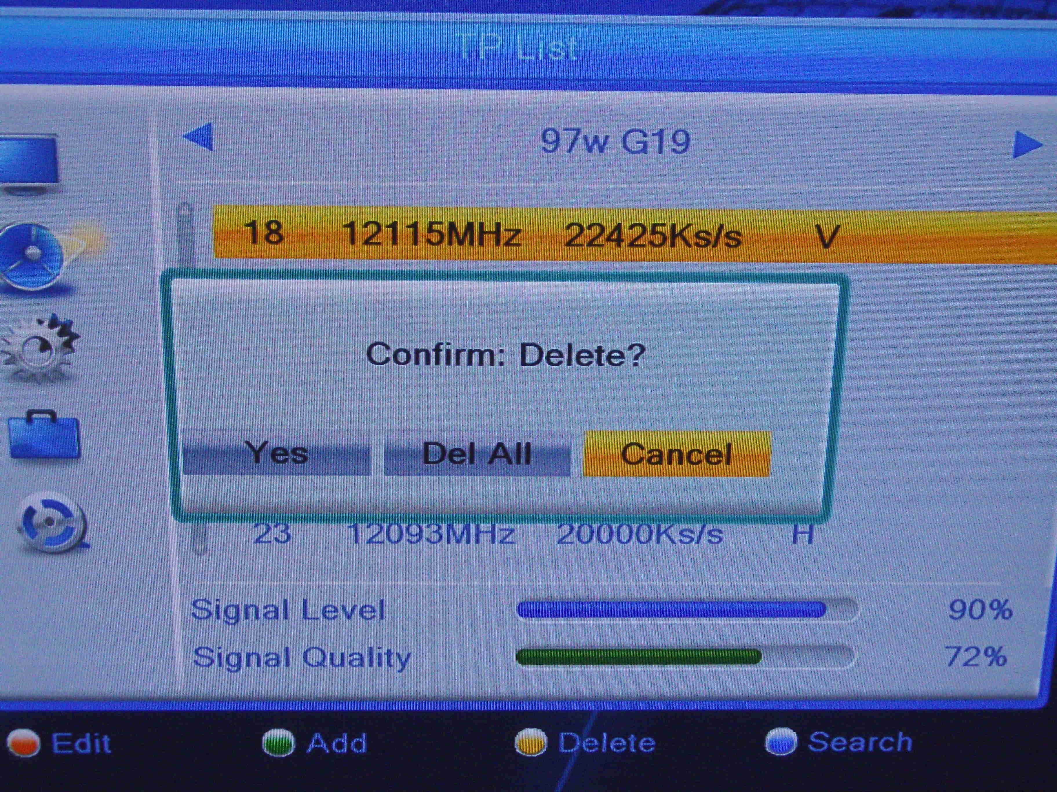

-can delete all TP's on satellite with one click

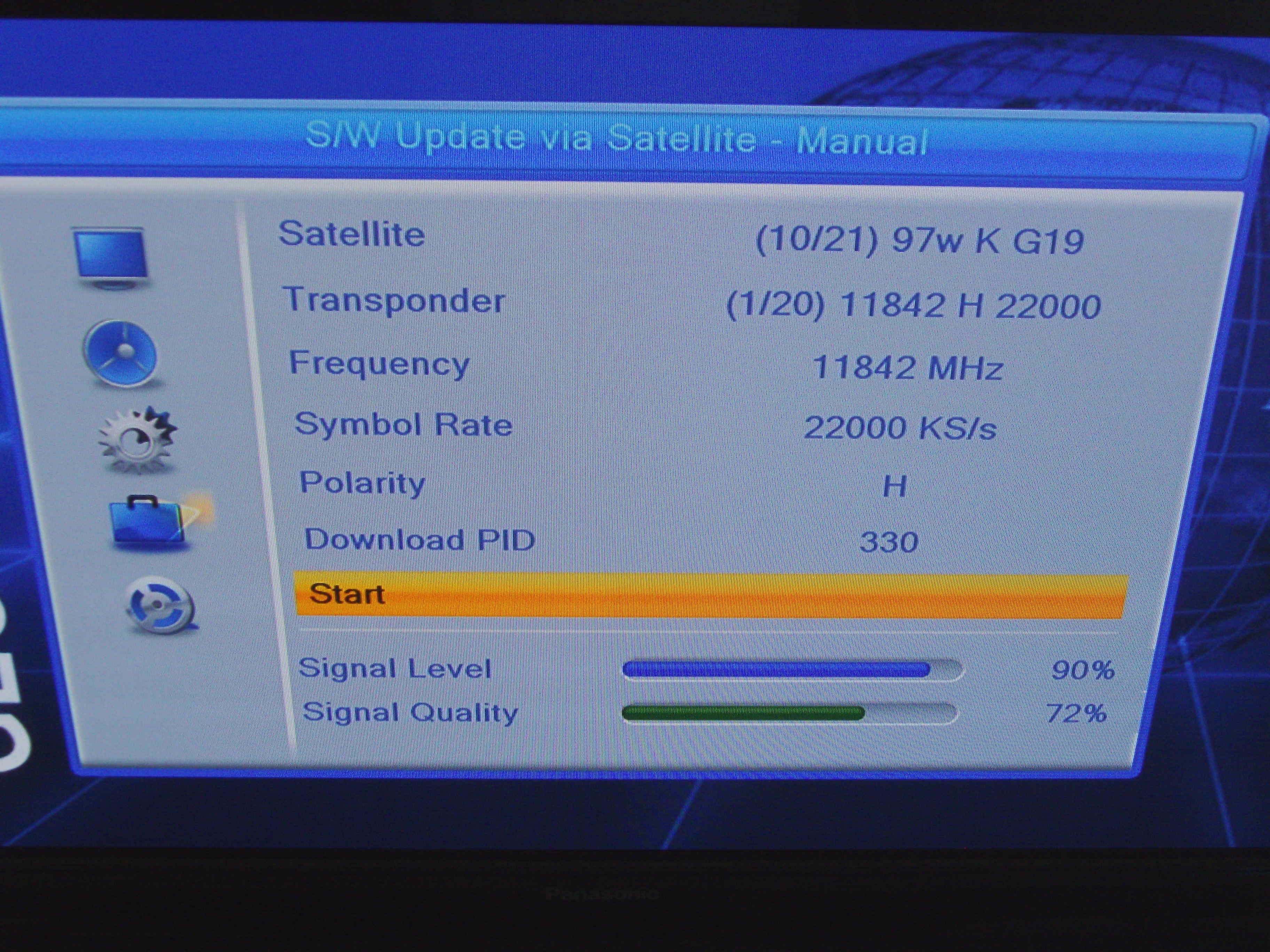

-software updates via satellite (G19)
-timeshift (buffer) of current program
-a accurate clock
-if you hit record it can dump the buffered programming in the DVR file

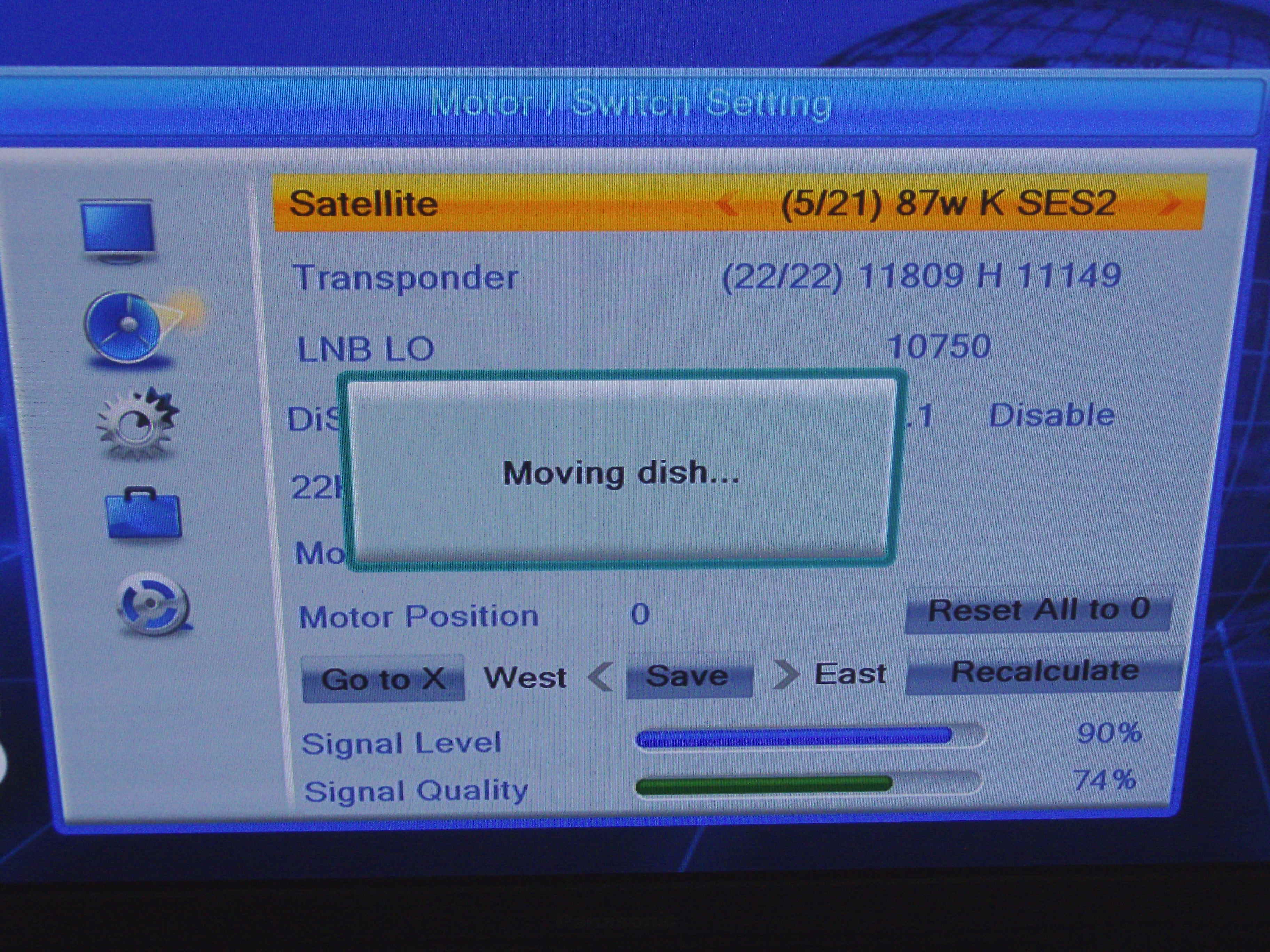

One thing that really bugs me is there is a "moving dish" popup that shows up no matter what you do. I know some receivers have it but most that popup leaves right away. This stays up for 15 seconds unless you hit "exit" before that. This shows up if you go into the transponder list and antenna setup. I understand if you are going from say 83W to 91W but why when you are on 91W already and you want to blind scan it does that popup when you hit OK to scan? The only time it is rather quick is when you power it on for the first time. It only shows up for about 2 seconds. I know my Coolsat 5000 only does it for a couple seconds but I’m still using version 1.00 software. Anything else (including the factory 3rd party stuff) has that popup too for longer.
This is what SatelliteAv sent back to me about it
"Dish Moving" - It also drives me nuts! We are working on this irritant so the display will leave after 3 or 4 seconds, but their are other functions hard coded by ALI that is making this very difficult. If the display is programmed to disappear earlier, there is currently no way to prevent he next step of the process from starting. There are no time place holders without the display. The result is if the display is removed early, the next event step starts. What happens for example is that if in a scan mode, the scan is initiated prior to the dish landing on the target satellite. I have been playing with displaying a blank screen, but this can confuse the user as you still must either press exit to skip to the next step or wait. If the user does not visually see that a motor move event command is still waiting to time out, the RCU would not function until the exit button was pressed or the event times out. It is totally a ALI coding issue that we are fighting a work around
When doing a blind scan if you select one polarity after the scan is done it stays on that polarity. You have to go into the satellite scan, change it to AUTO then back out.
SatelliteAV said this is on the list to be fixed so it defaults to auto when done.
I mentioned this above but if you rename a channel and do a scan at another time it writes over the existing name with what the SID shows....example I scanned the PBS HD feeds on 12140 V 30000. They show as "TV3 & TV4"....I renamed them "PBS HD EAST" and "PBS HD WEST". When I rescanned AMC21 it rewrote the names as TV3 & TV4
SatelliteAV said this is on the list to be fixed so that it doesn’t overwrite the changed channel name
