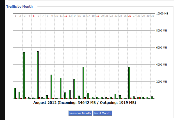

On a side note for customers not wanting to keep up with their usage with the hughes status meter or from the customer care page. DD-WRT is a 3rd party software that pretty much surpasses most router configurations & can monitor your usage. http://www.dd-wrt.com/site/index
