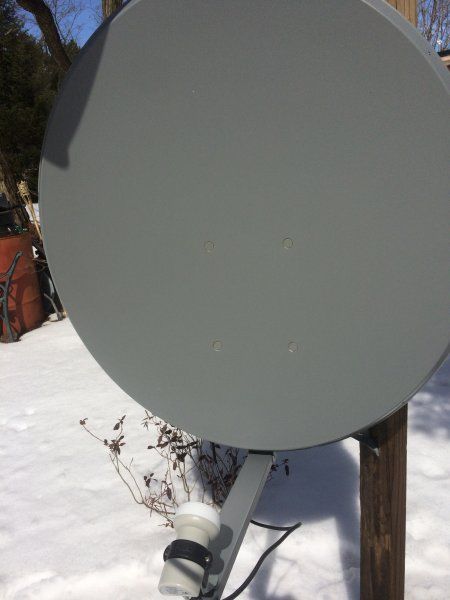

hi,
I just got my complete satellite equip. set up and after a bunch of tries and moves to diff locations around the property I cant get my signal quality up past 42%(signal strength is at 92%).Now my reciever box says its sees around 35 transponders and I can get around 87 paid channels but not one free channel or a single radio channel. Im located in northeast PA so I was trying to align to galaxy 18 & 19 along with amc 21, once again i get a list of 30 some transponders it sees off those 3 satellites but not one free channel? Im really new to satellite equipment so any help would be greatly appreciated, it feels like im close to the finish but not sure what to do...lol
My equip: Slim line dtv dish, a DV3 S2 reciever box, Dual Output KU Band LNB High Gain Universal Ku Band Twin Output Hd LNB Lnbf Two Output LNB, and top of the line satellite cable.(everything was just bought around X-mas this year)

The Slimline dish is likely undersized for most current Ku FTA content. It is sufficiently wide perhaps, but at only 22.5" tall, it's a bit too short. You may be able to receive a number of DVB-S feeds on 97, and perhaps the CNN feeds on 87, but that's about it. To get any DVB-S2 channels, you really need at least a 76cm oval dish. This is a good one (I have 2 of them): Winegard 30 Inch Diameter Universal Satellite Dish Antenna (DS-2076) 615798308780 | eBay

I have that same 30inch dish im new to FTA but i can get no channels on galaxy 19 I really dont know what to do i need strong transponders for galaxy 19 and intelsat 23 and LNB frequency

First, I don't know how you are aiming the dish. That's probably the critical part. It's very difficult to aim a dish without any direct feedback. The best approach is to have the receiver and a TV or monitor near teh dish, or at least where you can directly see them through a window, etc. You could also use Facetime or Skype etc to view the TV screen remotely but it's not so convenient as those apps have a slight lag. Also, make sure the pole supporting the dish is perfectly vertical and solidly attached (that it won't sag under the added weight of the dish)
let's start with 95W, it's easier to find than 97W
First, make sure your receiver LNB setting is set to Universal, with Local Oscillator frequencies of 9750 and 10600.
then choose Galaxy 3C Ku /95W as the satellite and select transponder 11780 H 20760. Or if it's not there, see if you can enter it manually.
get the dish aimed roughly with the proper elevation and the approximate azimuth. move the dish sideways in a sweeping motion, around the area you'd expect the satellite to be. if you don't get anything, lower or increase the elevation a bit, and repeat the azimuth sweeping, and keep doing this until you get a signal on that transponder. It's probably the strongest, cleanest transponder in Ku FTA in that part of the sky.
Once you get a lock on the signal, fine tune the elevation and azimuth to maximize the signal quality. Note the the signal strength is irrelevant, it's the quality that matters.
Once you have 95W, do a blind scan, that should bring in 5 CCTV/CGTN channels, and several other Chinese channels on another transponder. Once you have that, Galaxy 19 (97W) is next to it: move the dish slightly to the west by about 2 degrees (or until just past the point when you lose CGTN signal), keeping the same elevation. Change the satellite selection in your receiver to Galaxy 19 Ku, make sure the LNB settings are correct, and do a blind scan. That should likely bring in the Galaxy 19 channels.
For Galaxy 18 (123W), KBS is the easiest signal, but it's not as easy as 95W. Its transponder is 12078 V 3680. It's quite strong but next to another strong satellite, so it can be easily missed. Use the same method as described above.
As Raine indicated, 125W is probably mission impossible on a Slimline dish. Still worth a shot later, once you are more familiar with Galaxy 3C, 18 and 19, but I would not bother trying 125W for now.

Hello everyone,
First I want to thank everyone for they're help and time, I didnt know what to expect by asking for help online but didnt expect this much help this fast!! lol .Thank you all!.. I thought maybe id have to wait a couple days, lol..So I just bought a new dish 33" round, it should be arriving in about a week or so, once it comes in ll have it set up that day and I can let everyone know what kind of difference it made (hopefully ill have some channels).
Here's my current transponder list of scanning for galaxy 18-19 and amc 21

No free channels or radio tho
If I turn off "free tv only" I get 96 channels that all have the same text format as the next, just the numbers change. $CH-8780, $CH-6252, $CH-6250, $CH-8773 etc. All have info at bottom of screen and all say that they come from one of the 3 satellites im currently looking for...if i view any of those channels it says on the screen " Message - Encrypt Program".. Im lost..lol
Hopefully the bigger dish will fix this??

ok I think what you are seeing is a combination of Anik F2 @ 111W and Echostar (Dish Network) @ 110W.
There's nothing to receive on Anik F2 in Ku band but most receivers will detect those transponders at 11776 and 11786. Not sure why you got those in both polarities though. Maybe you turned the LNBF at some point?
The rest of what you are seeing is from Dish Network, and yes, it's all encrypted and using this proprietary naming scheme. Those would likely come in with both H and V as they are circular polarization.
So it means that your dish is pointing too far west.
If you raise the elevation by about 2 degrees and turn the dish eastward by about 13-14 degrees you should start getting something from Galaxy 19 or Galaxy 3C. On the way there you might see SES3 @103W. It has RT and NHK and CGTN in HD, quite easy to receive.
