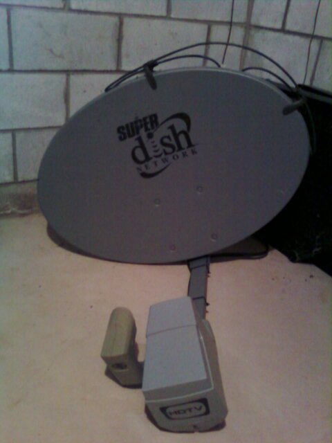

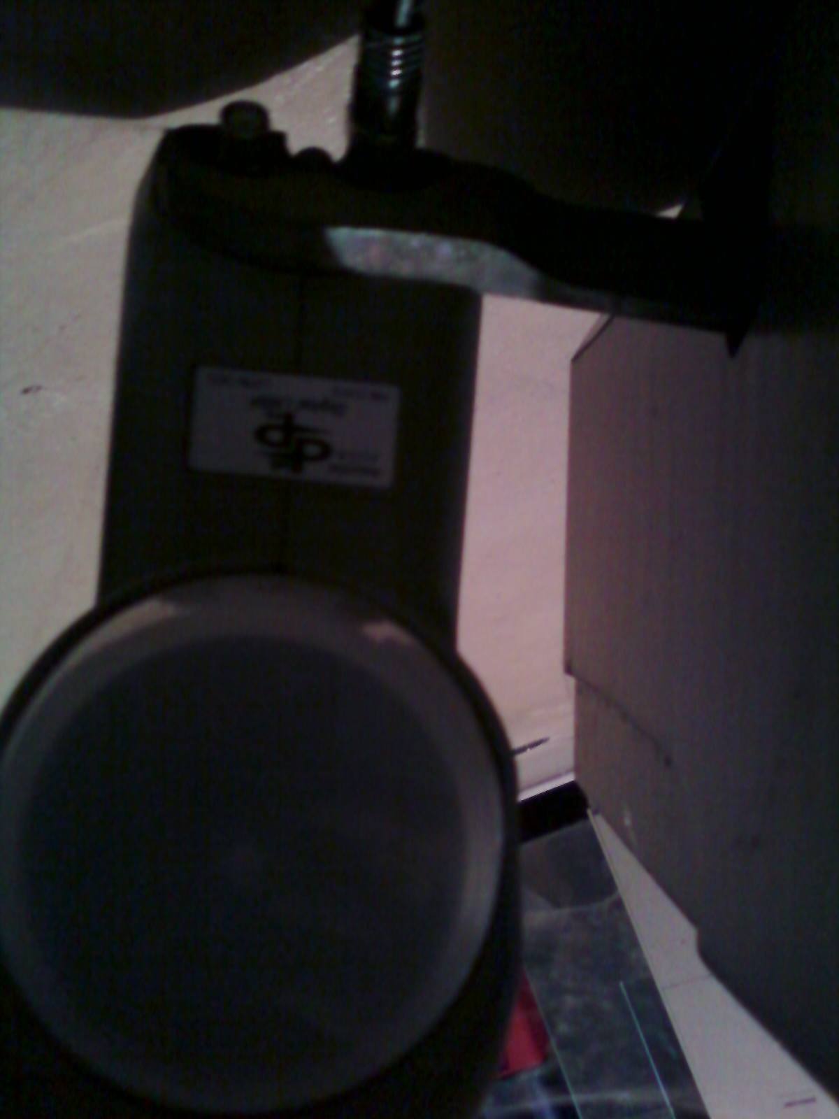

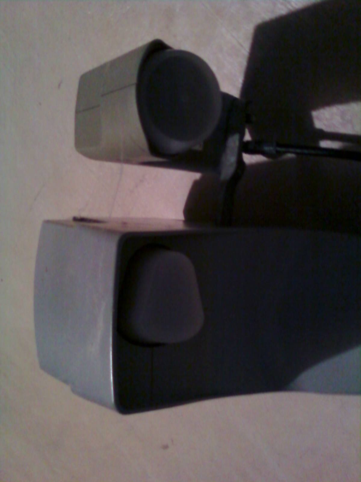

Just recently, I was offered a Super Dish for free, so I thought it would be a good challenge to see what I'm getting into without a tremendous cash outlay. From what I've read in other threads, it sounds like if I have a linear LNB, I should be able to pick up some of the stronger Ku-band transponders. I'm not sure if any of the LNBs on the dish currently are the stacked Ku-band LNBs talked about in the other super dish threads. It looks like I've got one, but I'm not certain. Hopefully someone can tell from my poor quality cell phone pictures.
EDIT: The LNB with the tall oval feedhorn is the one to use. Should be marked with "FSS" and "10750". Thanks, Anole.

you have a SuperDish for 121 west
The LNB you'll use is the one with the tall oval feedhorn, under the big cover.
It has a dog-leg pipe back to the LNB, which is marked with "FSS" and "10750"
Just ignore the other LNBs for now - no need to remove 'em.
