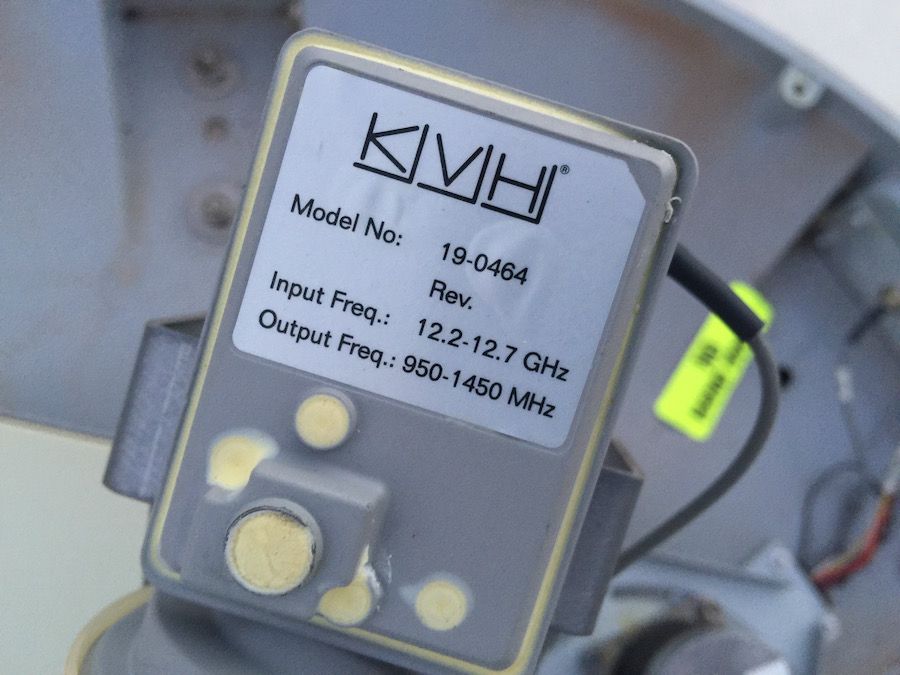

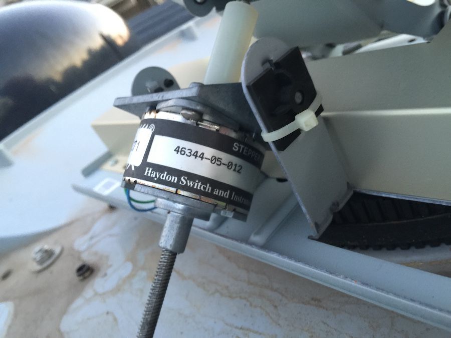

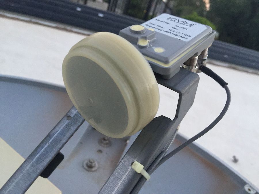

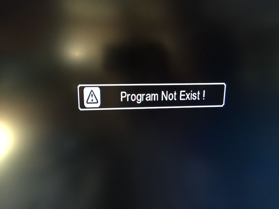

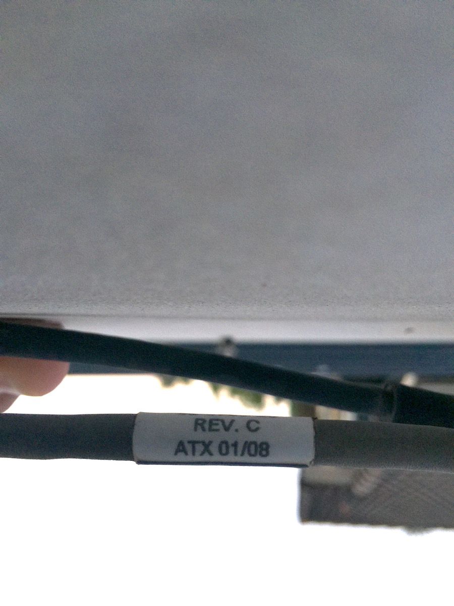

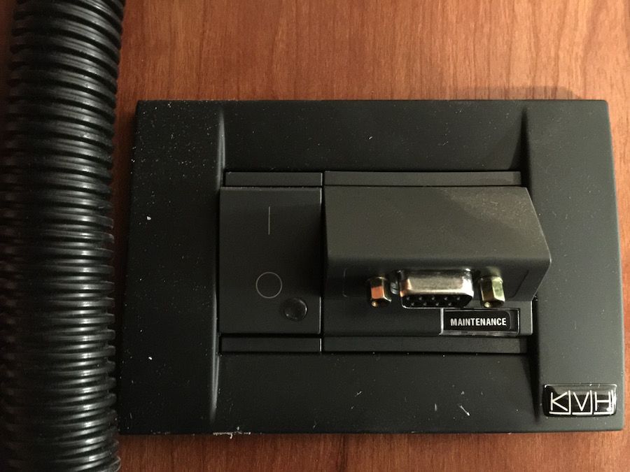

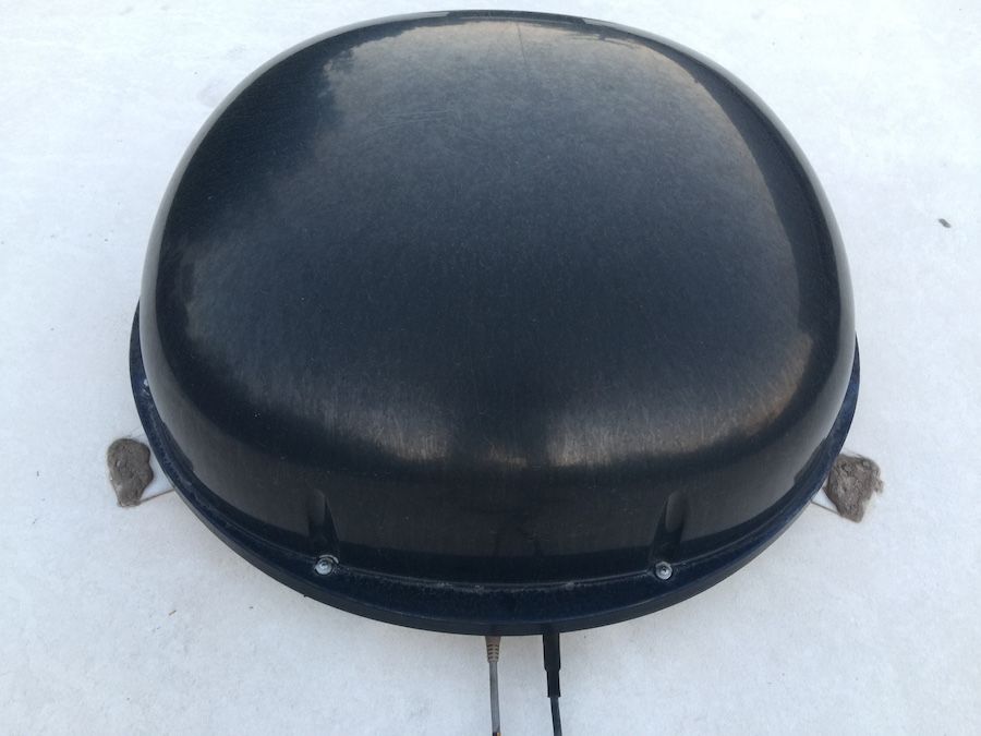

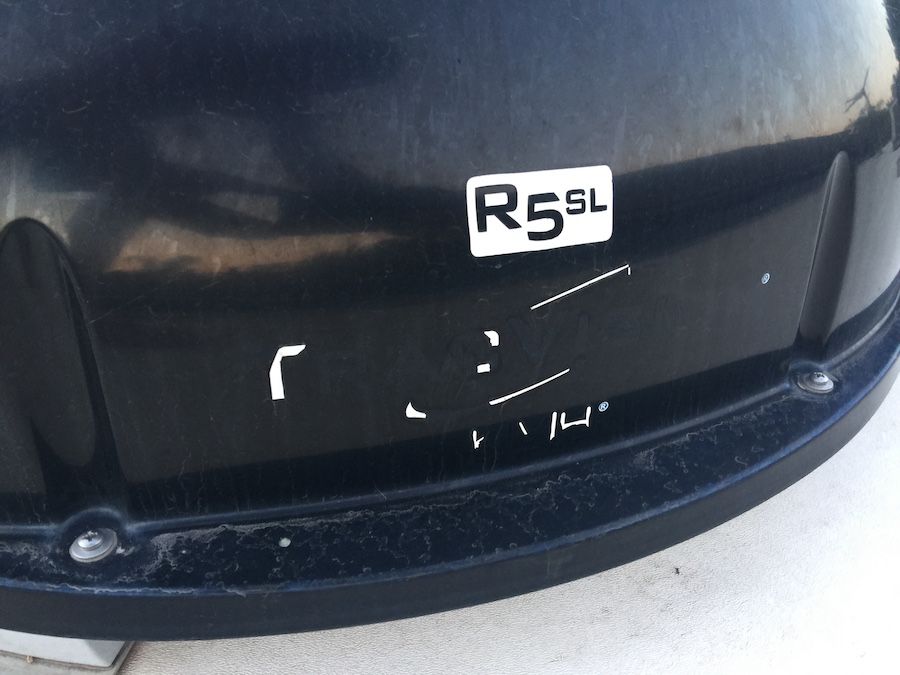

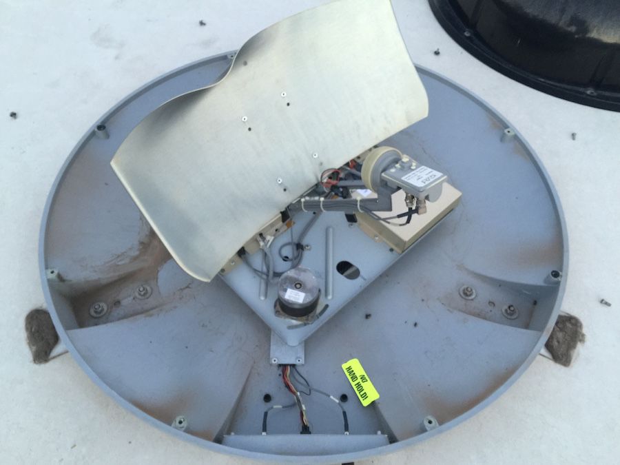

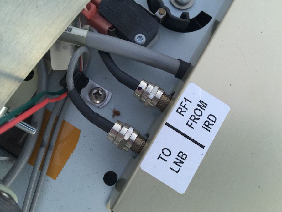

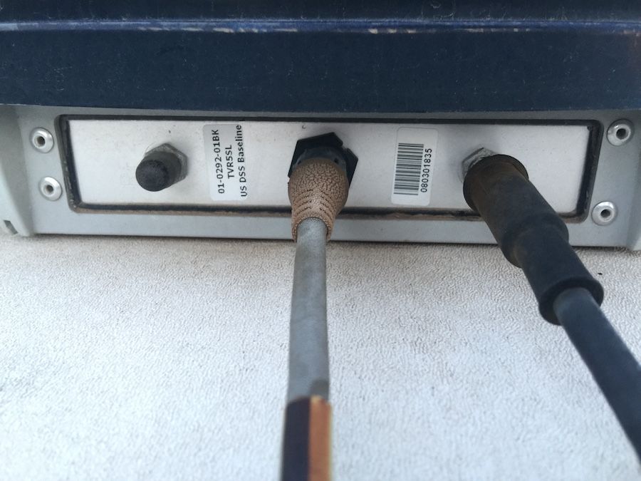

We just bought a 2008 RV/motorhome and it came with a KVH TracVision R5SL Satellite. While I was looking around at Dish and DirecTv rates I came across FTA. Im very tech savvy but I dont know much about satellites so i'm struggling a little. I bought an X-Squared HD DVB-S2 / M1HD FTA Receiver on Amazon and I can't figure it out.
My question: Is it possible and/or what do I need to do to make these two work together? I'm ok with buying a different receiver or altering the dish.
I have also attached many photos to help out.
Thanks to everyone in advance for any help. Much appreciated!
:helpsign
SATELLITE:
KVH TracVision R5SL
RECEIVER:
Note: I tried adding some links to the manufacture pages of the satellite and receiver but it was flagged as spam. Install guide, user manual, files page, etc

Your receiver should be ok, I don't own one but several here do and like them.
As far as the dish...the one you have is way to small for FTA. It would work fine for DISH or Directv, as they pump out WAAAY more power than most FTA signals.
I recommend getting at least a 90cm dish and you will have to get a linear LNBF to go with it.
