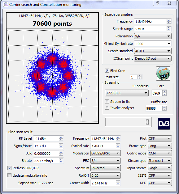

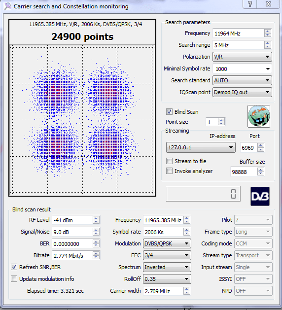

Here is what it looks like tonight from Toronto:
i have to admit, this one baffles me, i go from 75q to 0 and the sign comes up signal lost.
i actually am at a loss to see why. the dish is motorized, i can move it all around,
The Q is rock solid, no floating, then 0.
