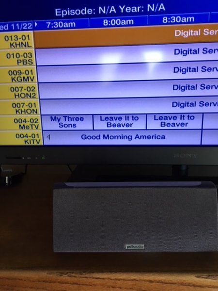

I may be mistaken, but I seem to recall reading once that the guide data for OTA is actually supplied by the local stations.
Here on Maui, I have a VIP 722K with OTA module. Our ABC affiliate has the guide data for both the main and subchannel. All the others simply say "Digital Service".
Local stations do provide guide data (PSIP via OTA) but Dish does not use that data. They buy the guide data from a 3rd-party (who it is currently I don't know, nor care, nor does it really matter). Whether it in turn matches up with all of the channels/sub-channels you can get is a whole different story.
The third party does get their information from the local channels. Dish decides which of the data to pass along. (I'm agreeing with you, just adding to your information).
