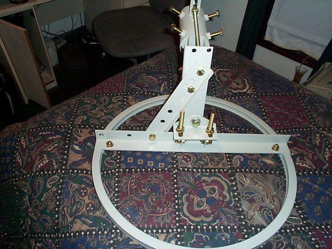

Mount don't seem correct
Someone look at this pic. I bought a polar mount 6 foot prime focus but I don't see hows it possible to attach a motor to this? Am I missing a part? OR is it put together wrong? :confused:
Does that one bar not belong? Maybe for a fixed position? The diagram I have looks like it has a extra piece going to the motor. Is that the bar flipped into a different position? The diagram is so small I can't really tell. :confused:
The bar you got hooked to the dish ring flips in the other direction and the actuator hooks to it and the dish ring the way you have it is for a stationary mount.:)
oh ok. I thought something looked wrong. lol. Thanks.
Hmm the bolt that came with my motor is bigger than the hole on the dish. :(

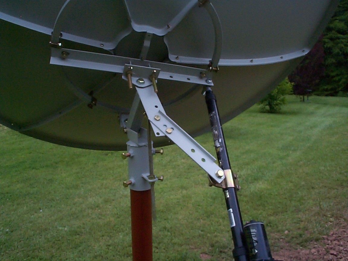

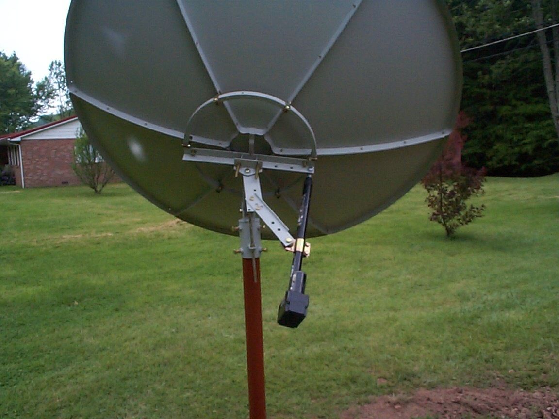

Ok this is how I got it on so far. I put the autuator arm a bit more than 3 inches from the top. It was the only way I could make it match what the diagram shows. Here are 2 photos. Does it look like its installed correctly? :confused:

Just glancing it does(all my expertise is with 8'up)... you may have to loosen the clamp holding the actuator arm and adjust ...
Looks like you're going for a western arc. I would suggest loosening the clamp and sliding the actuator down, so the dish will be pointing to the western horizon.
If you want an eastern arc, move the brace over to the other side, along with the actuator, and do the same thing, pointing the dish to the eastern horizon.
Humm... I'm in WV so I need Eastern.. East top of actuator on right site. West autuator on Left side. I thought.
The plate that attaches to supporting truss where I determine Polar angle. I am not sure how to flip that plate so it has a hole big enough for the actuator bolt. :confused:
I'm in between 2 hill sides so 125 W is the furthest West Satellite I can get. I hope I can get over to 72 W
Your setup is correct, just loosen the clamp on the Actuator and slide away from the motor so the dish is pointing toward AMC8 @ 139.
You're in the East. What you probably want to watch is basically from you towards the Pacific Ocean. That is a Western Arc. An Eastern Arc would be from you toward Europe.
