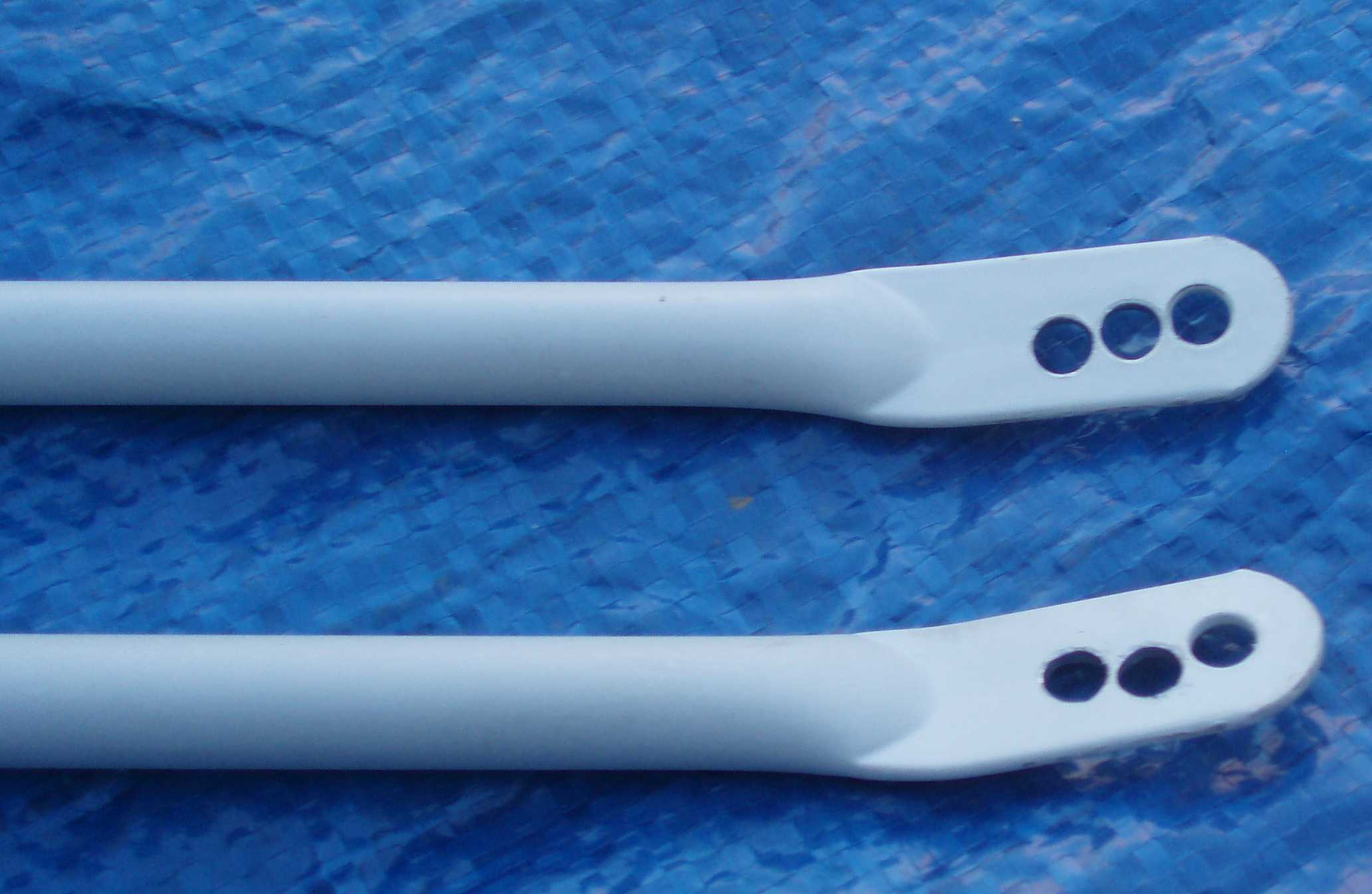

I decided instead of threaded rods for now, I'd drill a couple more adjustment holes in each arm, with a sliver of metal between them so that they wouldn't turn into adjustment slots.
I started with the factory holes and had 11.4 db s/n on my peaking signal at mid-arc (AMC-15). Going to the next adjustment hole on each side, I got to 12.2 db s/n and when I did my zero position dish push test (push slightly on the lnb holder arm channel metal), I only got .2 db more signal, not .5 to 1 db more signal like when using the factory holes, so I"m as close as I can get with the second adjustment hole unless I did threaded rods to squeeze out that last .2 db s/n.
I went to the third hole and got to 10.9, so I know that's worse than the factory hole or my second hole. I"m going to keep my holder at the second adjustment hole (12.2 db) and not worry about threaded rods since I'm only going to gain about .2 db more signal maximum.

ok, here is a pic of my non-threaded rod mod. It's the dish end of the arm - one of the three holes is the factory drilled hole, I added the other two on each arm. The attachment on the LNB arm (that end not shown) stays the same, so it's bolted to the LNB arm using the factory hole.

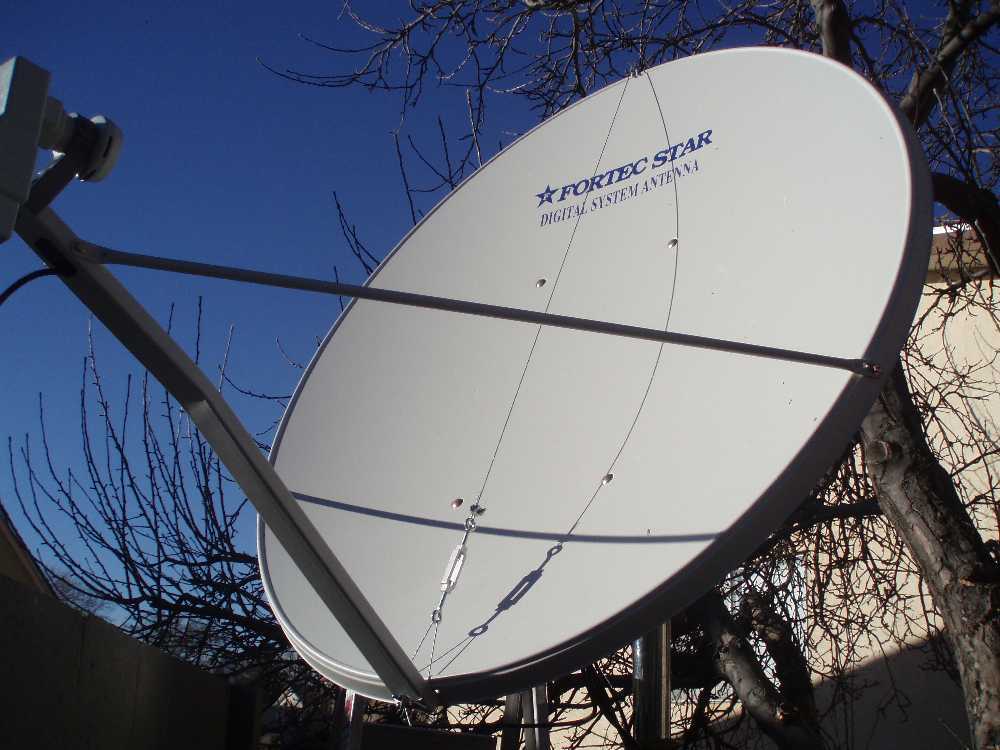

I couldn't leave well enough alone. I've documented how the LNB holder rods in the factory drilled hole position gives 11.4 db s/n on my AMC-15 peaking signal. I have documented how drilling some extra adjustment holes and using the second one bumped up the s/n to 12.2 . Today, I decided to see if my push test was in fact not related to the side LNB arms but rather a deformation in the up/down axis of the dish.

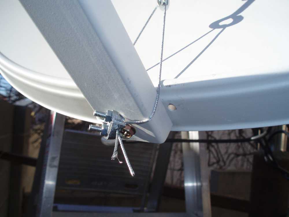

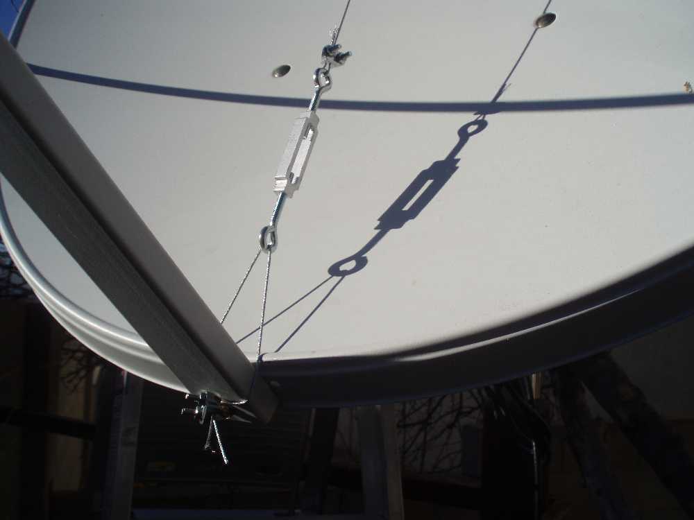

I took some guy wire, clamps and a turnbuckle that I purchased for use in de-warping a 10' dish (haven't gotten around to that project yet). I used the hole already in the top of the FS120 cm dish to attach one end of the guywire. I put a turnbuckle in-inline towards the bottom (to keep it from blocking too much signal plus to make it easier to adjust while standing on the ground) and I put a loop around the LNB arm at the bottom to the bottom part of the turnbuckle.
I adjusted the turnbuckle and got to 13.0 s/n, a .8 s/n improvement. I did my push test and got no further improvement, so I think I've done all I can now to get the most signal possible. The LNB arm thing appears to have moved the LNB part into the sweet spot instead of being just low of the sweet spot and the mod I did today appears to have fixed whatever warp or issue existed in the up/down axis of the dish.

pictures of the dish, of the turnbuckle/lower dish, and the clamp showing how I attached the lower end of the modification.

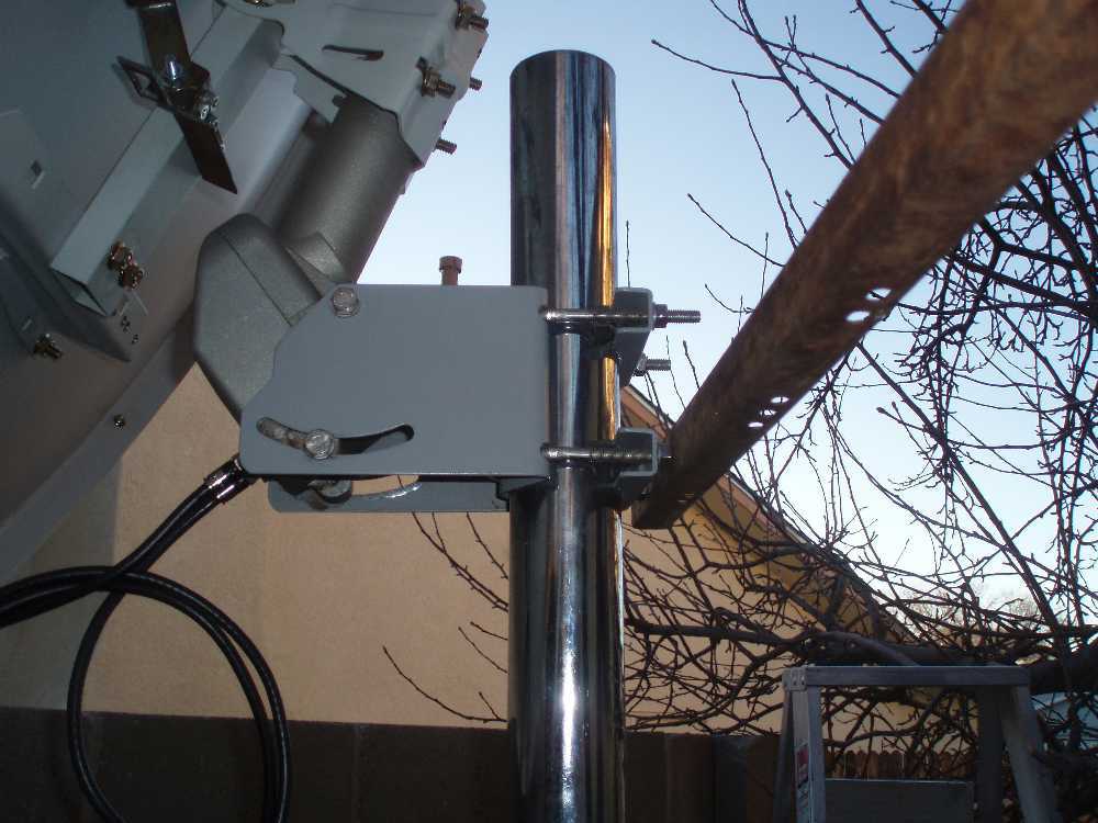

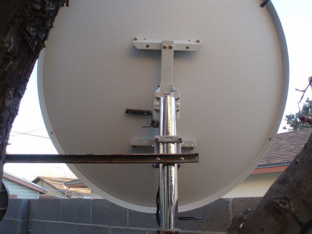

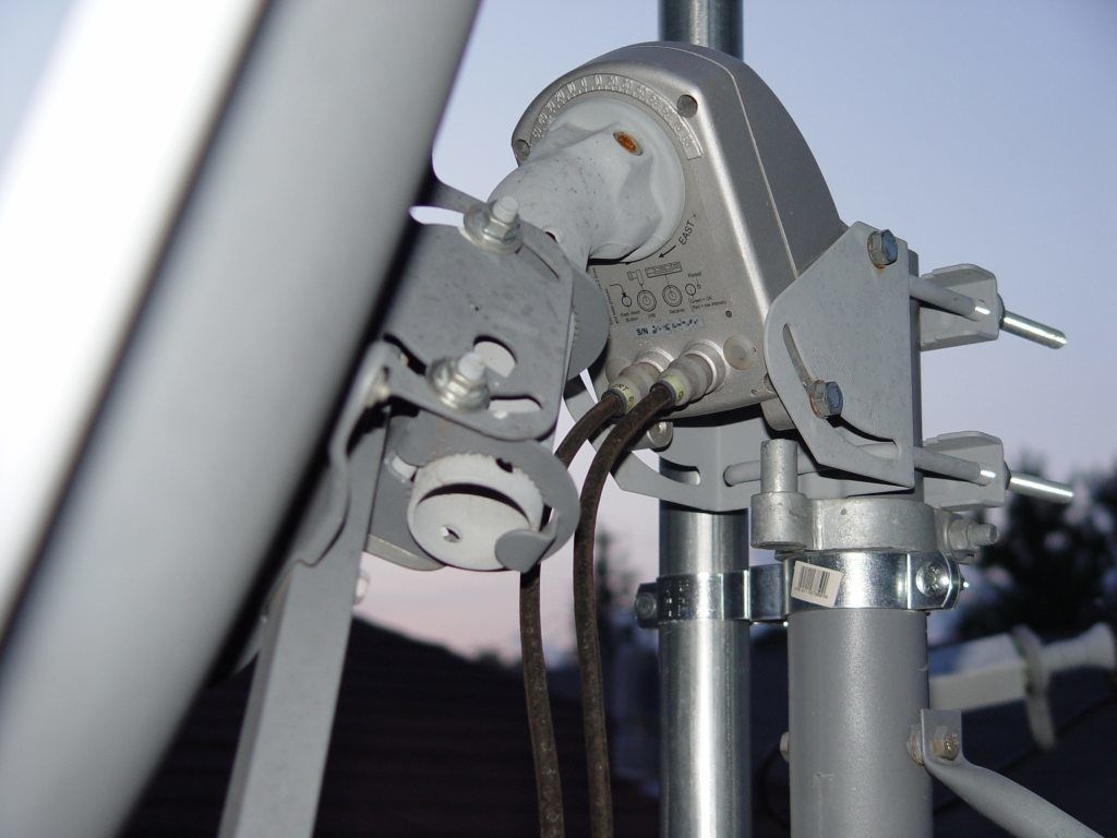

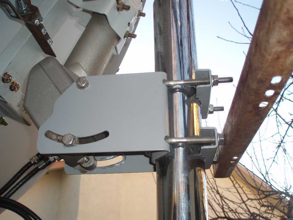

and here is a quick and dirty mod for a azimuth cheater bar to give one more leverage and precise control when rotating the hh120/fs120cm combo about the mounting pole.
I am off on the arc quite a bit (getting down to about 93 deg W to the east and satmex 6 to the west before my arc really falls off, when my center is 105). I did tests on G26/G25 K and SM6 K and found out I was high on one side, low on the other. I read the hh120 fine tuning instructions and it told me I didn't need to move the dish about the hh120 pole, but rather move the hh120/dish combo about the mounting pole to try to fix the misalignment I was experiencing.
I don't like to loosen the U bolts too much, since the dish/motor is top heavy (and thus looks at a slightly lower elevation when the u-bolts are too loose). With the bolts barely loose to avoid elevation issues as best as I can, the hh120/dish is really hard to move with any kind of precision. I don't want to grab the dish and rotate because I'll probably break the hh120 motor from the stresses of doing that.
I figured I would build a cheater bar to help me with more leverage and to be able to rotate the combo about the mounting pole in finer increments. I found I should be able to run the bar across the bottom u-bolt holes so I took a piece of channel and drilled a pair of holes so I could mount it. I found the nuts on my yet-to-be-reinstalled fs90 fit the ubolts perfectly so I used those to secure the bar to the extended lower ubolt part.
It seems to work great. I hold the signal meter with one hand, hold the bar with the other, and it doesn't seem to take much effort to pull or push on the bar to get the dish rotated just where I want it and then tighten down the upper ubolt. When I grabbed the motor with one hand, held the ubolt extension lengths in the other, and rotated it, I would get jumps of several db s/n or lose signal easily by moving things too much too quick. With the cheater bar, I am able to make moves within a tolerance of 1 db, so definitely it is much more finer control as I dial in the highest s/n signal that I need. After I tighten down the top ubolt, I remove my cheater bar and tighten down the lower ubolt and I'm at the configuration I want at the time.
