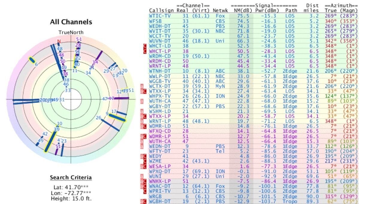

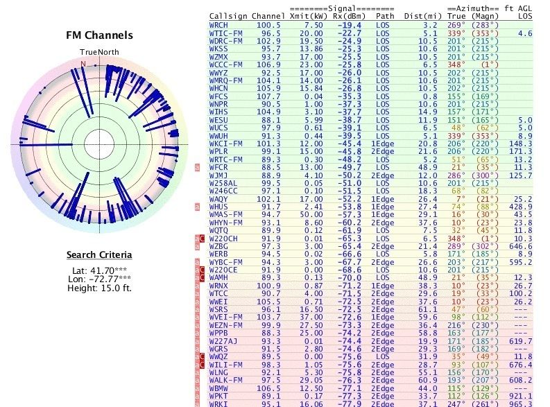

Just in case, here are my TVfool and FMfool:

For TV keep your DB8 for TV only. Its a good antenna for your situation especially if you could pull in the UHF duplicates of ch 10 & 11.
I second a separate discone antenna for the SDR. Your FM stations are spread out over 360 degrees so a directional FM antenna will have to be turned for different stations. The discone is omnidirectional and will receive a broad range of frequencies. You can even use your SDR as a police scanner with the plug in software and the discone.
