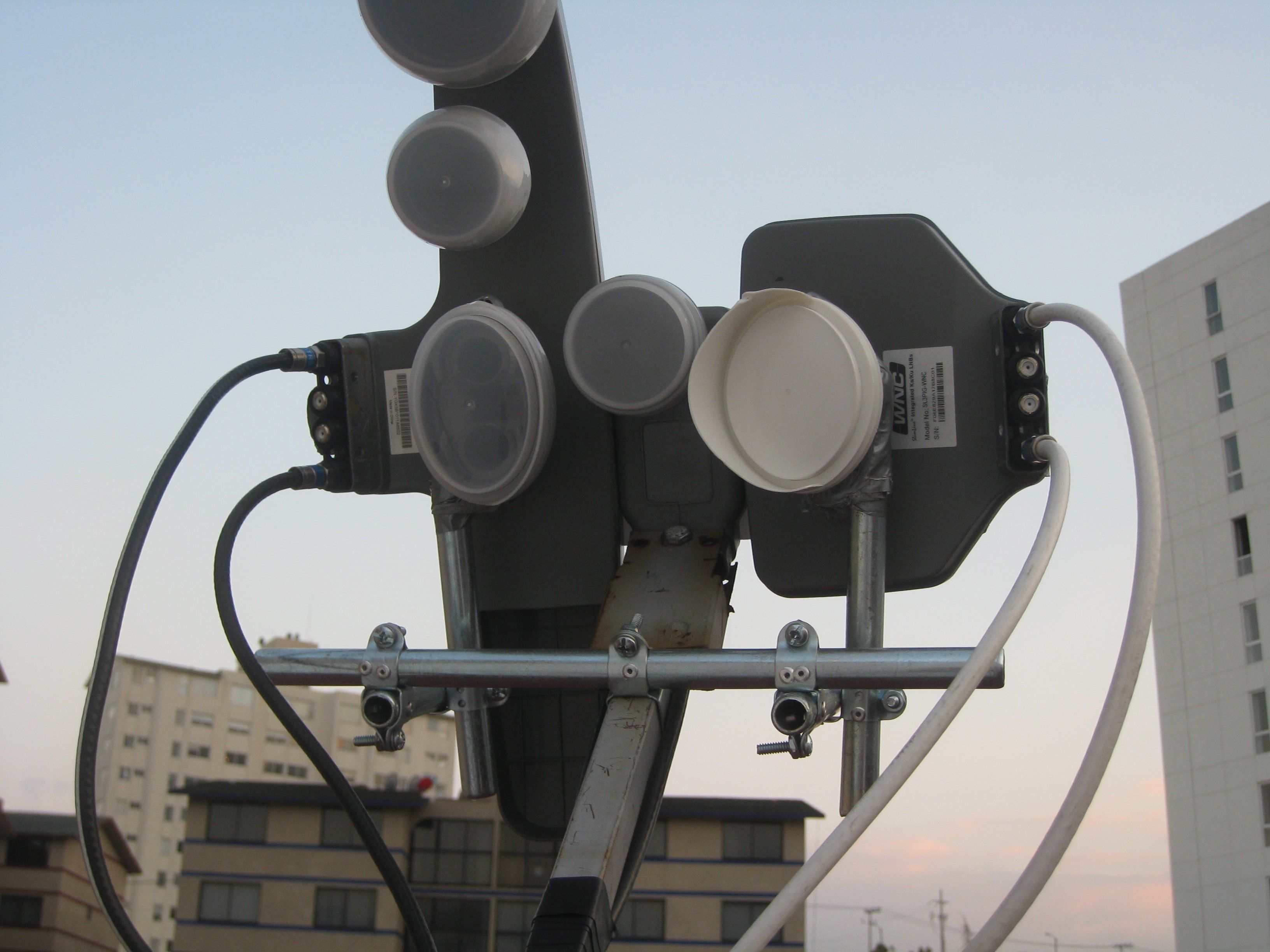

OK Finally I have an acceptable configuration and working.
Have 1 2.4 Mt dish with 3 LNBs on the same focal point. The 101 is downloades via an eagle aspen dual LNB Ku installed at the focal point (odd/even). The 99 is downloaded via a SL3 parallely attached on the right. The 103 (cb/ca) is downloadable by SL5 parallely attached to the left. The attachment is via a special bracket customized to the dish.
Signal on 101 odd/even all above 65 most of the time. I only loss 17, 25, 27 & 29 for like 1 or 2 hours in the night.
Signal on 99 (c) odd/even all between 45 and 70 all of the time.
Signal on 103 (cb) odd/even all between 50 and 70 all of the time.
Signal on 103 (ca) odd/even all 0 all the time (for now)
2 cables from SL5 goes directly to port 3/4 of the Zinwell6x8
2 cables from KA LNB and 2 cables from SL3 are joined via 2 amplifiers and 2 combiners and the resulting 2 cables going to ports 1/2 of the zinwell.
No signal loss so far and everything is pretty strong.
I will be trying an additional configuration for the 103(ca) by using a DTVHAKAKUKIT only for 103 (Cb+Ca) on a single 1.8 mt dish at the focal point of the dish. In testing, was able to download all 103(cb) above 40 and atleast 8 transponders of 103(ca) above 20.
I will update if I get it done and working.
Anyway wanted to thanks everybody for their help. Would not have been possible without this forums help.
Thanks All

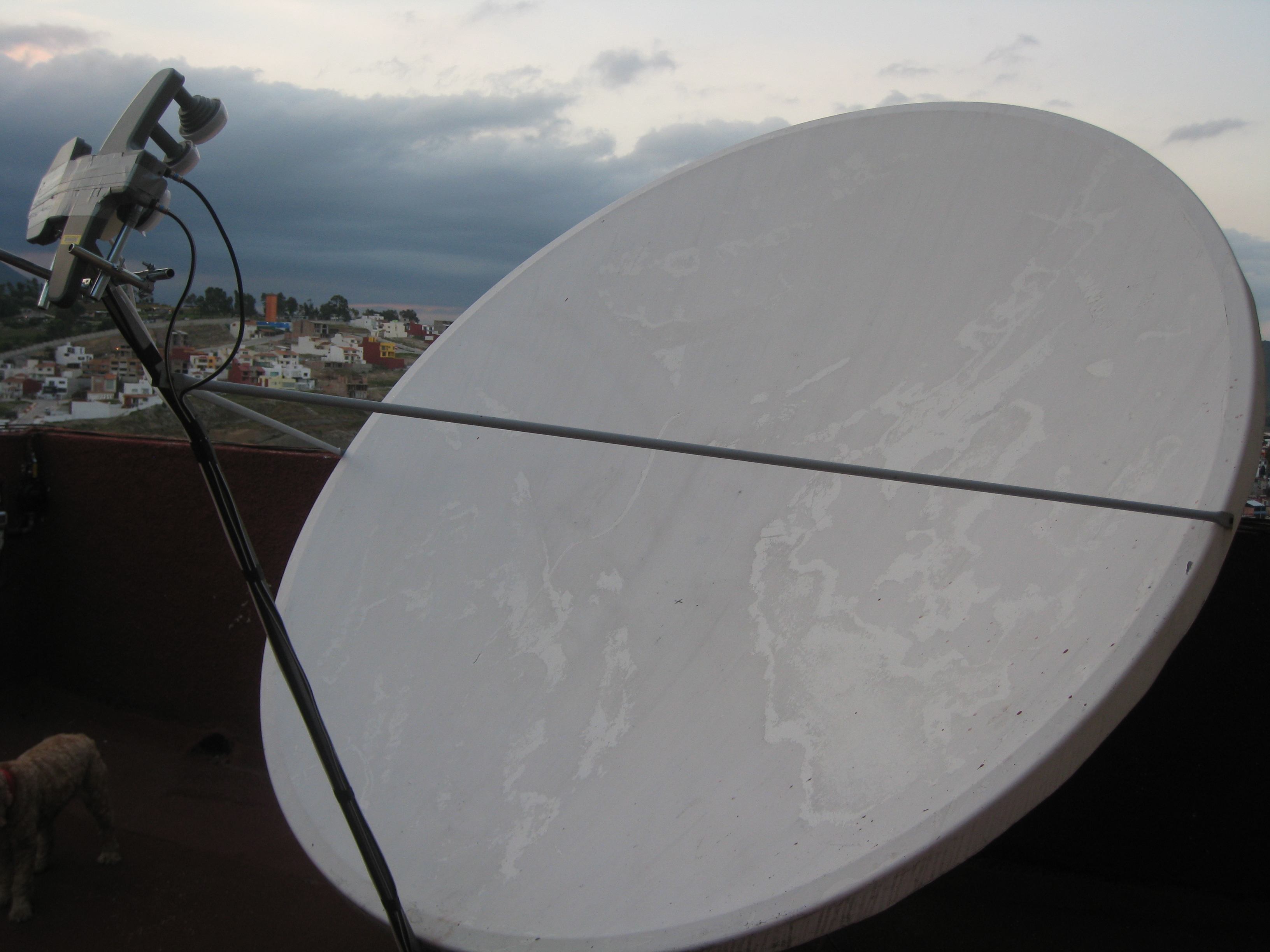

Some PICs
It´s interesting to see the lnb´s are next to each other, and we´re talking 2 degrees separation in a 2.40 mts in Mexico City. (I´ve would assume a greater separation than that).
The dish I have is really a clone of Master Channel not very perfect on the surface...that is the reason u have to customize the bracket depending on how accurate your dish it is built.
Getting the focal point for each LNB is very hard and u have to play around....Lets just say the the SL3 and SL5 are getting it in a "bounceback" since they are not at the center of the dish focal point. Only 101 is.
That is also the reason I was not able to get 103 (ca) according to my testing in this configuration.

For the 101 it is a dual Eagle Aspen KU
For the 99 (c) it is a SL3 Zinwell
For the 103 (cb) it is a SL5 Directv (I think made by Zinwell)
101 and 99 interconnected go to port 1 and 2 of multiswitch Zinwell wb68 wide band.
103 goes to port 3 and 4 of the multiswitch Zinwell wb68.
The dish is a normal master channel clone dish bought locally.
The cable is normal rg6 shielded. Cable distance is approx 50 meter with the zinwell placed at approx 30 meter down from the dish. No power inserter has been needed for my configuration so far.
As I mentioned getting the focal points requires a lot of time. On the average it took 6-7 hours to properly find the signal, adjust the brackets and peak the signals at 103 and 99, after 101 was locked and peaked.
Hope this helps.
Good Luck
