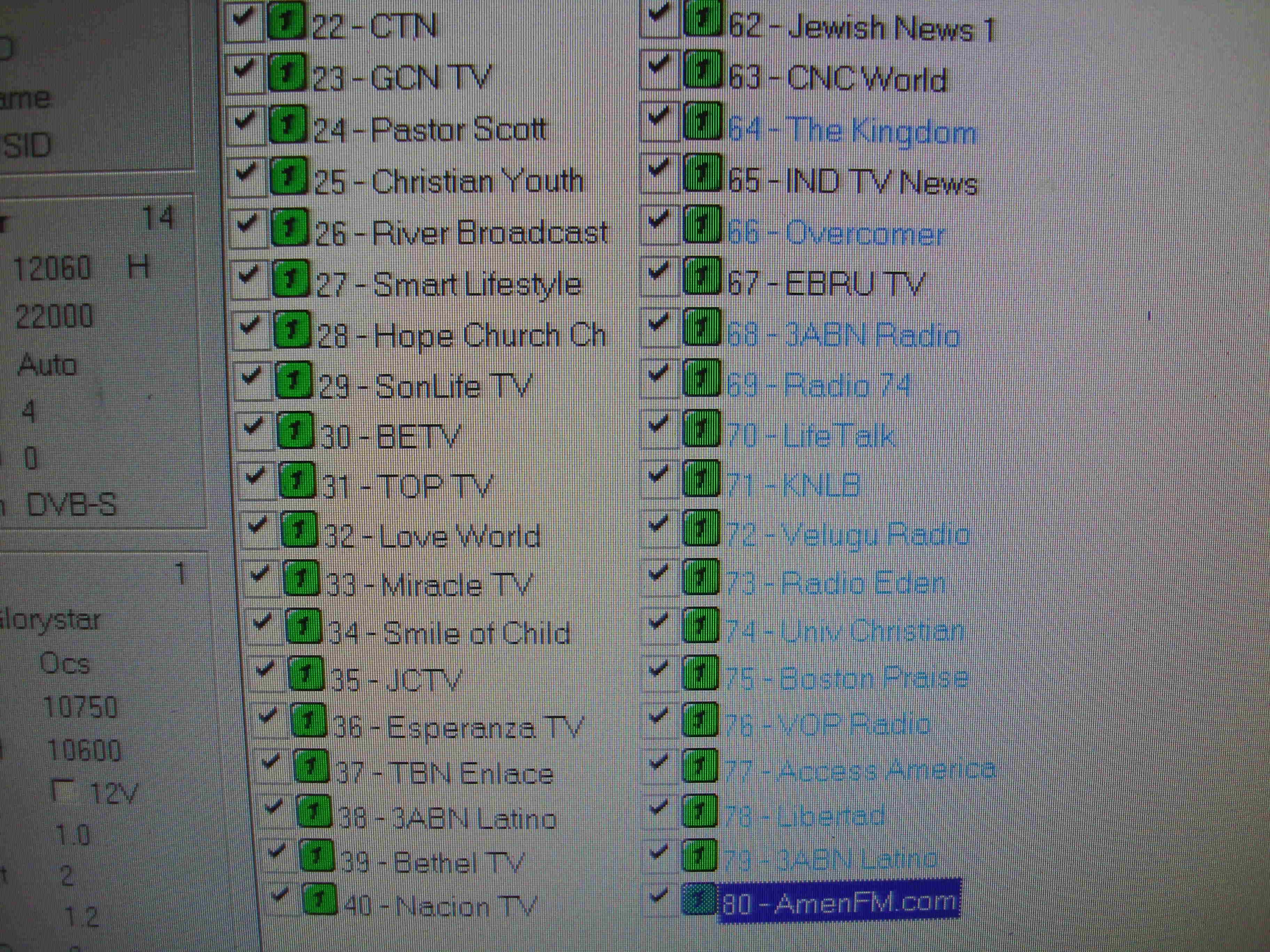

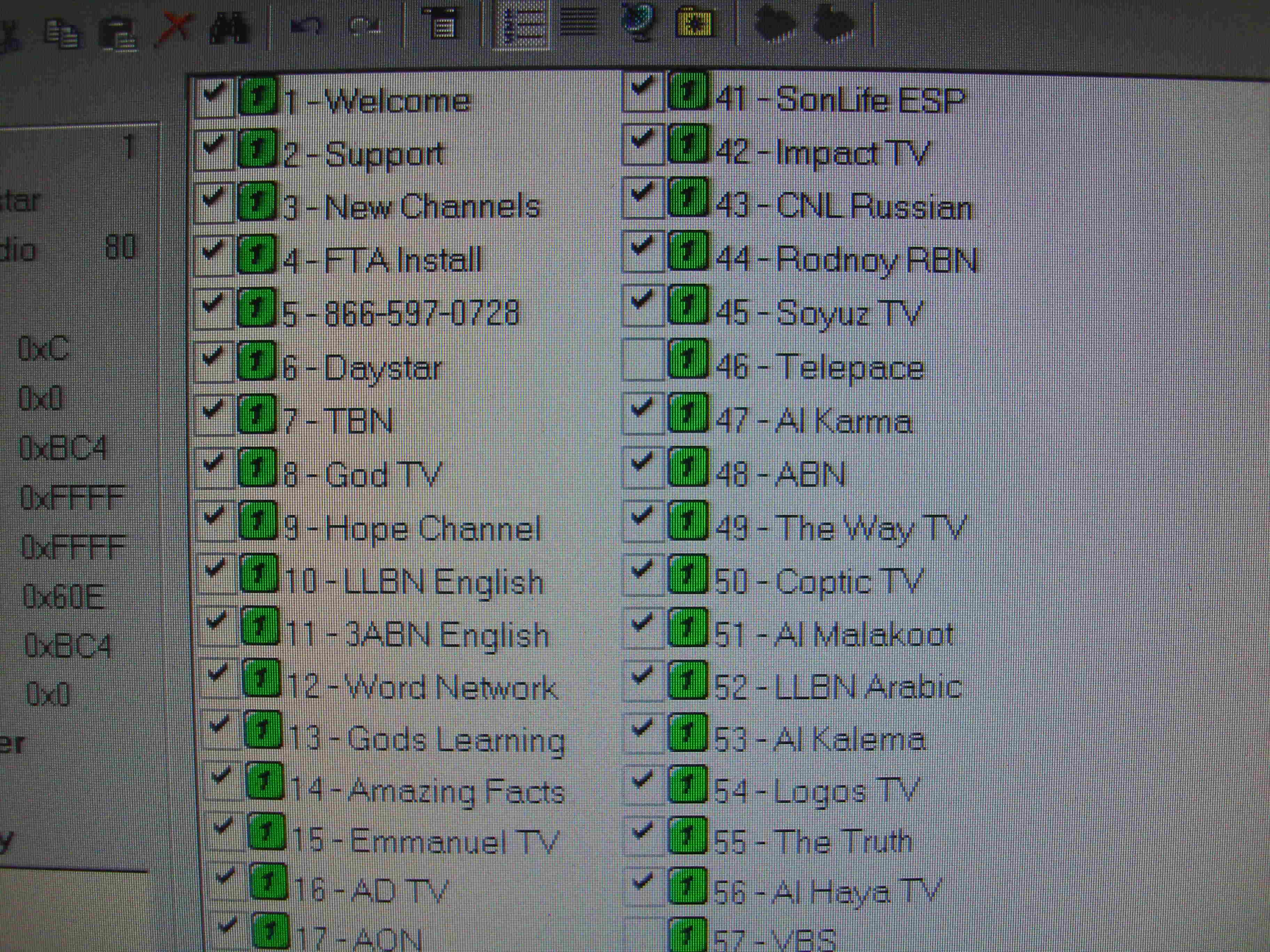

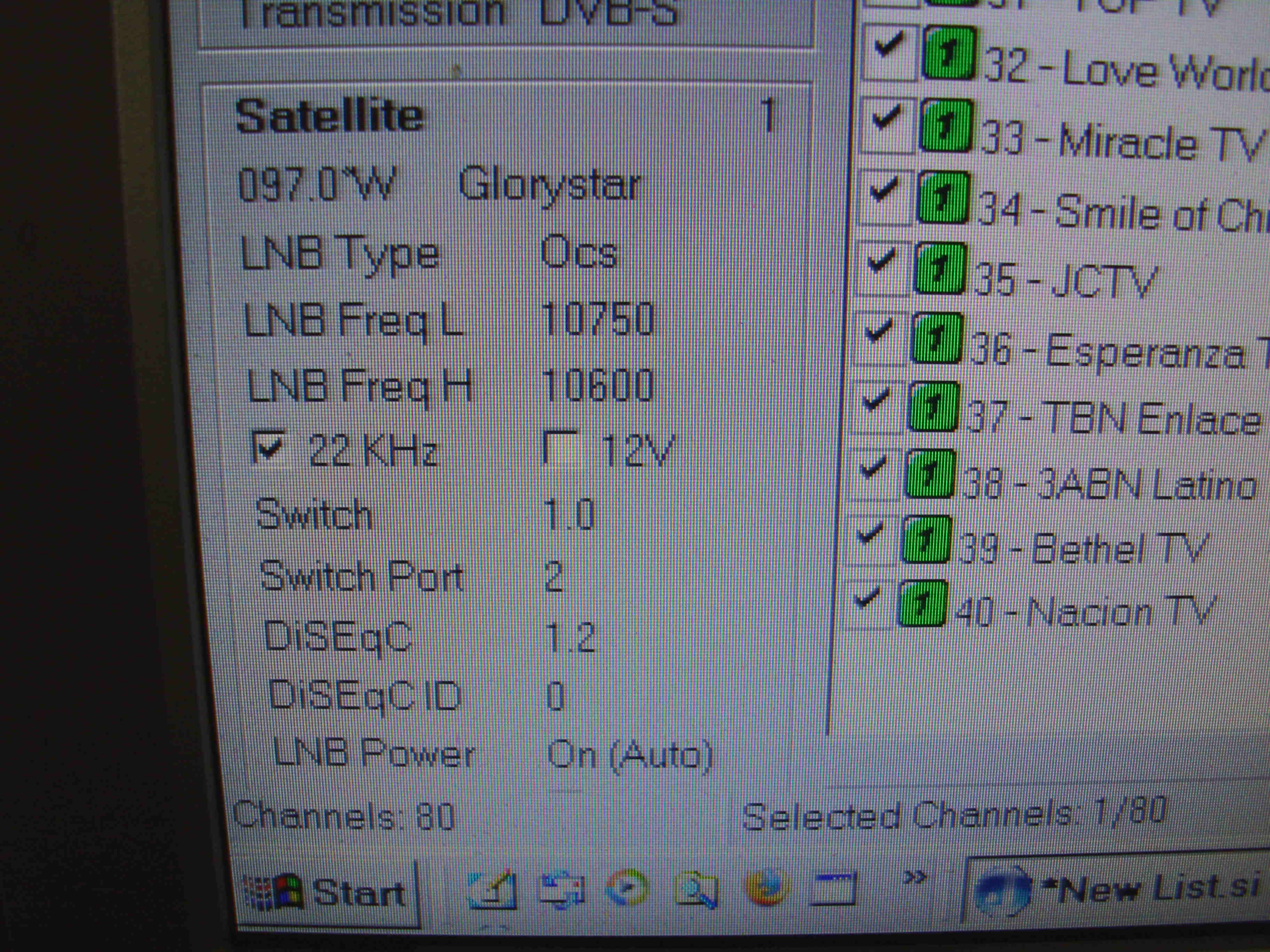

Brian here are some screen shots
I just took my original Glorystar file from the 200 and imported it. This is what it shows
(sorry if they look crummy. These are from the backup computer I have that has that editor, channelmaster and a RS232 cable ;) )

Iceberg,
I believe that the error was in the export of your file from MES. The user is presented with the option to only include selected channels during the export. If you were to exported a .udf file based on the last photo and include selected channels, only Amen radio would have been in the channel list.
hmmm...thought the checked ones would export over
But I really dont use the editor much so I'm just going out on a limb here
