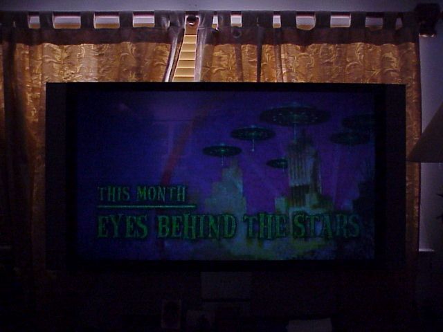

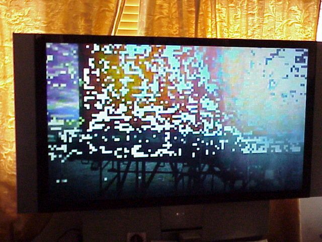

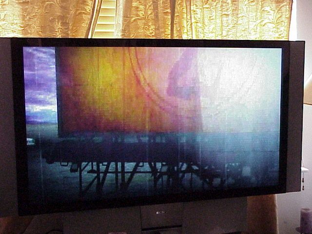

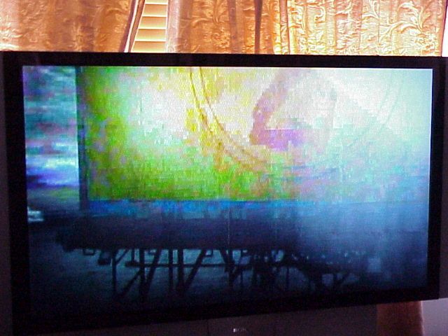

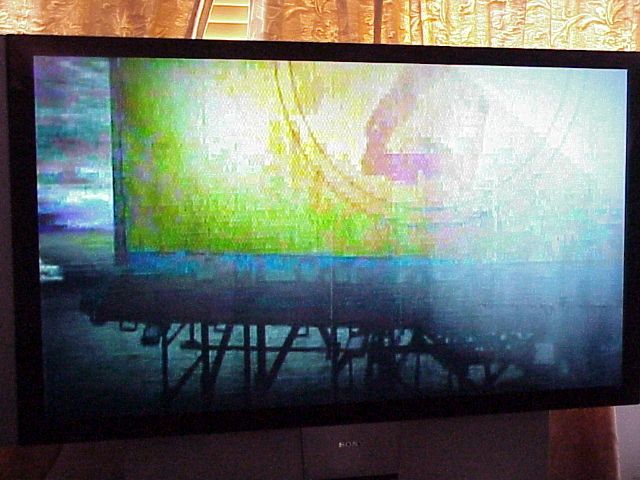

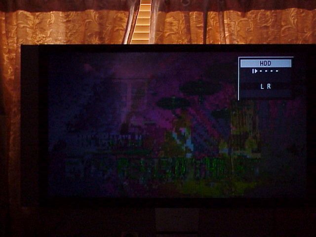

A lot of users have posted or described the PQ problems we are currently seeing of VOOM after the Harmonic Encoder upgrade was done. I thought it would be good to posts pictures of these problems. I am posting some pictures to illustrate my points. First, I am taking these pictures off my Sony GWII. My stb is set at 720p and using DVI. The native resolution of the TV is 768p.
Methodology: I recorded a segment of Monsters HD. I recorded this to my HS2 Panasonic DVD recorder through composite of the Motorola STB (VOOM) and input to the HS2 composite input. My HS2 is connected through component to my TV. The HS2 upscales to 480p and then the TV upscales that to 768p.
I know what you will say a lot of scaling up/down but I checked back to the image I saw in the DVI input and the DVD recorded the artifact of what I want to explain.

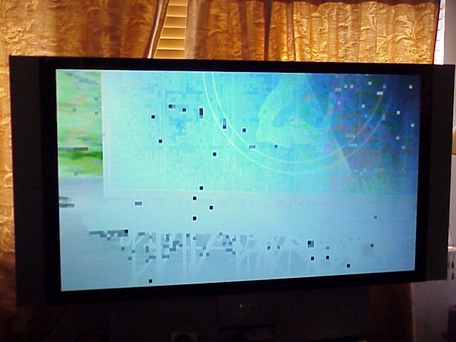

Frame Fading/cutting Artifacts (Blockiness - seen during dissolves and fades) Whenever a still or moving picture cuts to another frame as it is fading the picture pixelates and one can clearly see the macro blocking in the picture.
The picture posted is from a Monster HD frame. I tried to take frame by frame as much as could to capture each frame. These are not second by second frames. I skipped some but I believe it illustrates the microblocking artifact at the end of the frame. Understand that this a poors man design to illustrate the point and that the upscaling/downscaling process can insert its own artifacts as well.
The last pictures becomes very blocky as it finishes the fading and the new frame replaces it. Also as the fade is happening there is lots of grain (best word I can use to describe it) that the picture does not reveal.

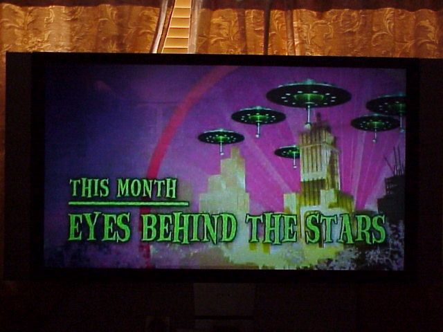

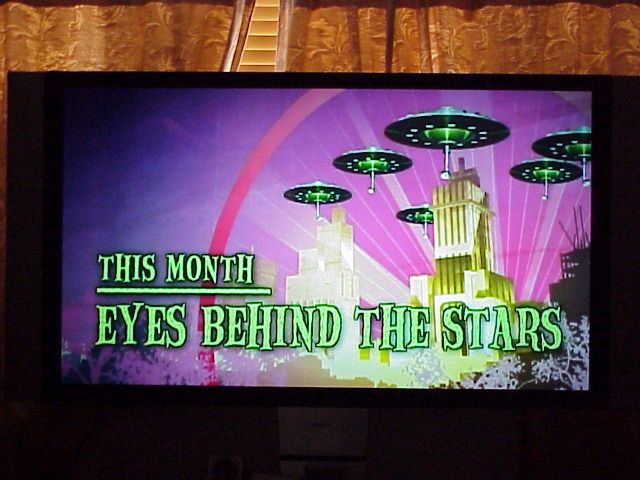

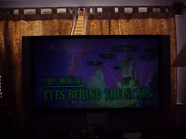

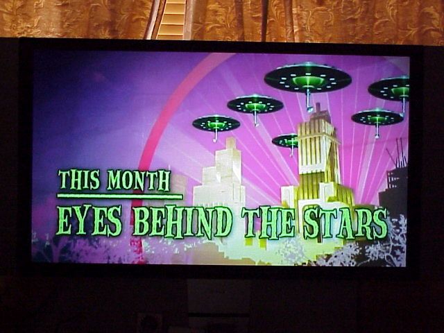

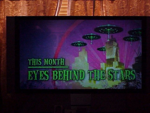

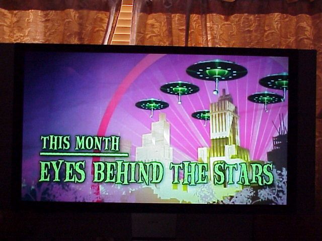

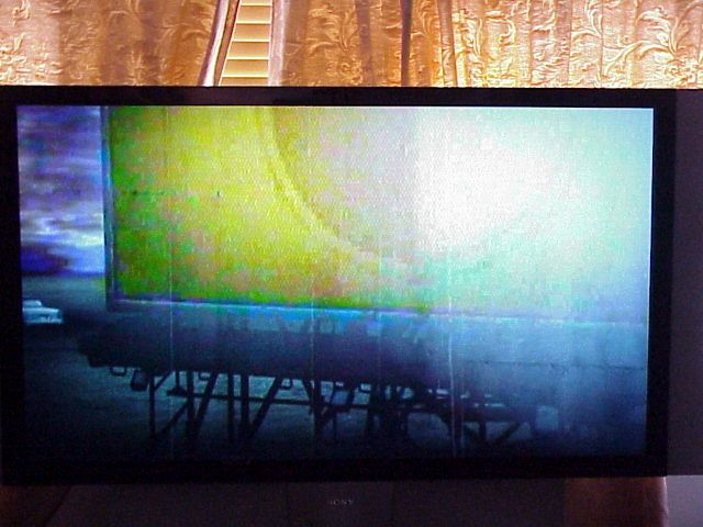

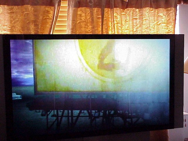

Flashing Lights Pixelation. These I took from Monsters HD using the same methods. This is good graphic which happens to be part of the same graphics I took above. This one flashes lights on a billboard. The flahes pixelated a lot and the macro blocking were obvious.
I am not advocating that VOOM is like this all the time. I am taking frames that are very subscetiple to artifacts. If the picture does not contain flashing lights, it looks pretty darn good but when the flashing lights do happen, the problem is there.
