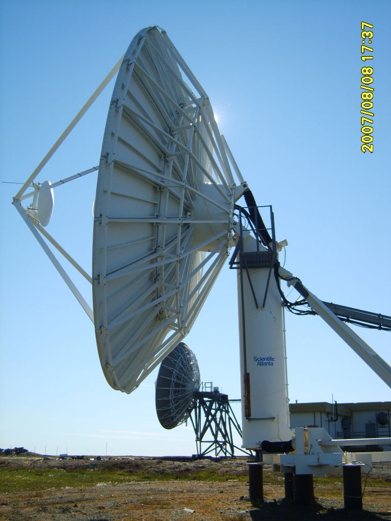

(pokes head in)
How close to the horizon is it reasonable to receive a (video) signal, anyway? Assuming nothing's in the way, but air.
I'd love to get something with the BBC on it, besides BBCA on DirecTV. :rolleyes:
Very close to the Horizon is possible, it is standard practice in Alaska, below 10 degrees or so it gets iffy. Dishes tend to be larger though.
