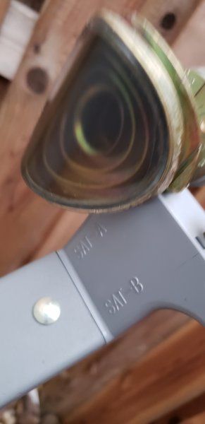

This channel master dish came with a dual lnb bracket and one lnb. The bracket has labels of lnb A and lnb B. Which one would be the best to aim the dish with or does it matter?
Doesn't matter which side of the dual clamp is used. Neither position is in the sweet spot for the reflector, so there will be a slight loss. Remember that the dish will be aimed slightly off axis to receive the target satellite. Ideally, locate a single OEM LNB holder and scalar for optimum performance.

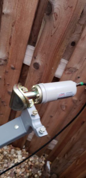

Here are the pictures I do not have the pole in the ground yet so the dish is not fully installed it's just sitting there.

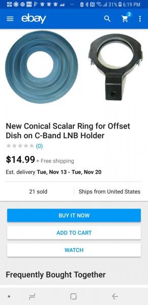

Would this work it came up in a search for 84e lnb holder. The one that says it's specifically for the Channel Master looks to be $68 or around there on most websites. that seems like quite a bit for a little piece of plastic I'm must there something else to it that time not seeing.
Does a scalar work on KU band also? I am somewhat new to this but I thought those were only for cband.

Looks like the unit shipped with the 84E correct scalar for that reflector design and FD. No, the linked aftermarket clamp and conical scalar are not correct for the 84e and designed for C-band.

One could modify the provided riser to place the single scalar at the correct height, angle and distance. Might pick up a few points and optimize. For now, I wouldn't worry about optimizing and just have fun! :)

Also the lnb holder bolt is in tight but the lnb holder seems to wobble when I touch it. Is this ok or do I need to do something with it.
The link would suggest that each output is voltage switched horizontal/vertical. No switch is necessary if the receiver polarity is set to auto (13/18).
The riser and clamp shouldn't be loose or wobble. Check the instructions/parts for correct assembly.
