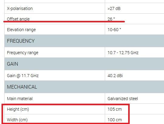

But...... I always like to make fun about Triax: This is one of the companies who make tricks on the market! Why?! Cuz they are not very honest to us. They like to sell smaller dishes for the bigger dishes prices. For example, if they write TD110 and say that dish is 110cm, that does not necessary mean antenna is so big. For an offset dish main size parameter is the width of it's working area. And working area of TD110 is only 100cm. So, this is not 110cm but 100cm dish. Same situation is with other their products.
The company gives a lot of data in data-sheets.... too much information for a simple user. here they also trick customers as not all information in those sheets is correct (maybe they themselves do not know what they write there!!). Example: for TD110 they write that it has working area 100x105cm and offset angle 26*. Somebody was completely drunk to write such a data?! :biggrin ScreenHunter_769 Oct. 19 06.53.jpg

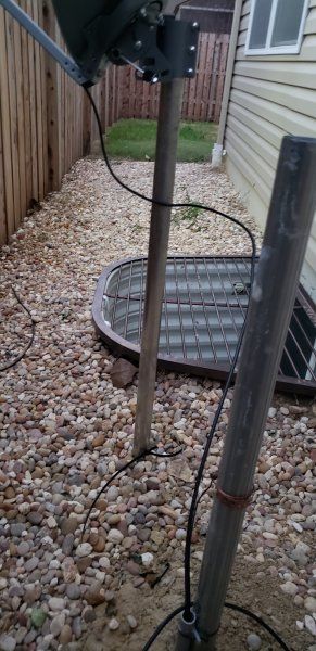

There is a 2 inch od pole in the ground already. Will either one of those dishes work with that? I have a very limited amount of wife approved space to put dishes so more than likely if that does not work I will need to dig it up and start over.
Reactions: raydio
The GSP dish takes a 1 5/8" diameter pole and the CM takes a 2 3/8". So you will need to change the pole out unless you fine one of the good adapters. The "clip" on adapters or trying to shim the pole will give you nothing but head ache. The good thing is, go to your favorite hardware store and get chain link fence posts! The regular ones are 1 5/8" or 1.6" The corner posts are 2 3/8". :)

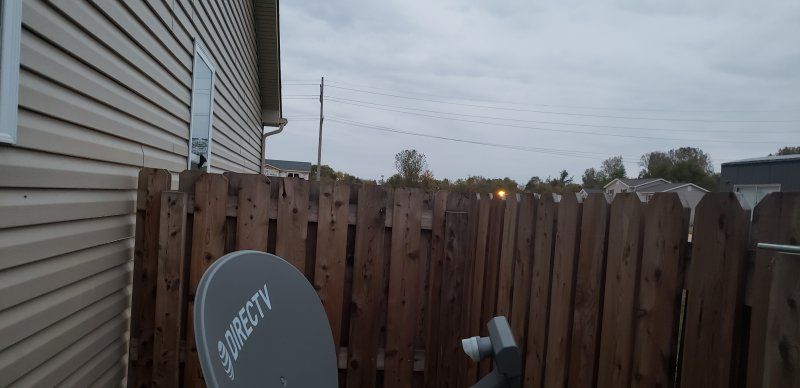

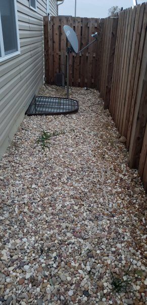

This is the wife approved area for dishes. There are already 2 poles in the ground and I might need to move both so I want to get it right this time so I do not have to move them again. Could this be done in buckets so I don't have to move and cut the weed barrier again or is it better to bury. Directv must stay but can be moved around if needed. What would be the most efficient use of space here so there would be room if I decided to add more dishes later if possible.
