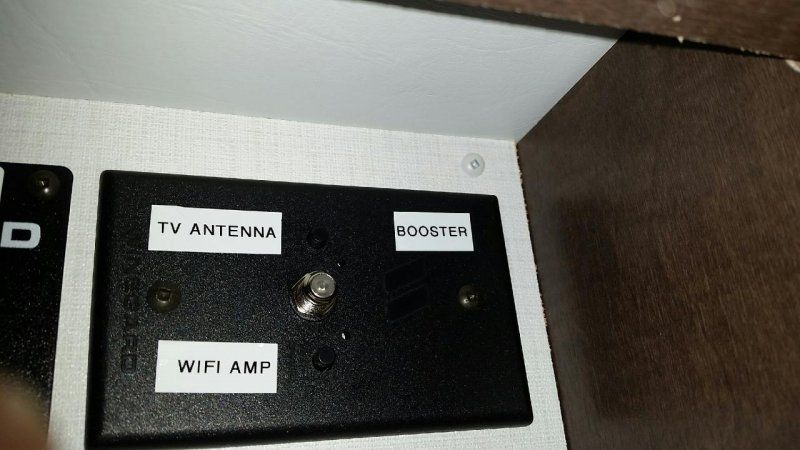

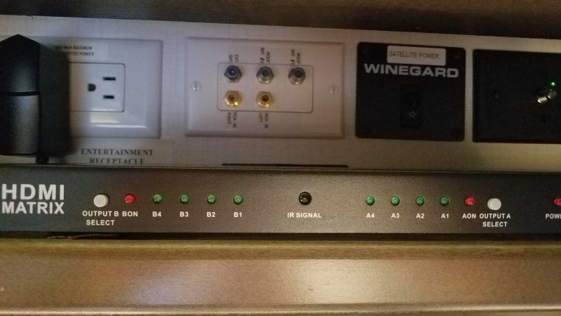

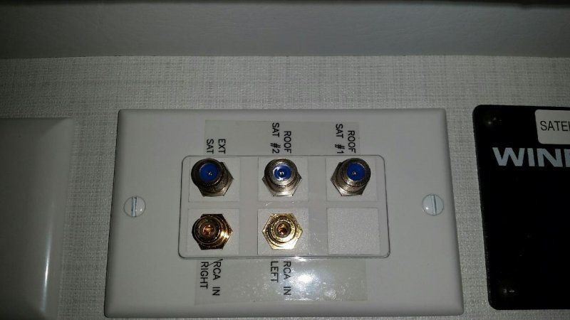

OK, maybe he won't be charged for them. There was no mention about the locals when we called and set up a new account. I am not sure if he has set up the MyDish on line account yet. I told him about it. When we were done had to call the DISH side of the the house to activate his EHD. CSR said no charge for that. We had an issue when we tried to install the OTA adapter so we are going to try it out again this week. When I installed it, it screwed up the second TV signal for some reason. His RV has the two Winegard switches and not sure if that had something to do with it. He is going to read up on the wiring schematic that came with the RV.
