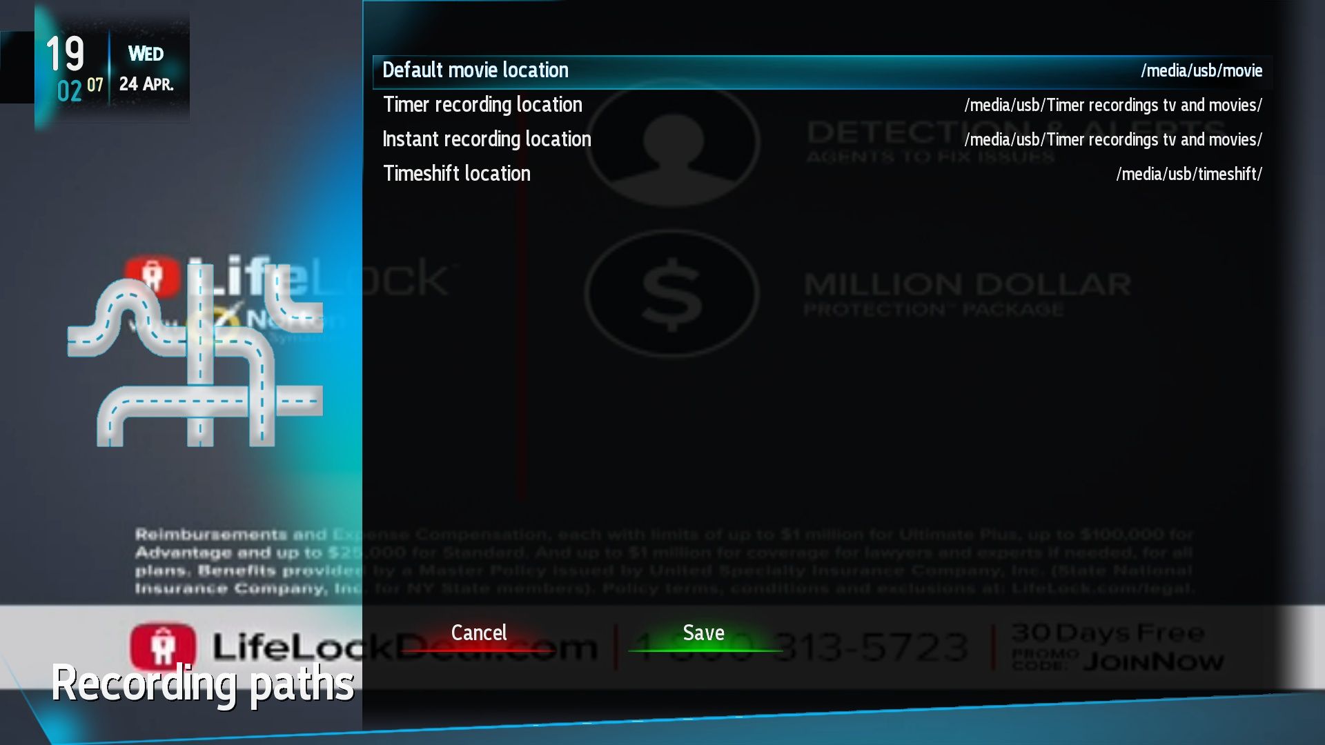

Menu>Setup>System>Expert settings>Recording paths
Scroll down and highlight Timeshift location and click Ok
Blue button remove bookmark and yes really remove.
Red button cancel.
With Timeshift location highlighted press Ok.
List of storage devices highlghted click Ok.
Where to save temporary timeshift recordings? /madia/usb/
green button OK Timeshift location should now be /media/usb/ and green button save.
SDA is right, sorry I was taking a nap. All recording paths should be set to /media/usb/WHATEVER FOLDER NAME YOU WANT

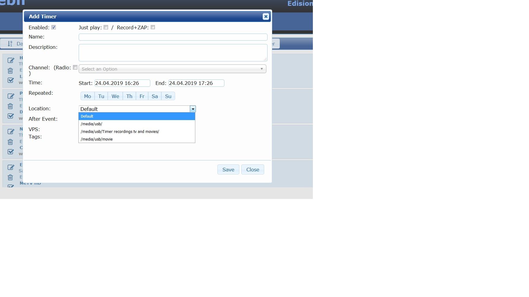

I have multiple folders, one for TIMER RECORDINGS, one for SAVED recordings (more or less permanent keepers), the default MOVIES (that's where most images auto-save), and /media/usb/timeshift for timeshift. I also have one called: /media/usb/imagebackups.
You don't have to do all that, but it works for me, and the WebIF lets me choose 4 of those separately, so I sometimes get creative when I set recordings.

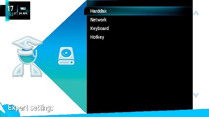

Follow Brian's post above. You can then hide/restore any option by highlighting it, and pressing the Yellow key, Then save by pressing the Green key.
Then go into "Recording Paths" and set them as you please.
Reactions: Psikic
In the Expert Settings munu, press the Blue RCU button to display the hidden options. :)
That was it! The options were hidden. And apparently options under many other menus as well :). I find it strange such an important option to enable timeshifting was hidden, but I'm sure they had some reason...

Never mind, I did some searching and found the answer. I had to change the the path from media/hdd to media/usb.
