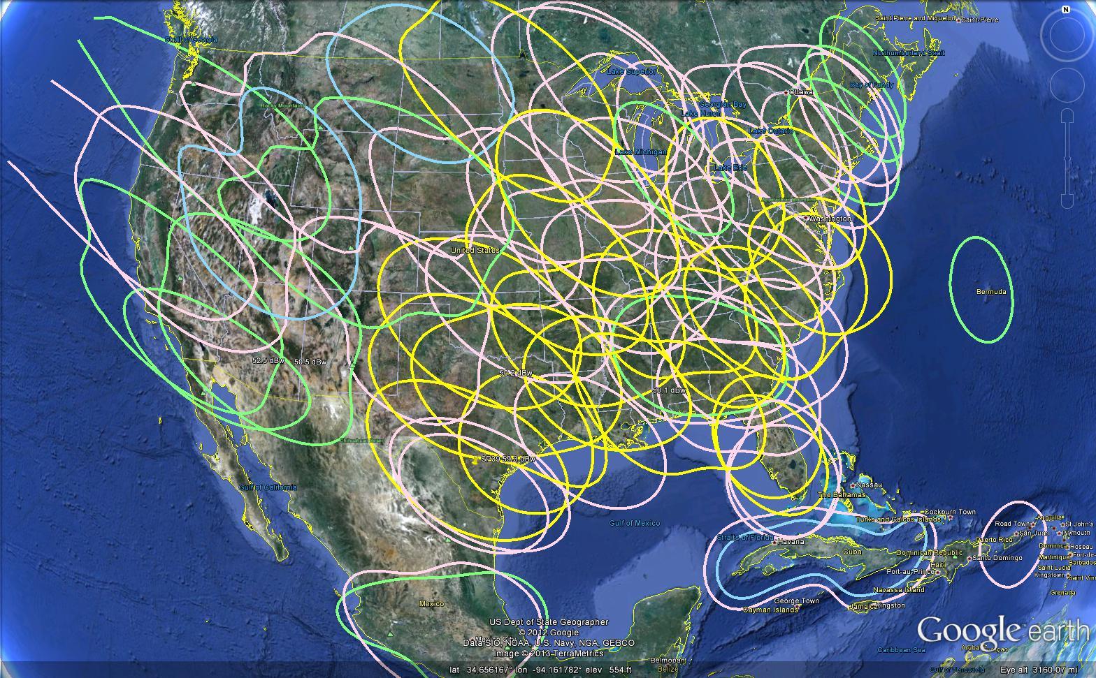

Thanks for the table Nelson. Is there a map anywhere that shows all the spot beams on one image? Similar to what we've had in the past for the other sats. Just curious as it'd be nice to look at them all together.
Seventy one (71) spot beams.

Now that is an impressive spot beam coverage map! Looks like a tiny gap in coverage in far west TX/S. NM and Norther Washington State. It looks like they could pretty much move every market into a spot beam with that satellite.

Awesome! Thanks again. That makes it very obvious that they have all those markets on the 77 location covered with no problem. It amazes me how far they've come from the first spot beam sat. Not only in coverage, but also in bandwidth. One sat now that handles thousands of channels.

On the spot beam map what is the signal strength within the yellow area marked as the spot?
Yellow is always 10 dbw less than the beam center. Go to the Satmaps and hover the cursor over any contour on a beam and the absolute value will pop up. There can be a big variation in values depending on the dbw of the beam center

Was curious what everyone's experience has been with receiving a usable signal from Dish's spot beams. Based on previouse sats that they have in use I find that a standard dish (18" single, dish500, dish1000.2, ect.) can receive down to around 52 dbw. I've aimed a 1m primestar dish at the 110 location and gotten a usable signal on a beam where the strength in the area was around 49-50 dbw on the particular spot beam. This was of course estimated using the spot beam map.

Double the surface area of the dish for 3 dbw drop in signal at the lnb. 4 times the area will give same performance with 6 dbw lower signal .
