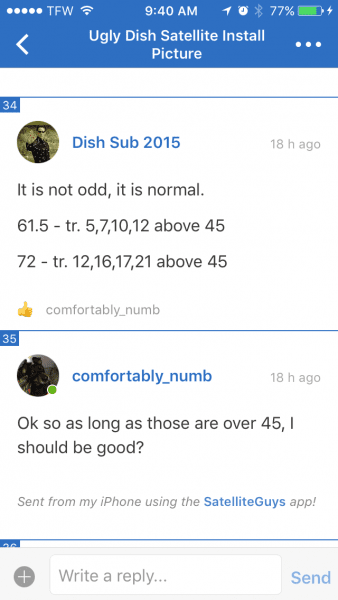

Dish and Direct show optimal signal strengths differently. The attached screenshot shows ideal signals for EA
