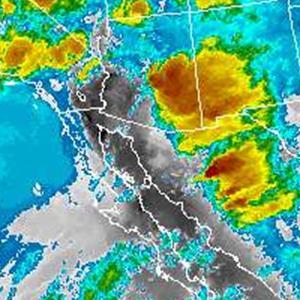

Some EA is uplinked from Gilbert, Az and they are having some weather events there.
National Weather Service Watch Warning Advisory Summary
Since they are pointing east through the storm it's no wonder the signal wasn't reaching the satellite. If they had increased the uplink power in Gilbert and increased the satellite's gain as the storm moved in way then they could have recovered any loss, but it seems like no one was awake at Gilbert TOC. And also since 72 is a Canadian satellite they might not have direct access to making such on the fly changes from Gilbert. But in Cheyenne I am sure they have access to send a command to increase gain on board 72.
