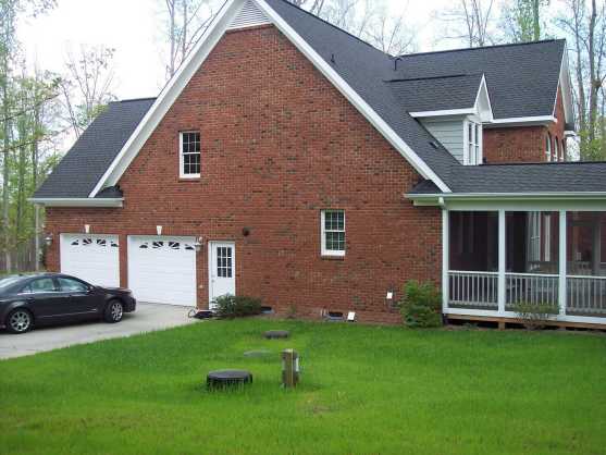

I will share with you and for others to see the problems with high roofs with steep pitches. Of course there are those on here who will climb mount everest to place a dish. I follow my wn guidelines of safety. Typically ,If I can get to a place on the roof wihout using special harnesses and be able to work comfortably wihtout concern of falling or my tools becming victimized by gravity, I'll do the job ,no problem. But if getting to and working at this place jeopardizes my safety in anyway,It's a no go. However I will contact my dispatch to let them know. We have in our group of techs a couple of mountain goats with more valor than brains who will go up on extremely steep roofs. These guys are much younger than I and have not yet had the priveledge of falling from a roof while working and trying to be hero. Those days are over for me.
Ok, one other issue. On jibs where the dish has been mounted in a hard to reach placing, that system has to be serviced. That means a tech with the skills to get to the dish are required. That means a potential delay in service for the customer.
I agree with your comments on safety. That's one reason that I am surprised that the dispatcher did not take my word for the need for a longer ladder, as was pointed out to me by the first technician.
I am attaching a picture of the side of the house where the 61.5 sat will be located. The current sat is mounted on the roof about mid-way up the slope. I don't think that the slope is unusually steep, but you cannot walk there. If this house is not available for a high dish I would think that many homes are not. I'm thinking it's just a matter of getting the right equipment to install. Then my Dish records should indicate that a long ladder is needed for any maintenance.
