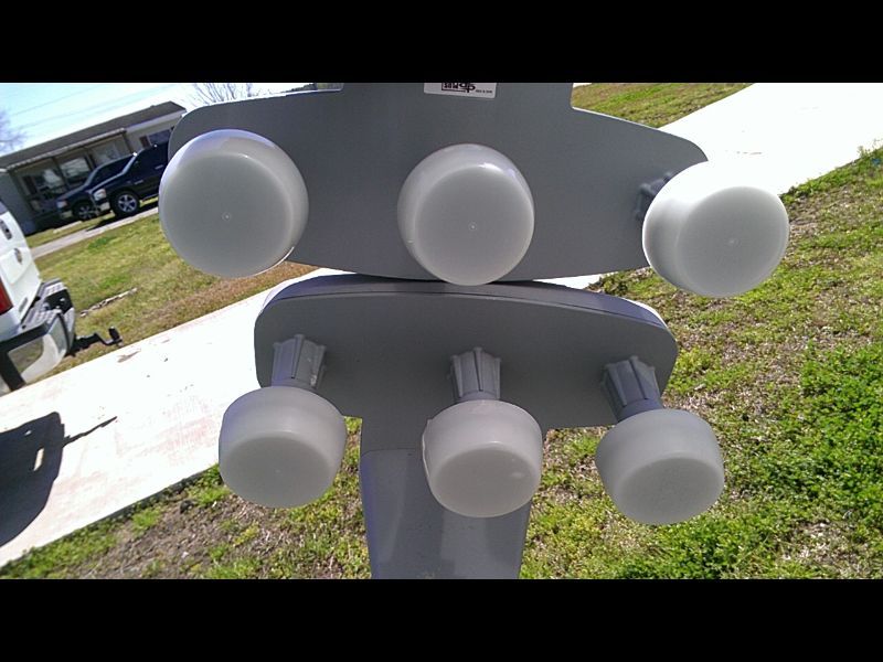

This looks nice that Brussam posted. What do you think? Satellite Dish Conversion KitUnless it's the specific WA LNB that's designed for the 1000.4 dish then it's not a compatible LNB. The WA 1000.4 LNB is NOT common. The WA 1000.2 LNB on a 1000.4 dish would be a hack at best.

Don't you have a 1000+ dish now? That is the largest WA dish made for the US. market. Why not try Brussams modification kit and report back how it works.This looks nice that Brussam posted. What do you think? Satellite Dish Conversion Kit
Something to think about, thanks boba.Don't you have a 1000+ dish now? That is the largest WA dish made for the US. market. Why not try Brussams modification kit and report back how it works.
You're best bet if you insist on a 1000.4 dish/WA LNB, is going to be e-bay. You probably won't find very many, if any, brand new & the price will be appropriate for their "rareness"; here's an example:So what do I need to order? A 1000.4 dish and then purchase the WA LNB assembly separate. Will it all bolt together ok?
