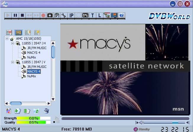

I finally got around to install my 2104D USB receiver. When I scan a satellite, it scans in both the H & V side of the same frequency. What am I missing here?:confused:

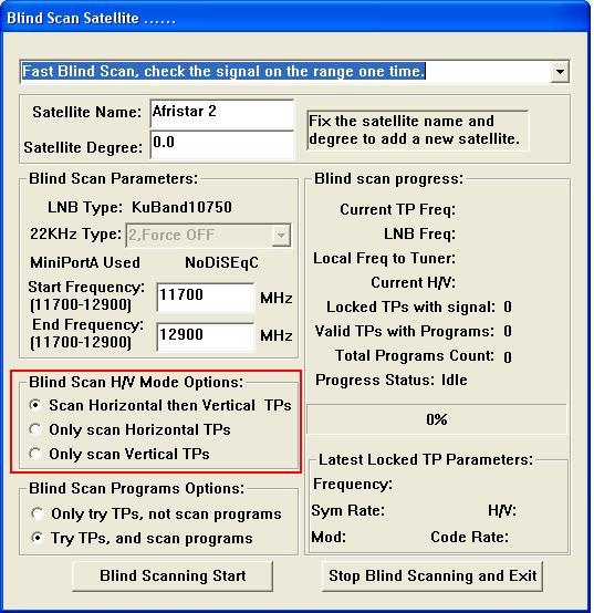

Are you using a different receiver to control the polarity?
If so then you have to tell the DVBWorld receiver to only scan one polarity.
No, qwert1515. But after some trial and error it began to scan normally. I have 2 Dishes (both Dual ouput Linear LNB KU) connected to a 4X1 switch with 97.0W° on input 1 and 105.0°W on input 2. The output from the 4X1 then feeds into 22Khz switch on the "0" while the Motorized output on a (Universal KU dual output) goes to the 22KHz side (I move the Dish using Coolsat 5K) and the output go to the DVBWorld USB 2104D.

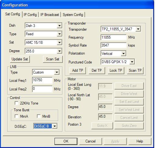

How can I edit the satellite configuration on the 2104D? After, I scan in channels, the satellite configuration parameters are grayed out. I should be able to change L.O. frequency and port settings on demand after I scan a Sat.:(
What I do (with a 2104C) is scan a transponder with no signal, the scan window closes on its own, reopen it, and then I'm able to access the sat config parameters again.

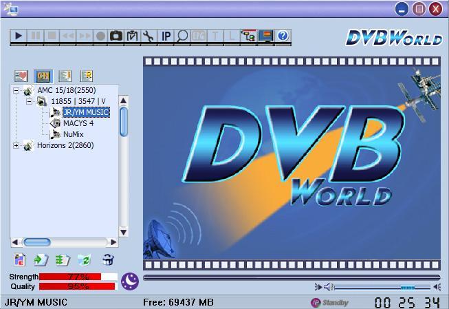

I now have a new problem. For some unexplained reason my Linear Sats are not displaying, but the Universal KU are showing fine. The Linear Ku channels scan in fine, but when I choose a channel the Quality and signal meter go from Green to RED!!!:( I have checked the switch. Used the same cable that I used with the 2104D on my AZbox & Coolsat 5K and all channels work fine. This same setup worked last night on the 2104D!!!:mad: See my first post. I have tried everything, but only the Universal from my motorized gives me signal and quality.
You 'checked' the switch, but have you tried it without the switch?
Yes, I did.
.......but as I said the same switches all connected work fine with the AZBox & the Coolsat 5K, and as such should work with the DVDWorld USB 2104D. It should be noted, however that when connected without any switch it works, but I have more than one dish and will definitely like combine them with a switch while using the USB2104D device.
The fact that it works without any switch indicates the 2104D is working properly.
Using a computer card (USB one included) can be a crap shoot with switches, and using a bda driver just throws another wrench in the mix. And on top of that different software (the DVB program) is another factor (some work/do a better job with switches than others).
Sorry, I don't have any suggestions on how to make it work with your hardware.

I tried the 2104D directly to my switch and like you said the DVBWorld software has issues with different LO Frequencies. (No signal if I switch between C-Band and Ku-Band)
I tried DVB Dream and I did not have any problems with the switch, but remember DVB Dream is no longer free and it does not have the blind scan feature. (You can find the old free version on many sites if you look for it)
