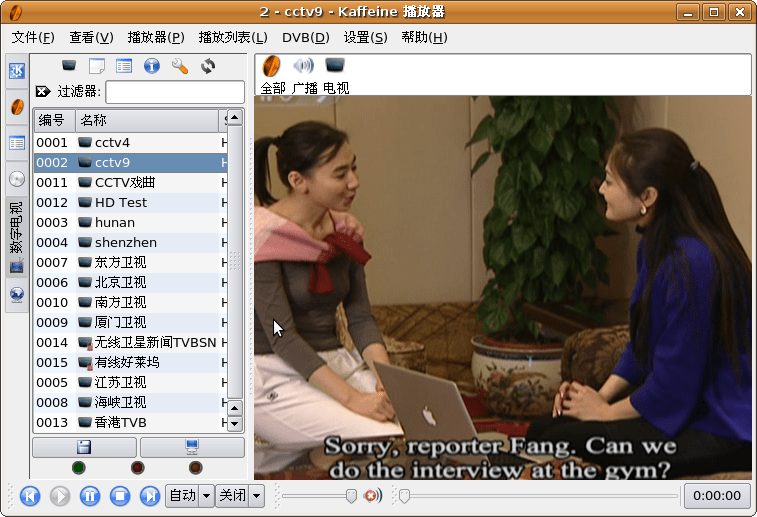

i download the newest s2-liplianin file. and make & make install .
of course copy dvb-fe-cx24116.fw /lib/firmware/
then
peter@ubuntu:~$ lspci
02:00.0 Multimedia video controller: Conexant Systems, Inc. CX23885 PCI Video and Audio Decoder (rev 04)
03:00.0 Ethernet controller: Marvell Technology Group Ltd. 88E8056 PCI-E Gigabit Ethernet Controller (rev 14)
peter@ubuntu:~$ lsmod | grep dvb
videobuf_dvb 15236 1 cx23885
dvb_core 94208 1 videobuf_dvb
videobuf_core 26372 3 cx23885,videobuf_dma_sg,videobuf_dvb
peter@ubuntu:~$ kaffeine
kbuildsycoca running...
/dev/dvb/adapter0/frontend0 : opened ( Conexant CX24116/CX24118 )
DVB plugin loaded
.0 EPG plugins loaded for device 0:0.
Loaded epg data : 0 events (1 msecs)
Launched ok, pid = 6317
peter@ubuntu:~$ Tuning to: ???? / autocount: 0
DvbCam::probe(): /dev/dvb/adapter0/ca0: : ????????
Using DVB device 0:0 "Conexant CX24116/CX24118"
tuning DVB-S to 12537000 v 41250000
inv:2 fecH:9
DiSEqC: switch pos 0, 13V, hiband (index 2)
DiSEqC: e0 10 38 f1 00 00
. LOCKED.
NOUT: 1
dvbEvents 0:0 started
Tuning delay: 1071 ms
pipe opened
xine pipe opened /home/peter/.kaxtv.ts
