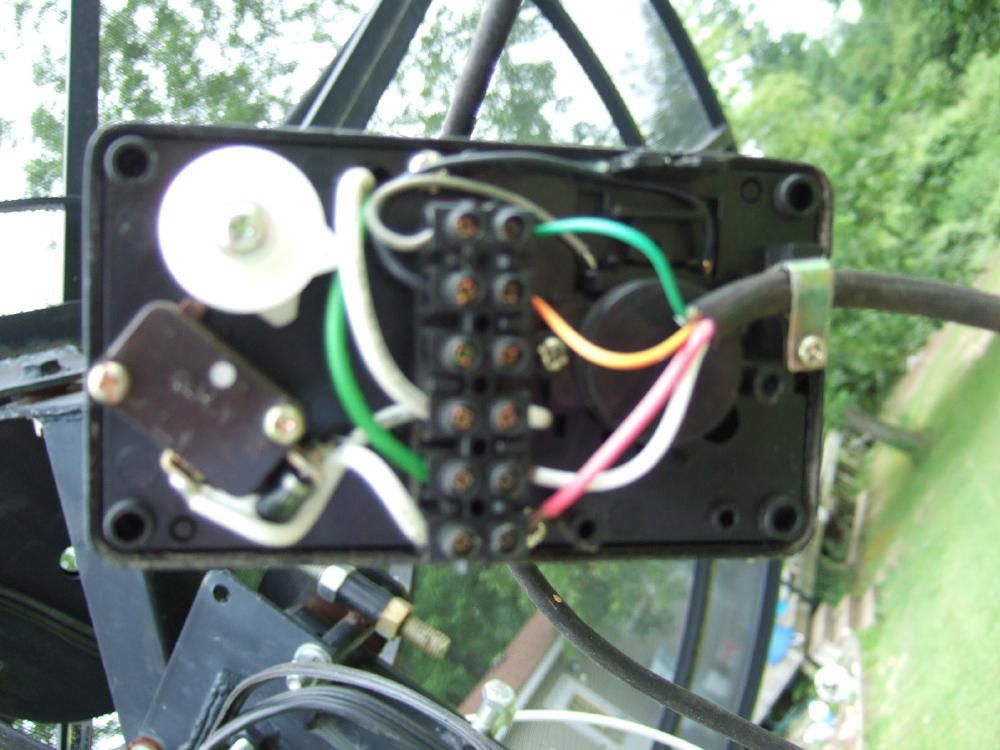

ok i can move the motor but the sensor must not be hook up correctly or maybe something else.
here are a couple of photos of the motor in question.
the motor works fine but only lets me move it in one direction , it errors out trying to go the other direction saying it reached the physical limit (so to move it alot i have to swap the white & red wires) (M1 & M2)
let me know what i'm doing wrong

east limit says 4786
west limit says 5422
its currently at 4785 or it thinks it is, i ran it all the way west today but it still said 4785

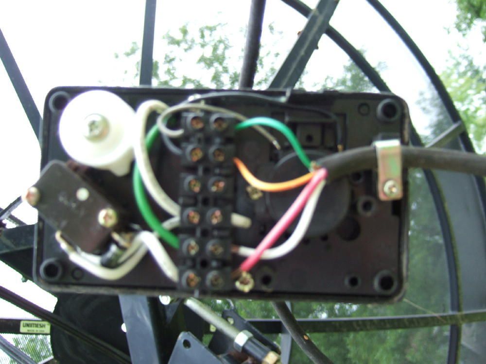

George,
The fourth picture from the left. The little white round wheel in the upper left hand corner is the limit switch. It has two lobes on it. The actual switch the lobes turn off is directly under the wheel.
When you run it all the way one way or the other, see if the little lobes actually touch the switch.
If they do touch, the screw can be loosened and the lobes moved. You may have to invert them to get more out of the actuator.
If the lobes don't ever touch the switch, there is a bind somewhere in the actuator.
Be careful not to let the arm travel too far, because it will come off the screw.
Hope that helps!
Fred
lol fred i've actually had one go all the way east :)
but i get what your saying with the switch. it does move left & right ( east & west for the full arc) from 139 to 85 so i know the arc works . maybe i fried the sensor
cause i can't get the receiver to talk to the motor , it (the receiver) doesn't know the dish is moving.
thanks for the input guys
If it counts pulses, the sensor is not fried.
The pulses or counts come from the sensor. It may not be counting correctly in which case the magnet wheel may need to be adjusted or cleaned etc. The wires may be corroded that run to the sensor.
It is probably something real simple.
Fred
