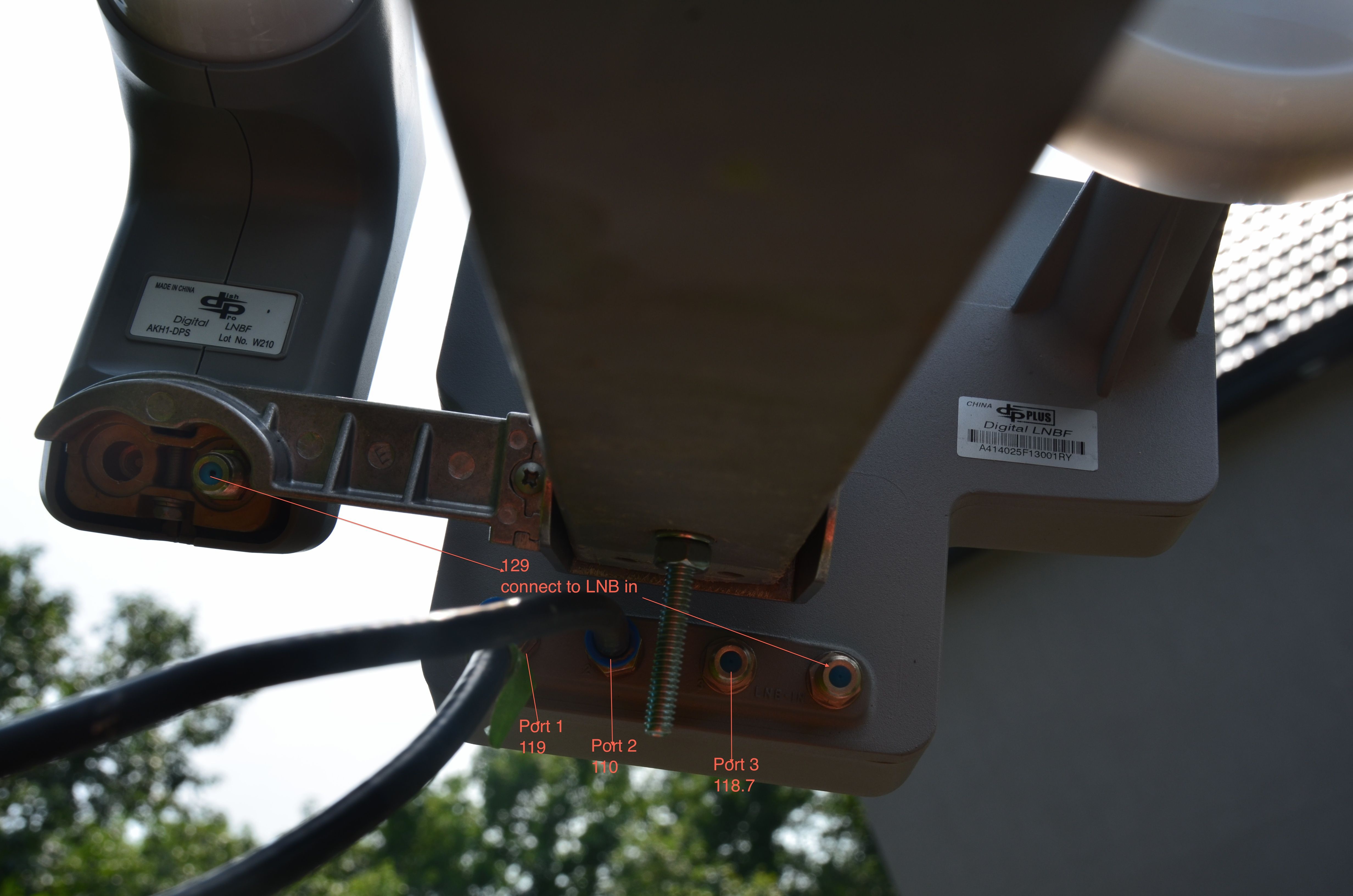

I am a newbie and I need help with respect to the new DPP 500PL LNB.
I need to know if the connections in the attached photo is correct i.e.
Port 1=119
Port 2=110
Port 3=18.7
Connection from 129 goes to LNB in

Here is a link with information about the installation of a 500 + dish: http://caottimail.com/InstallationReference.pdf. A 1000 + dish can receive the 119, 110, 118.7, and 129 satellites. The 500 + cannot pickup the 129 satellite.
If you are using the Hopper, you do need a switch (DPP 44) between the dish and the Node for the Hopper. From the Node, you connect 1 RG6 3Ghz rated coax cable to the Hopper. Each receiver in your system feeds with 1 coax cable from the Node.

The 500+ DPP lnbf has 3 DPP coax outputs. Run 2-3 ghz cables from the lnbf to a Solo Node. Run 1-3ghz cable from the host port of the Node to the Hopper. No external switch (ie dpp44) is needed.

What do you mean by Run 2-3 ghz cables from the lnbf to a Solo Node. Do you mean to get a connector which would allow me to join the three cables as inputs and then I would only have one output to the Hopper?

If your using a Hopper with a Solo Node, run 2 RG6 cables to the LNB from the Solo Node, then run 1 RG6 cable from HOST port on Solo to the Hopper, If you have 1 Regular Joey run 1 RG 6 or (RG59) cable from the Client port on Solo to the Joey.
If you have a Super Joey you will need an integrator, 1 rG6 cable from Integrator to Dish Lnb the other 2 the Client Port, if oyu have both a Joey & Super Joey then you need to add a Splitter from the Client port on Solo then from splitter 1 to Joey and 1 to Integrator. a Dish 500+ is for 110,118.7 & 119, you can make it into a 1000+ by getting an add on kit which would be an arm that bolt onto the dish lnb mount & single or dual DPP lnb, that would plug into the 119/118.7 lnb.
for 118.7 you will need at least a 30" reflector, 118.7 is mostly International channels and 129 is mostly HD Channels and Locals.
Hope this helps.
