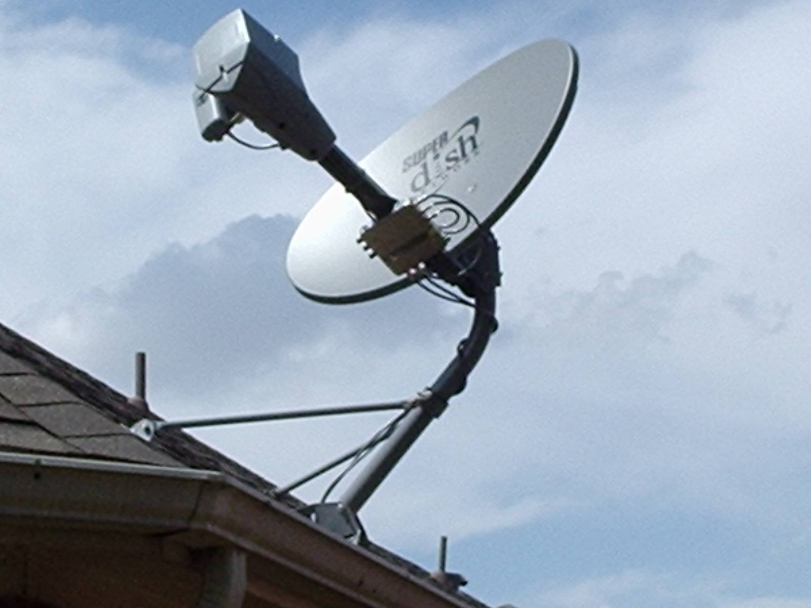

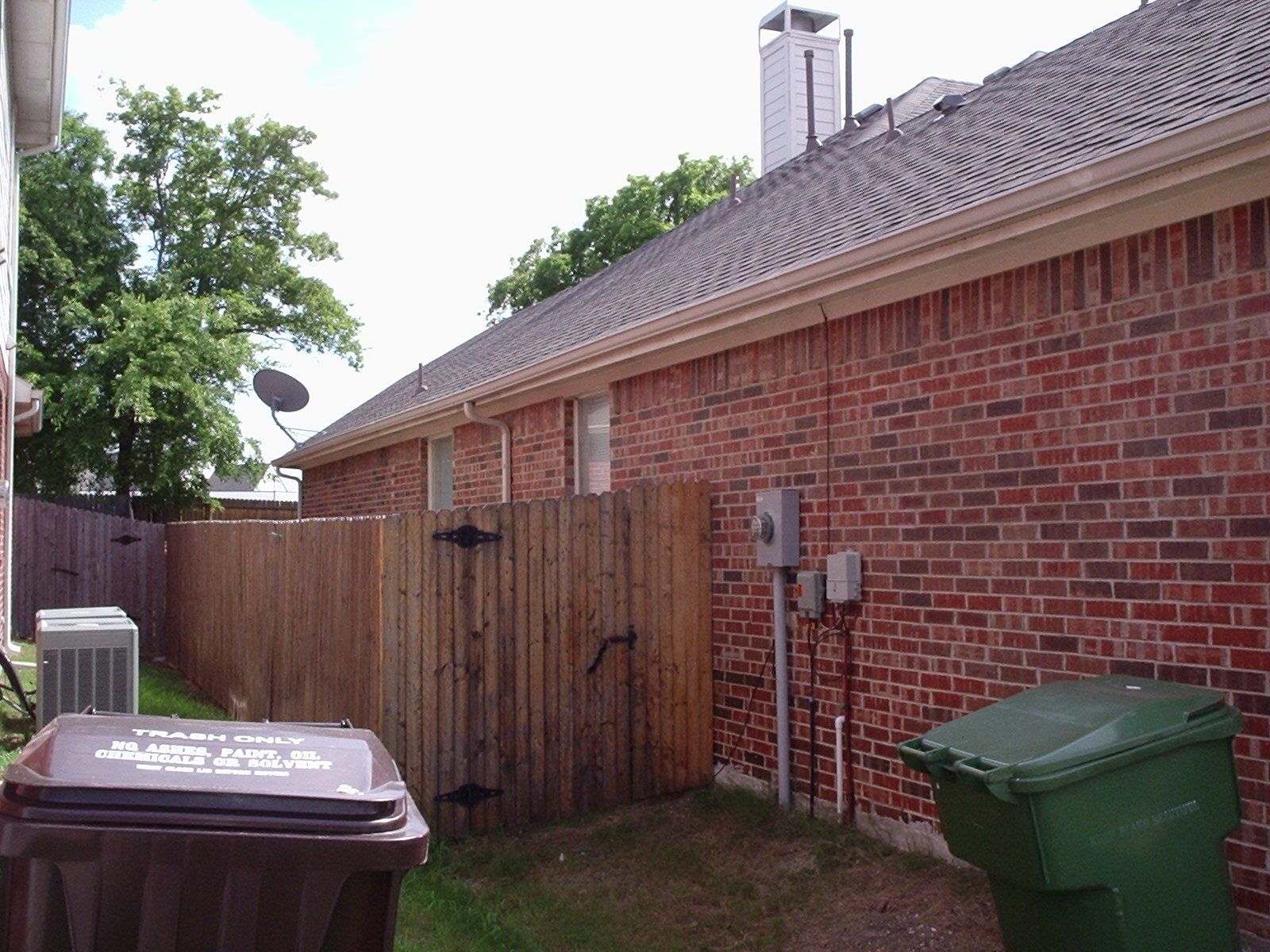

Good point, here is a pic from a so call local dealer did an installation to a customer, I did went back there within a week when customer called dish which I still work at that time. this installation is not codes and should not be say quality but hack job.

Good point, here pics from a so call dealer, installation is not codes and I would say hack work.
