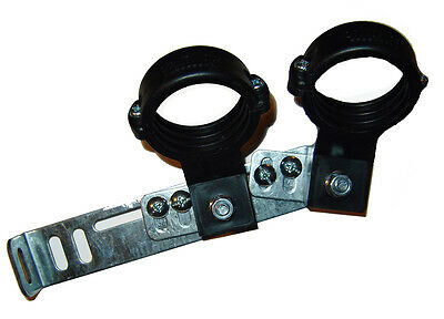

GEOSATpro Double bracket on GSP90
fireball517
Mar 21, 2019
199
193
East TN
If I were to get one of these
and install it to my GSP90 peaked on 87w , would I be able to have 91w as well or would it be too much seperation between the two?
Reactions: c-spand
I have received 91W using an offset LNB when a 1m dish is focused on 87W. I used a GEOSATpro SL2 bullet LNB (thin form factor) to do this. Standing behind the dish, you need to position the 91W LNB to the left and above the 87W LNB. As long as the bracket allows this, then it should work.
4 degrees such as 87W and 91W is usually the minimum satellite separation you can receive. You need narrow LNBs to accomplish this. I have also received 95W and 97W on the same 1m dish.
My results are here.
