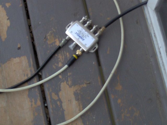

If I take the cable from the C-Band and put that into the "18V" side of the 2x4 multiswitch and put a cable from the G10 dish to the "13V" side of the same multiswitch...that would work, right? If I say "V" tranponder, it would go up the 13v side to the G10 dish and if I say H it goes up the 18v side to the C-Band.
Since the nets are on H on G4 and the Equity stuff is on V that should work and I wouldnt need all the extra switches. Right?? Anybody try this?
Thats why I love this board....you guys were right :)

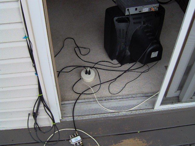

Hooked up a cable from my C-Band dish to the 18v side and another cable from the G10 dish to the 13v side of a Zinwell 3x4 switch and hooked up to the receiver
everything worked :)
but here is something weird.....the "signal" on the Pansat skyrocketed up...on G10 it went from 83 to 94 (quality was the same)

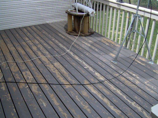

and before someone says it......yes the deck has to be painted (but thats the associations responsibility) :)

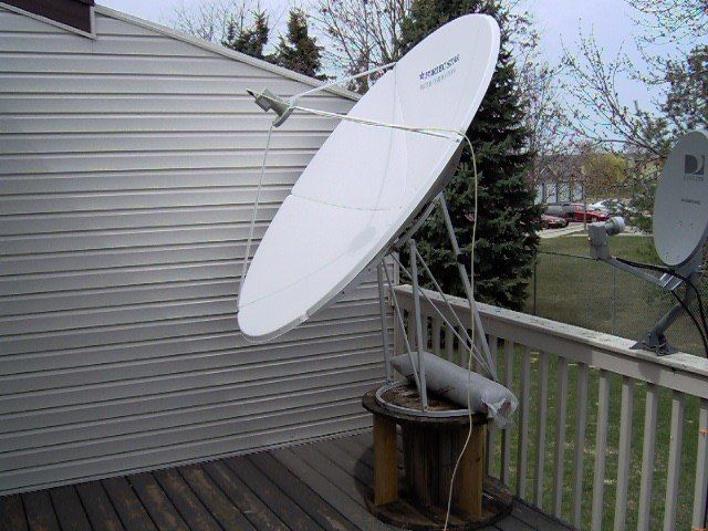

I like your C-band dish setup. It looks like you have a mini earth station.

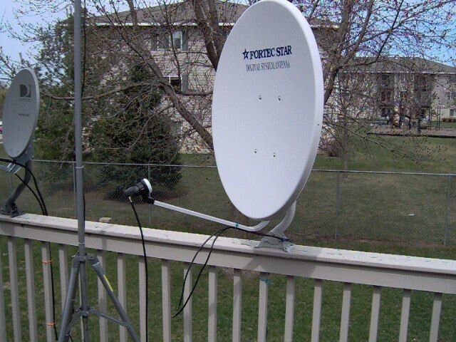

Iceberg, Love the pictures. Looks like my place with all the dishes. My wife would never let me put them on the deck though. Hey quit messing around with all that tv stuff and lets get the deck repainted! Ha! That's what my wife would say! Later, Chad
Chad
I've got 3 more on the roof :)
With the way my roof slopes (and the dishes on the roof are on the back side) it was easier to put the G10 dish on the deck railing.
The C-Band is on the spool to clear the roof :)
oh and that deck was painted late 04 (September)....So the association took the cheap route and it cost them

I like your spool setup. Did you secure the dish to the spool with screws, or is it just the weight?
I have one of the brackets that comes with the dish bolted down in the front. Used 5/16" x 2 1/2" screws. The sandbag in back is because Minnespolis TS is only 38 dgrees so the dish gets top heavy
I can easily loosen the bolts if I need to move the dish off G4
