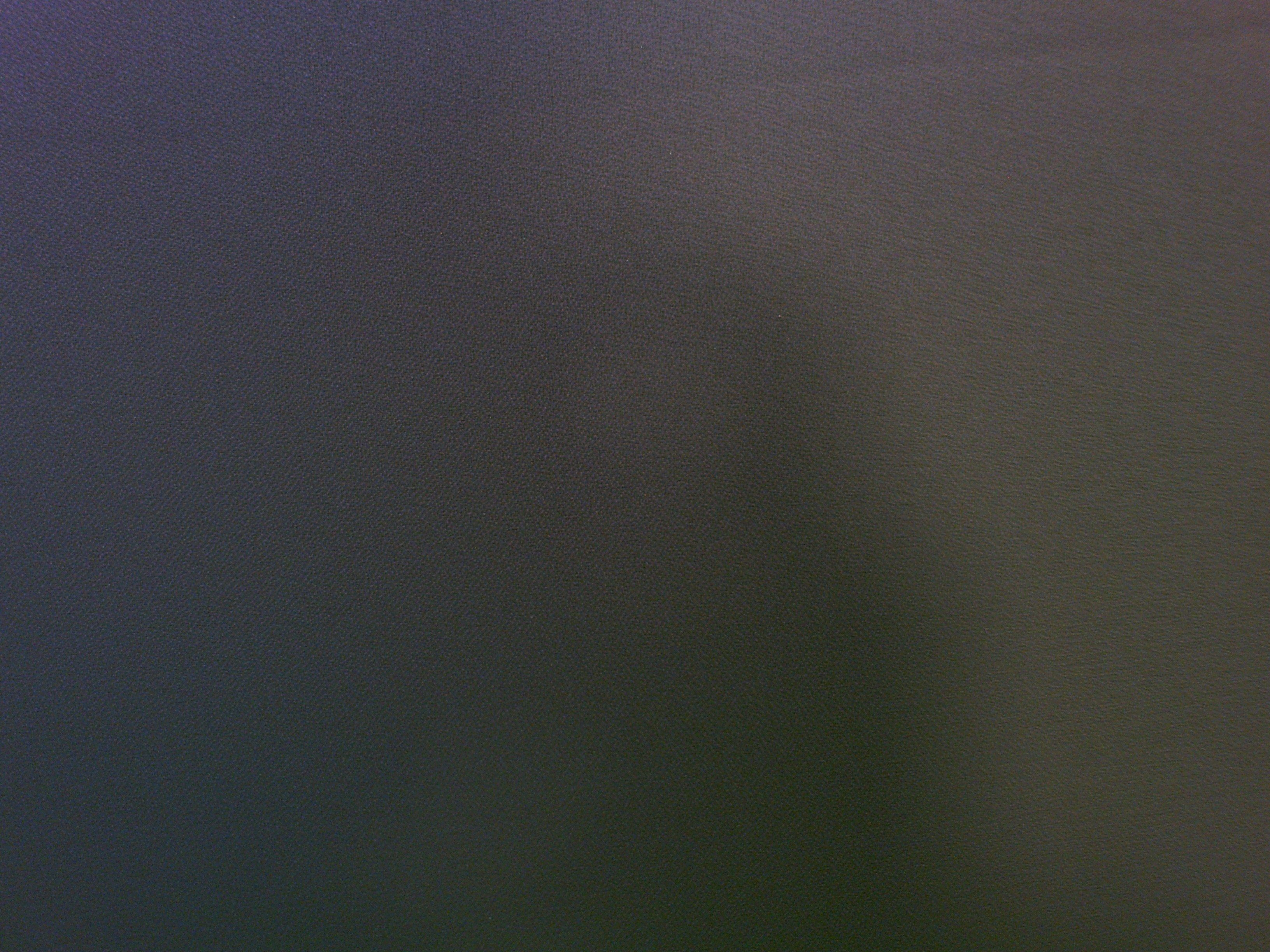

White worked pretty good... I was in Wal Mart in automotive (next to crafts) and ended up with 2.5 yards of a shinier 100% polyester material... worked even better, now to build a frame and stretch... (might take a while, many irons in the fire) ;)
I built a frame Monday evening very much like the above with a few differences, stretched the grey material over, then the white and ended up with an off size screen but I am happy with it for the bedroom for now... it is 96" x 70".

I don't, and Wal Mart took all the material out of the crafts department a couple of weeks ago... I should have written down the exact name as I would like to do same thing when I expand my HT (and will swap FPTV's when I do from BT to HT)
Here is a poor quality shot of the screen from about 2.5' , you can see the gray material behind the white...

I could trim some from behind the screen not sure how big it would be...
I can do quite a bit with something as large as 10x10" - gain reading, calibration readings, etc. Anything smaller I could just give you a spectro reading.
Let me know if you want me to pm you my address. :up
