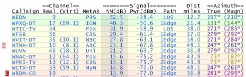

Thanks a lot for posting that! I already have tried the Clearstream 2MAX and the Clearstream 4MAX antennas, and both of them received the exact same channels at my location. Unfortunately, no CBS, no ABC, and no CW. Therefore, I do not think that the Dish supplied antennas will work any better.
My house is surrounded by many tall trees and that is the problem. During the winter months, I can receive CBS and CW (and 24 additional channels). I receive 48 channels in the winter, and only 24 channels when the trees have leaves...and I can do that with the shorter-range flat square antenna that Dish sent me a while back (when our Fox station was in dispute). I thought for sure that the Clearstream 4MAX would work better, but the leaves block the signal so well that I get zero signal for CBS and CW. An amplifier will not help because there is zero signal to start with.
What is weird is that I can get Fox with a signal strength of 85%, and NBC with a signal strength of 75%, but with CBS I have a zero signal reading. Looking at the antenna fool data, it appears that CBS has similar power, is virtually the same distance away, and comes from virtually the same direction as Fox and NBC, however I can not receive it at all. Since my ABC is on channel 10, I knew that receiving it would be near impossible with those antennas that I tried.
Does anyone have any suggestions for an antenna that might be able to shoot through the trees? Right now, I am most interested in receiving CBS since that is the station that is blocked by the dispute.
(BTW, I posted something similar to this during last weekend's SatelliteGuys outage, but my post and some of the responses were lost due to Scott having to use an earlier site backup).
Well, I finally solved the mystery of why I could not get CBS but had no problem getting weaker channels. It turns out that due to FCC re-packing regulations, CBS (WFSB Channel 3) has to change their broadcast channel and has lowered their transmitting power while they are doing antenna tower work. They expect to back to full power on August 1st.
The Clearstream 4MAX antenna does do a good job at my location (when mounted outside at the peak of the eaves) and it does pick up all the channels that I would expect at my location.
Hopefully, when CBS returns to full power on their new channel, I will be able to pick it up easily.
