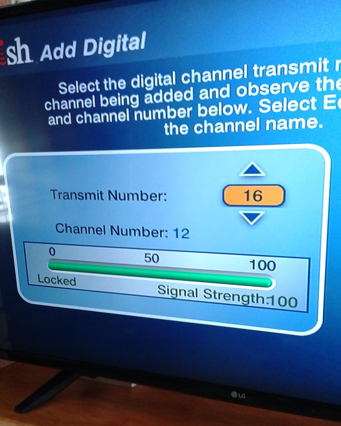

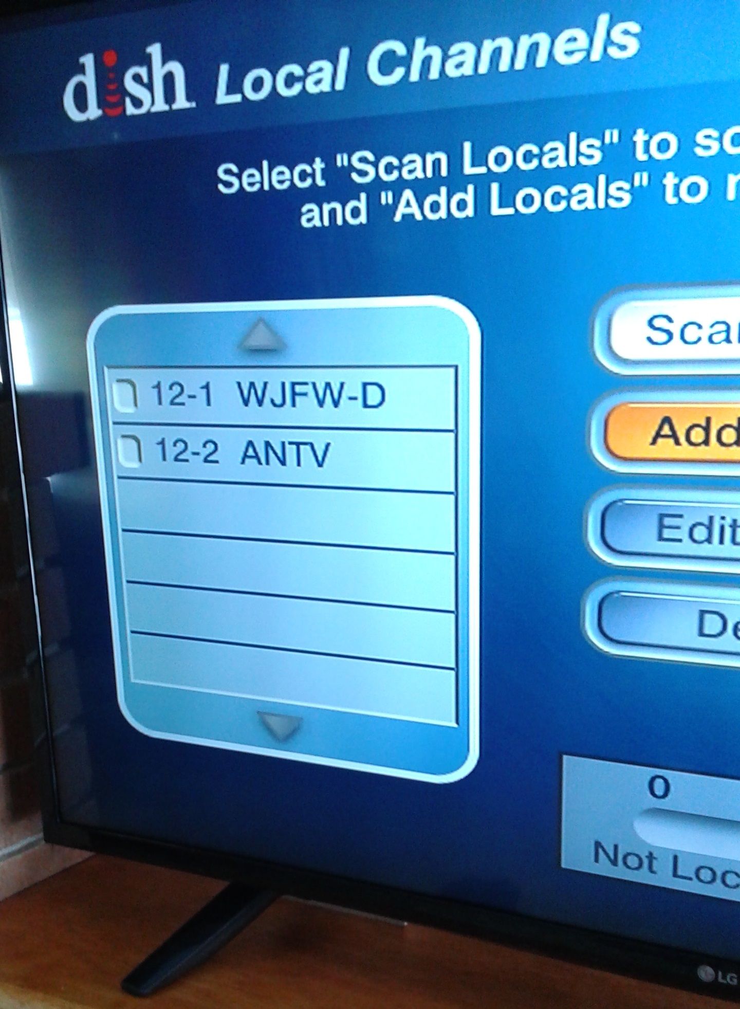

I am trying to scan in OTA RF channel 12, WMOW - Crandon, WI. WMOW transmits 1 main channel and 2 subchannels (3 total).
When I try to manually add RF ch 12 on the 211k it comes in as ch "0" and will not add the channels to the guide so they can be viewed.
When I try the scan with a DTVPal they initially come in as 12-1, 12-2, 12-3 but then in the guide get added in as 70-1, 70-2, 70-3. (See attached pics).
This appears to be a glitch in the 211k.

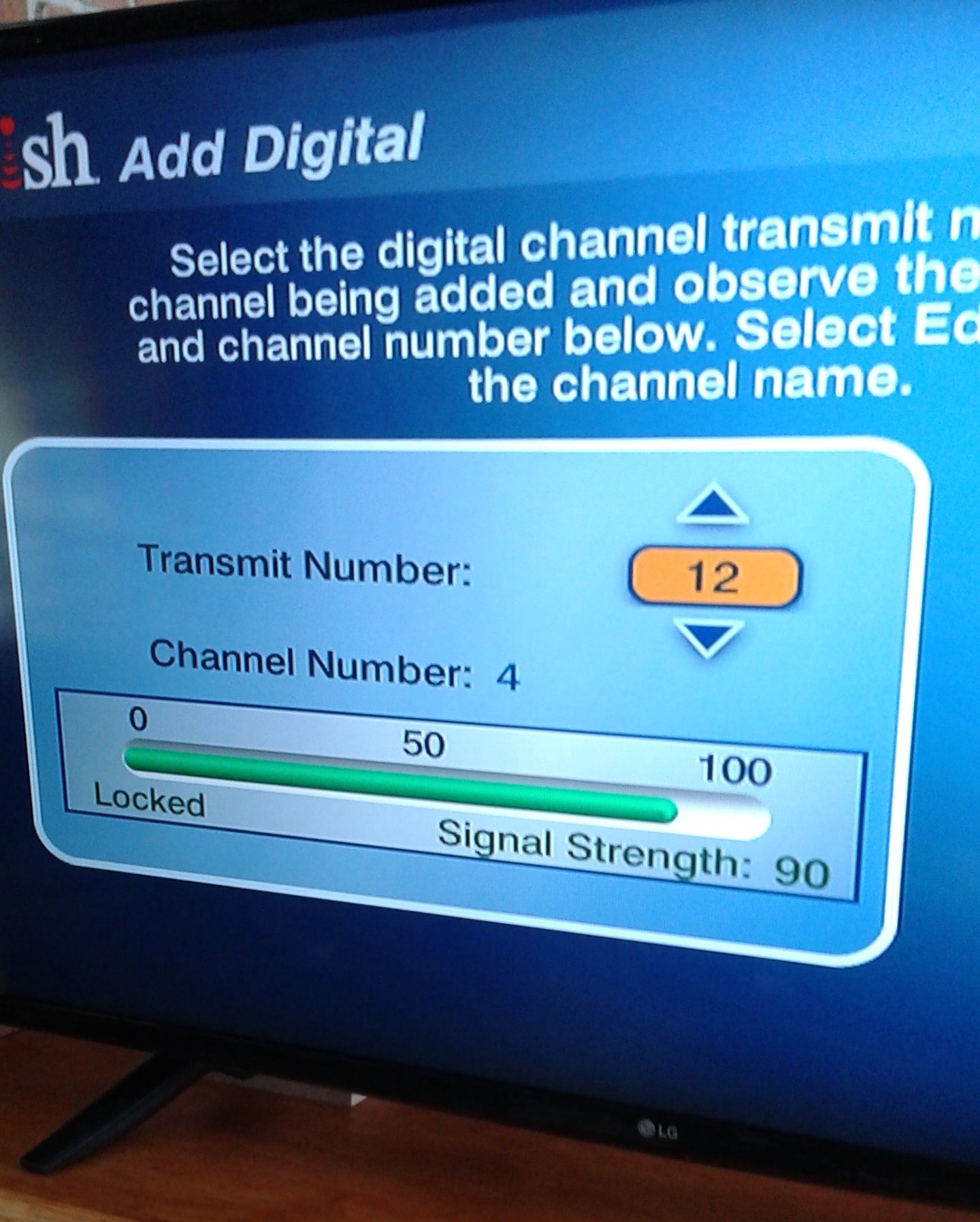

I have a Winegard HD7698P connected to the 8VSB port on my 211k, so yes the HD7698P covers VHF RF channel 12. I am getting a signal strength of 86 from VHF RF channel 12 (see pictures above).

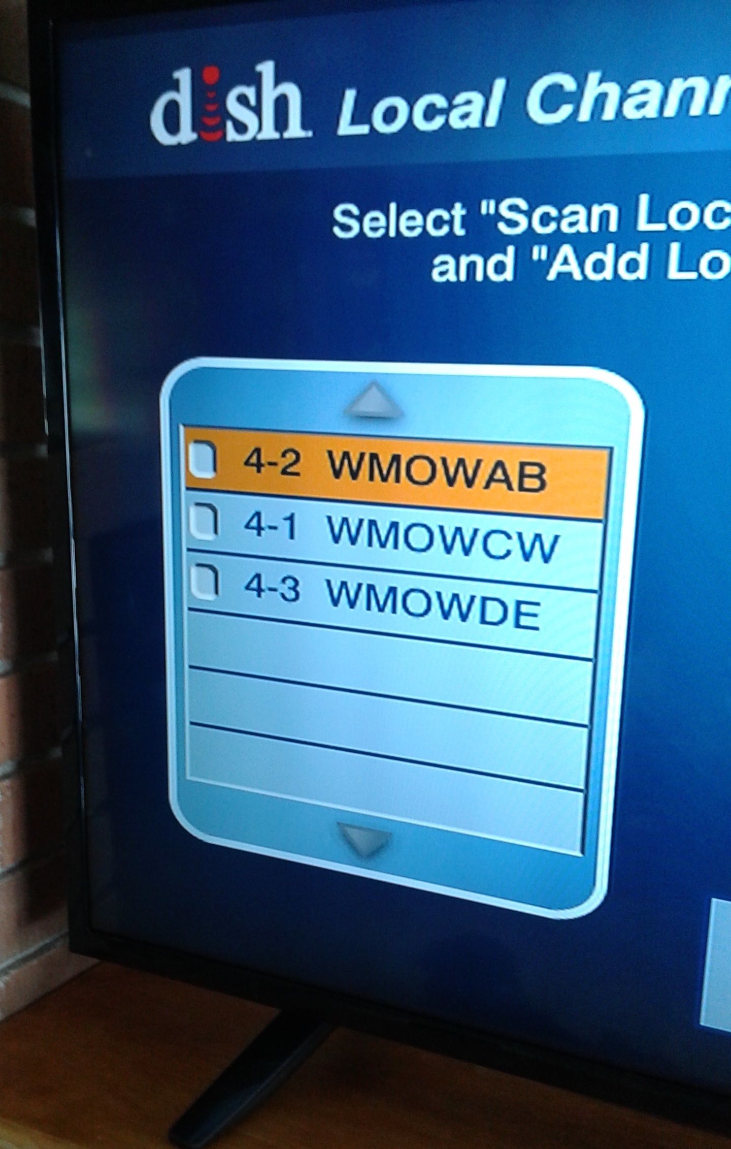

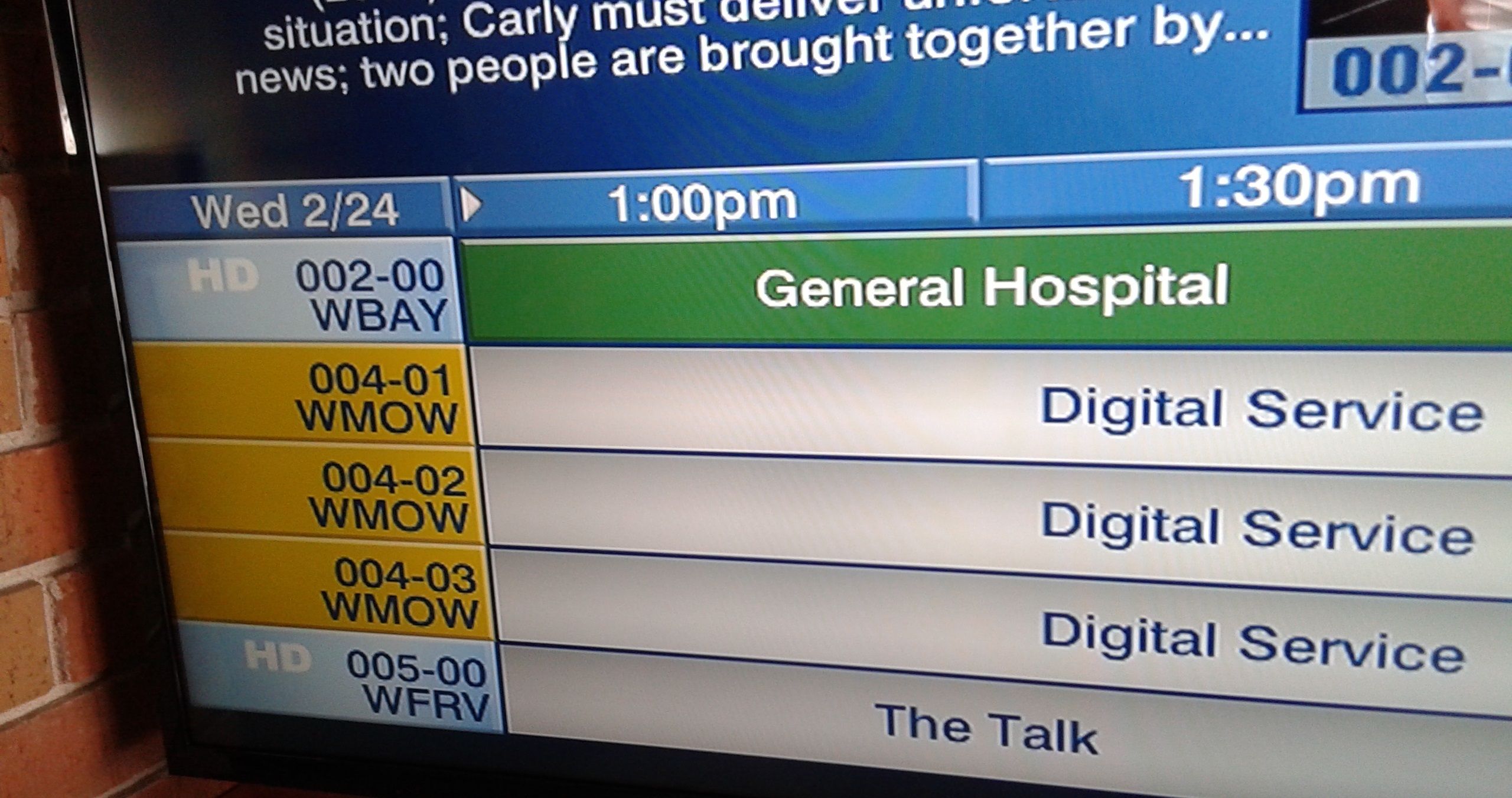

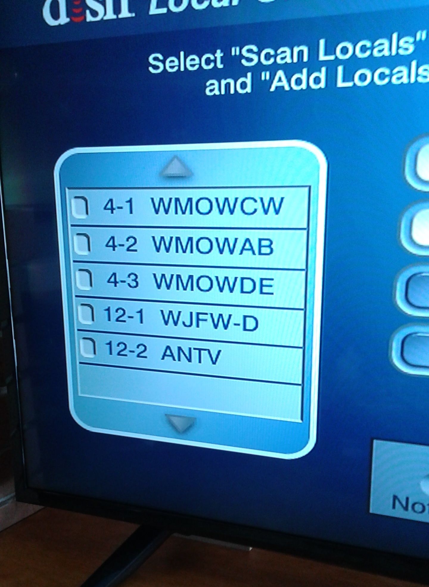

This problem is now FIXED!!!
When performing a channel scan the WMOW channels now scan in with virtual channel 4 and load into the receiver properly.
I am not sure if this was fixed on Dishnetwork's end or the OTA broadcasters end, it would be interesting to know what the problem was.
Either way, it is FINALLY fixed and I am happy...
