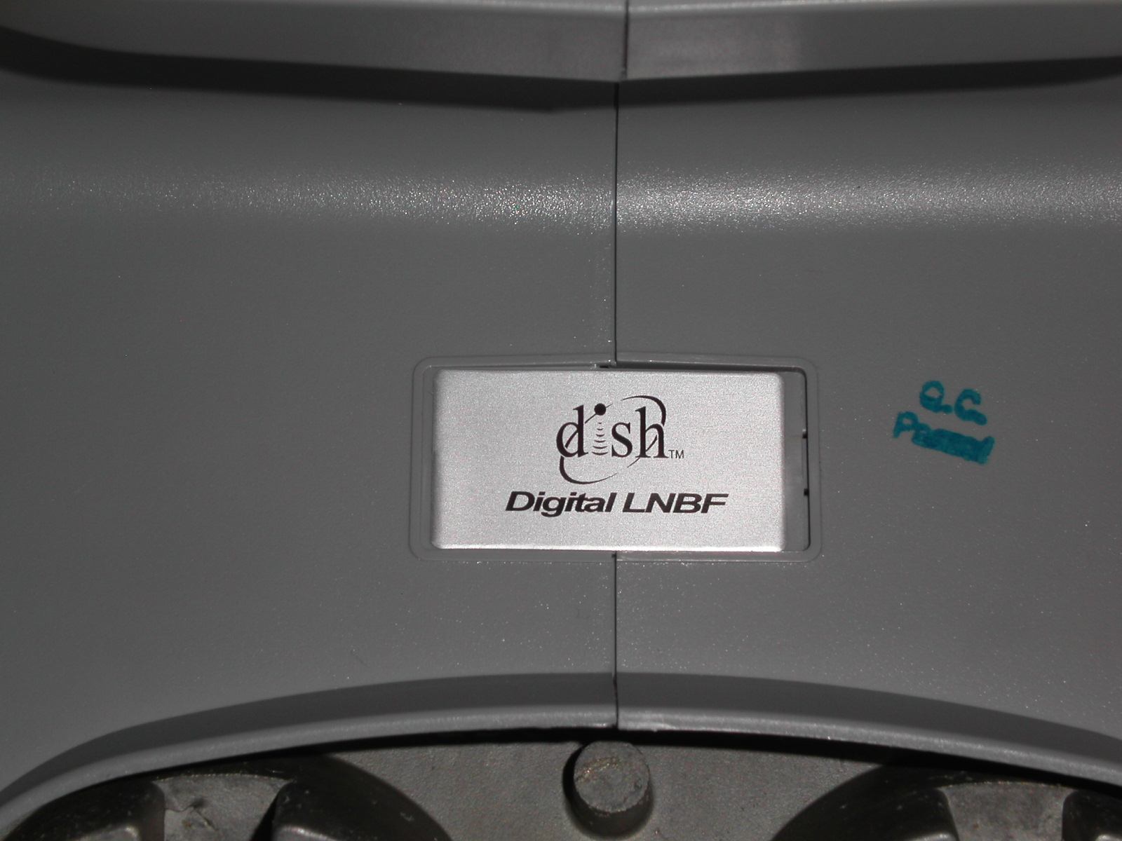

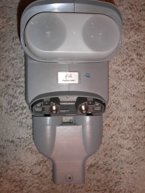

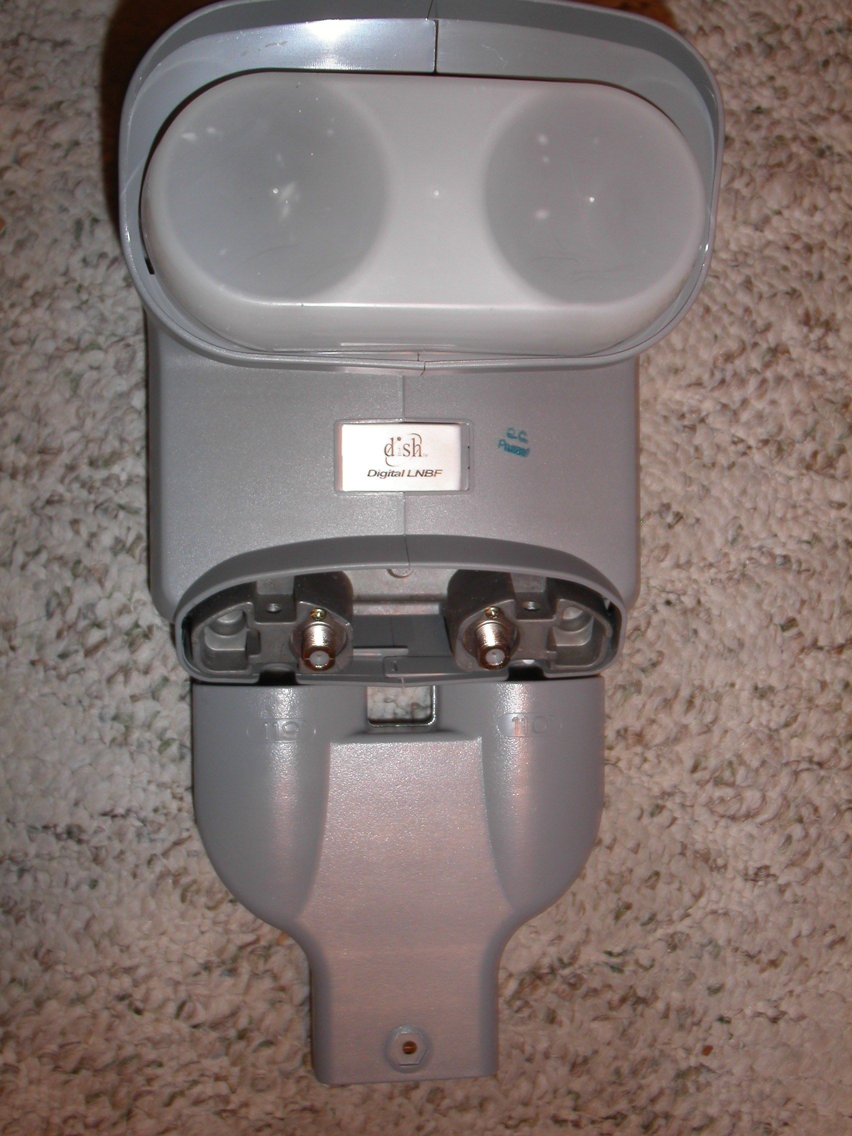

I am new to this forum and this is my first post. I currently have SkyAngel through Dish Network. I have just one receiver but recently purchased a new system (with receiver and dish) from a Radio Shack that was going out of business. It was one of those pre-paid systems. I'm wanting to use the new dish that has two LNBs (one for 110 and the other for 119) so I can use both of my receivers. Initially I thought each LNB would be able to connect to each receiver. But after searching the internet prior to installation, I'm not sure if that will work. Also, the LNB states that it's digital; my first receiver is at least 6 years old. So my questions are:
1. Will this digital LNBF work with my older receiver?
2. Will I be able to connect one LNB to my old receiver and the other LNB to the new reciever without having to use any switches?
Is there anything else I am missing or need to be aware of? I've attached some pics.
Thanks for your help!

Sorry your photos aren't much help all it tells us is you have a Twin LNB and a "Y" adapter.
What are the model numbers of the receivers that you have?
For Sky Angel you are looking at the satellite at 61.5 you will need a switch to combine the three satellite locations.
On your existing LNB on the SA dish do you have a BLACK DP on the side away from the dish?
You probably will have to call DISH and see if you can even do what you want with a pre paid system. You may only have purchased a dish and LNB you will have to buy a card monthly to use the pre paid receiver.:)
Also, original lnb may be a 'legacy' and not compatalble with new lnb's. The new lnb's should be marked with DishPro (DP) or DishProPlus (DPP) markings on it, but check your original as well. If not marked then it is a legacy. Switching out the original for a DishPro and a DP34 switch will connect your receivers, if the new lnb is a DishProPlus then switching out your original lnb for a new one and running wire to the input on the DPP all accomplish what you need as the switch is built into the lnb head and no other switch will be needed. A DishPro adaptor may be needed for your older receiver as well.
