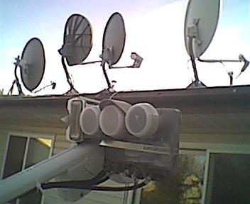

very true. I use to have a DirecPC dish (39x23) that I used for Galaxy 3C and my ExpressVu setup and when I put the LNB's on, the one for 91 went right next to the LNB for G3 (95) but for 82, I had to use a spacer (which was another LNB) to be the spacer.
Here is a picture of it :)
