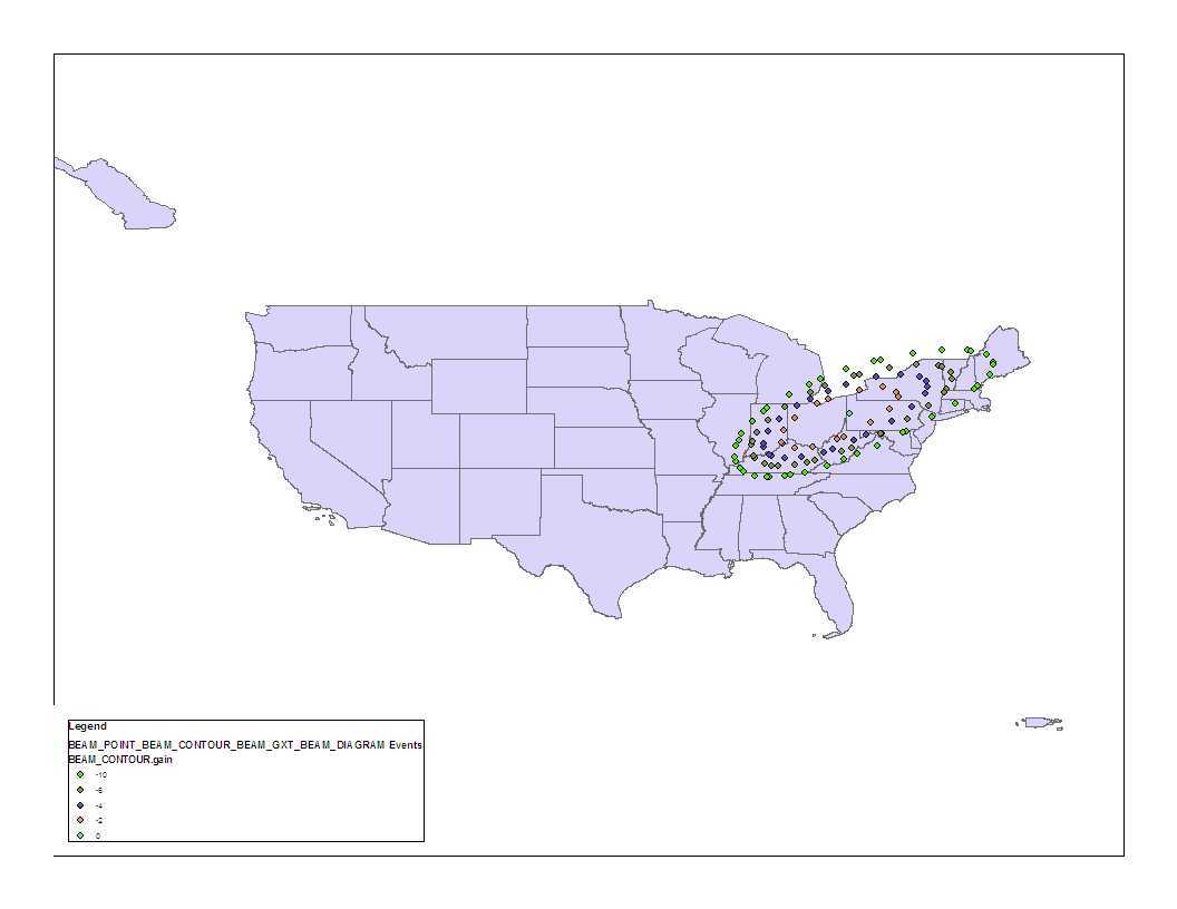

Forgive the crudeness of this. This is my first go at this and I lack the tool to quicky turn the points into lines. Here is the CONUS coverage, dilenated by the gain field under beam contour.

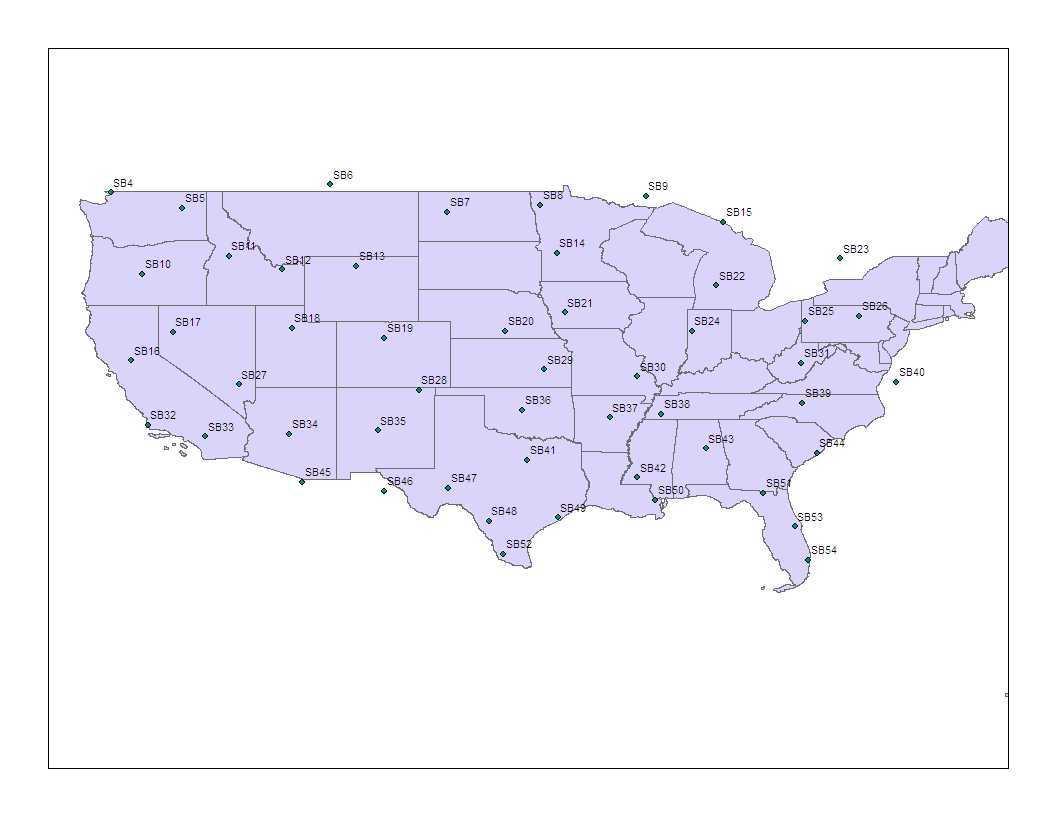

One last map, the center off all the spots.
Note: Alaska (SB1) and Hawaii (SB55) are not included. The Alaska beam seems to have a dual focus, primarily on Anchorage, with a secondary area around Juneau. There are no spots numbered 2 or 3.

Are they going to use 2 different spotbeams for Tacoma and Seattle? That'd be weird, since they're only about 25 miles apart, and about another 15-20 miles down here to Olympia. Spokane is on the eastern side of the state, about 350 miles ENE of here.
That list doesn't correspond to spotbeam centers. There is only one beam, SB4 in the filing, centered on the SeaTac area.

Sorry but don't understand the focus of SB47 it is in the middle of no where. It is NE of Presidio, TX. S of Midland/Odessa & way the heck W of San Antonio. In short why are they trying to burn a hole in the deer, goats & cattle that inhabit that area?:D

Could SB2 and SB3 be the CONUS and CON-Canada beams?
It seems to me they are refering to the CONUS and CONCanada beams as "CAN7" and "CAN4" respectivly. That, or I'm missinterpeting things. This is my first go at interpeting a FCC Schedule S.:) Perhaps there were some addtional Canadian spots in the design, but were scrapped. The numbering is Right to Left, North to South. That would place Canada is the spots for SB2 and SB3, given Alaska as SB1 and Seattle as SB4.

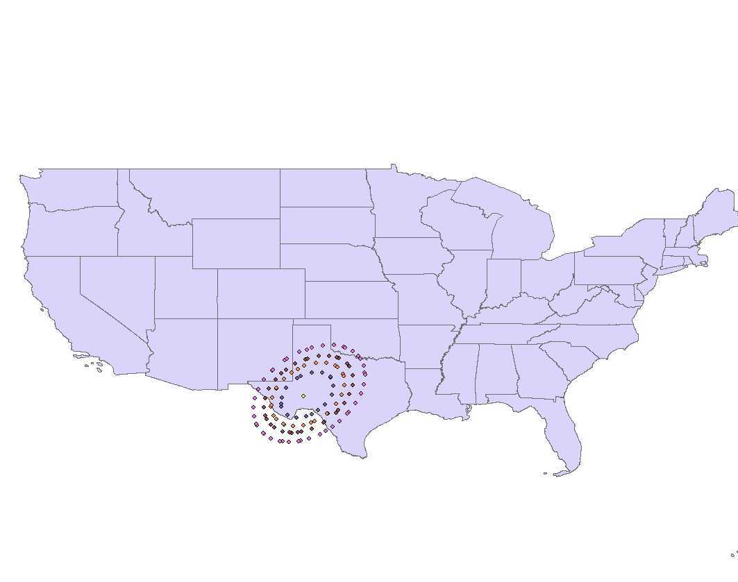

Perhaps a picture of the entire beam will help. I don't know my Texas geography, but there has to be some people covered by that.

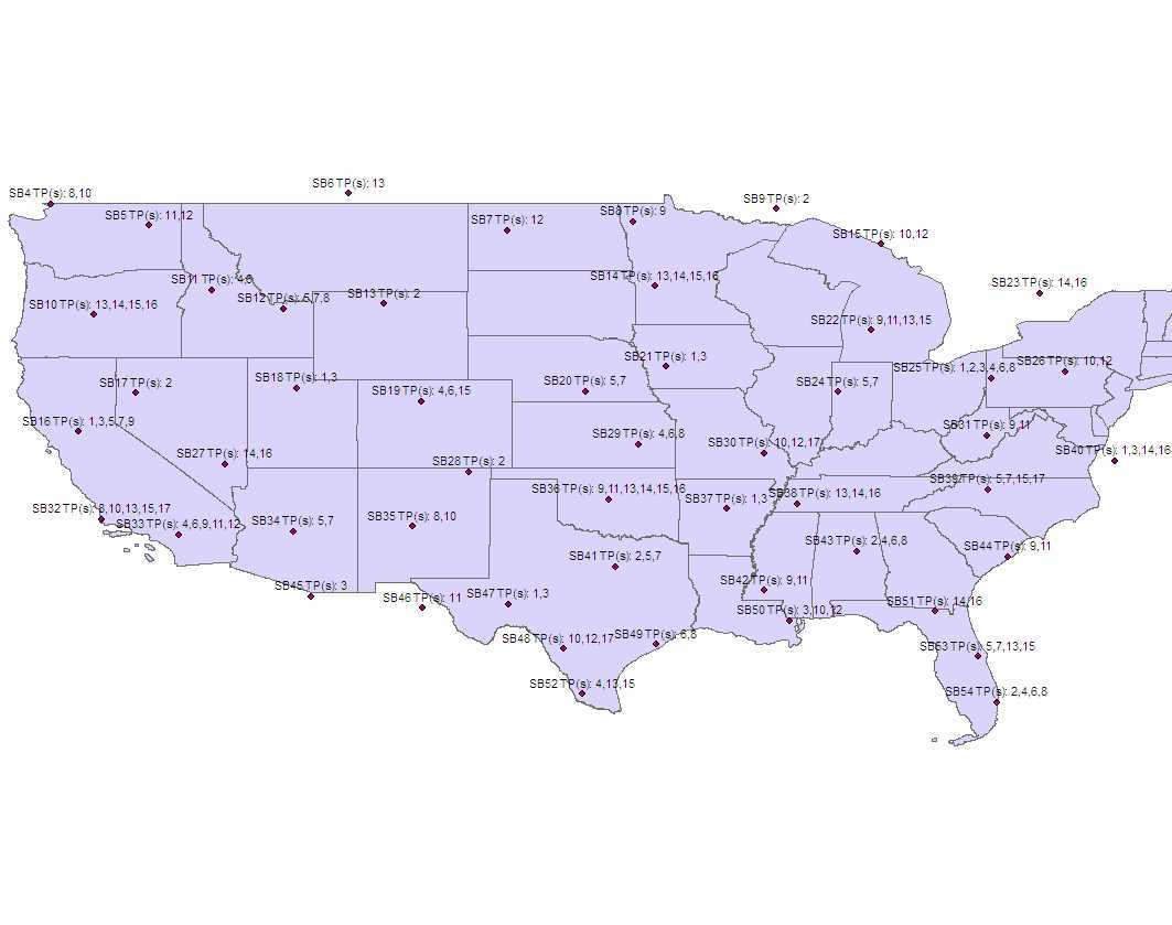

For what it's worth, here is a map with the spot centers and what TPs feed them. The centers may be slighly skewed. The points are in lat/lon and my US map is based on NAD83 coordiantes. If you no GIS, you will understand. Also, as you can see from this map, many of the middle of nowhere spots are fed by only 1 or 2 TPs. That makes more sense.
