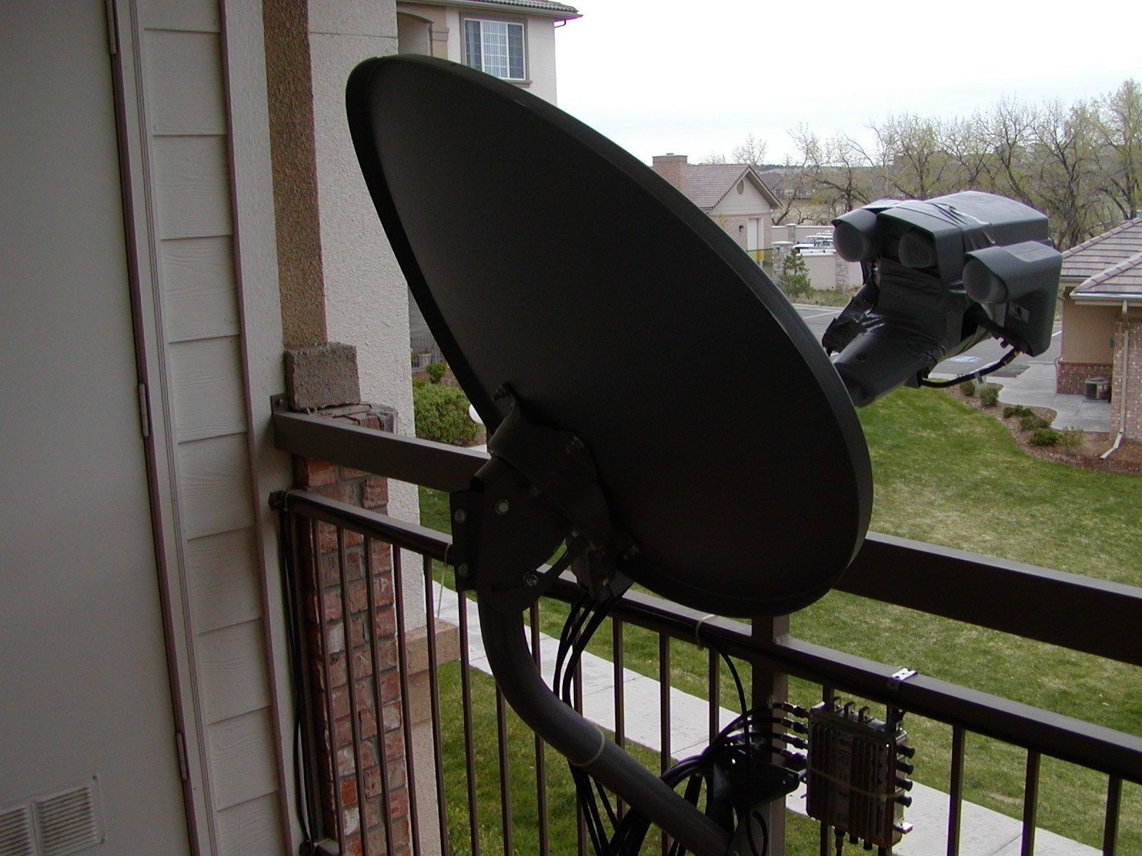

EDIT: Here's a picture of a SuperDish 121 attached to the railing on a balcony. Since I still had line of sight, I mounted it on the inside of the balcony to shield from snow and high winds, and don't seem to have any problems. This SuperDish 121 has an extra LNBF taped to the side for receipt of 129 (Denver Locals), other wise, I would just use a wing dish for 61.5 or 148 since I have LOS to all.
As said before, you need the SuperDish 121 because it has a DishPro compatible LNBF that can be used with the other DishPro LNBF and DP Switch (such as DP34).

If you are going to go with a SuperDish 121 to receive 3 sat locations (119/110/121), then you need to consider the following:
- (1) Switch: Either a DP34 or DPP44:
- - - - (a) DP34: Will connect 3 sat locations to 4 receivers, takes 2 cables to feed dual tuner receiver, no Power Inserter required, costs about $60 - $70 (+/-).
- - - - (b) DPP44: Will connect 4 sat locations to 4 receivers (8 tuners), take one cable to feed dual tuner receiver, costs about $170 - $200.
- (2) Routing cable: Will you be drilling a hole through a wall? Another option is using "RG-6 Flat Cable" which is about 8" long, but you can open a window or sliding door and then close the door on this cable. However, if you open and close the door too much, I have found it doesn't last long - so buy a couple of extra's. They cost about $2 a piece, athough some like to charge about $9 each.
- (3) Mounting: I guess if you got a big enough bucket, pan, slop jar, etc..., you could install a mast pole in it, with one end flat or a rod through it to keep it from turning. Then add concret mix and water to weigh it down. And maybe even run a bracket from it to the railing as an option.
Sorry - but I could not tell you how much weight or concret to use - maybe someone else has figures.
