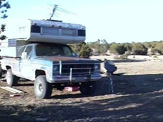

Heres an old shot from about 8 or 9 years ago, retired that camper, still have the truck but at $4 + a gallon, The Blue Truck doesn't get driven that much :D

Nice! (in a kind of funky way). Is that a VHF antenna growing out of the roof?
