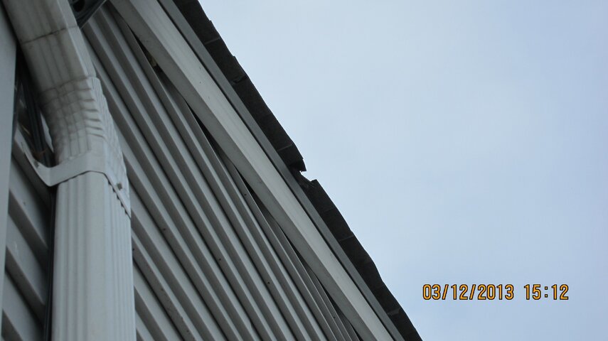

The damage is very minor. Only one shingle. I'm not making a big production. It may sound like I'm freaking out here, but I'm not. Mabye just venting since a paid 8K for for something that now has damage that is clearly visible. Not trying to scam dish. I am not like that. I just want it fixed. Here is a pic. How would any of you like to see this on your 4y old roof? The dish is mounted in the upper left corner.

YEs, this is damage, but from what I see in the photo I would consider it cosmetic. Try and straighten the shingle edge and maybe use a little adhesive to hold it in place. I actually would be more concerned with an attempt to replace this shingle causing damage to the integrity of the roof system than the edge tear that I see in the photo.

There is a ladder attachment to "stand off" the ladder from causing this kind of damage. Think of a C with the two legs pointing 90 degrees from the ladder.
Do most roofs has the shingles hanf over the edge like that? Aren't they normally a liottle more flush with the edge?
Actually, quite a bit more flush. I have done my share of roofing jobs, and I can say very confidently that this one was done wrong. The shingle should overhang the rake edge by about 1/2" to 3/4", no more. I'd guess the ones in the picture are 1" to 1 1/2".

That's what I was thinking. I've helped shingle a few roofs and have been on my fair share doing Dish work and have never really seen that much over hang before. I'm not a roofer though so that's why I asked.
