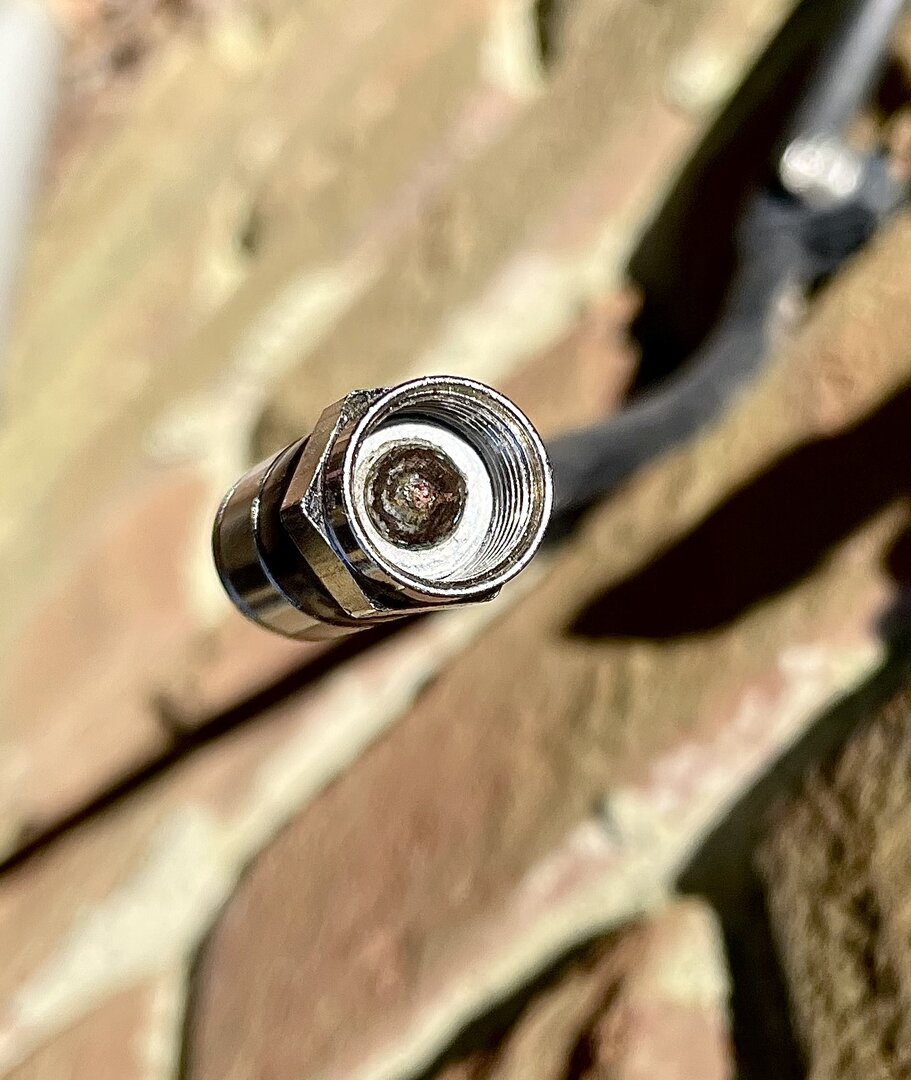

Well yesterday, Friday, we had another set of rain storms, and now I am out again, like it was when I first posted screen shots. So I did a few test installations, and got the same results, then I did a third test installation, I think after unplugging the system, and now it says Node N.C. and Switch None, Reception Reception Error. So does this mean my switch died up on the switch? I read somewhere you can clear that buy doing the test installation without the RG6 plugged in the back, so I did that after a power down/up and then did a test installation, and then plugged it in, did a power down/up and a test installation and still Node: N.C. Switch: None. This is frustrating. Any ideas? Do I need a tech? Switch to Xfinity? lol

Well a good Radio Broadcast Engineer keeps a supply of RG-6 connectors on hand lol. Now that it is dry out, I thought, ok, lets just see what I can do from the ground as the dish is way too high up for me and my ladder is not tall enough lol. I remember Dish came out once before to do exactly what I did about a year ago. the barrel looked a little cooked/corroded. The other connector looked a bit better but the center conductor broke off with just a touch of my finger... So back up and running. I still think the dish might need a slight tweak at some point.
