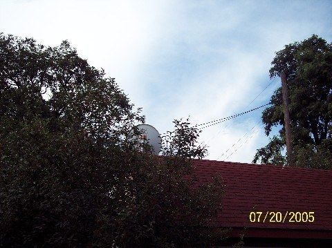

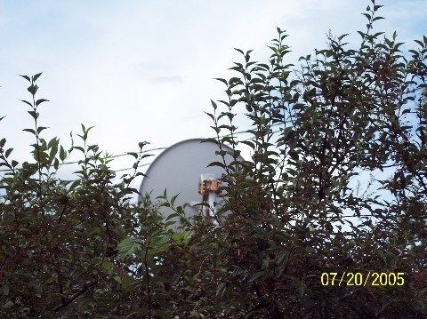

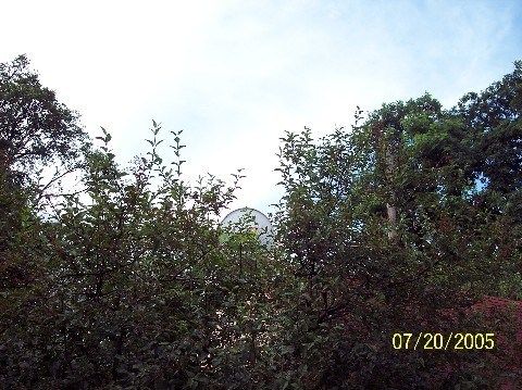

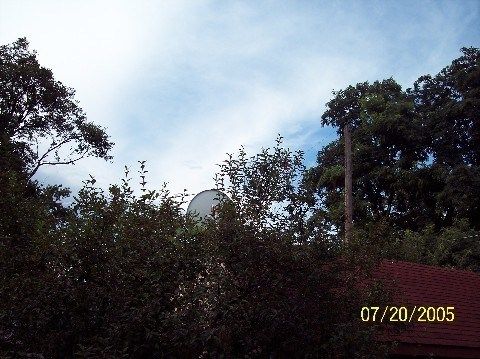

Here are some pictures I took this morning. Unless I don't know how to insert images you will see 4 pictures from different angels. Please note that there is a tree behind the dish and it could get confused with the 2 trees on the sides.
By the way, I hooked my 18" dishnotwork to the Fortec when I first got it and it picked up goltv and another christian evangelist channel in addition to a ton of subscription channels, which I wasn't able to view, obviously :)
I have a sat finder and the signal with the new setup was 1/10 no matter where I pointed the dish, which made me think something was wrong with my cables. I checked the cables and all connections and they seemed to be working find. I mean the connection between the received and the motor is working because I am able to move the dish using the remote.

The sat finder will not work with a universal LNBF. Once I got a standard LNBF, I was able to start dialing in sats almost right away, still took a little bit of patience.
Rick
Rick
My SF-95 works fine with my Universal LNB. :D
I think it just depends on the type of meter.
I have an SF95 meter as well. But It doesn't seem to register any signal. Is better to hook it up to the LNB directly and bypass the motor?
